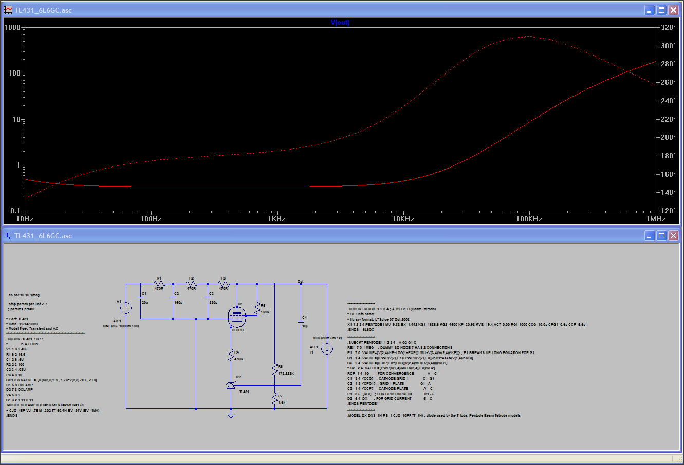

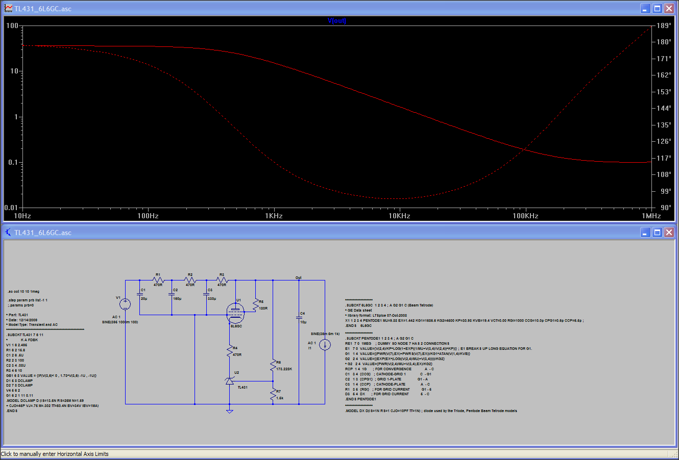

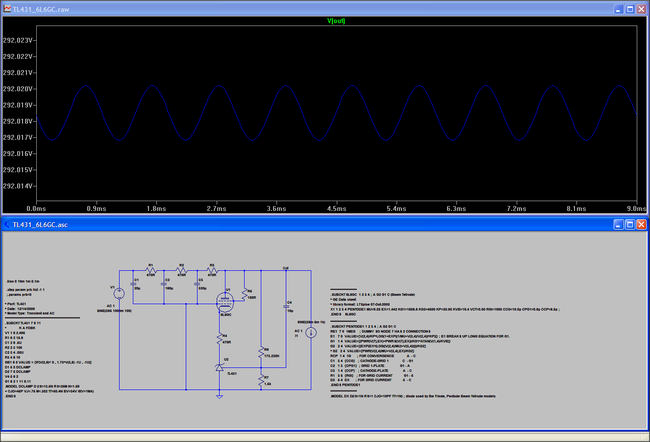

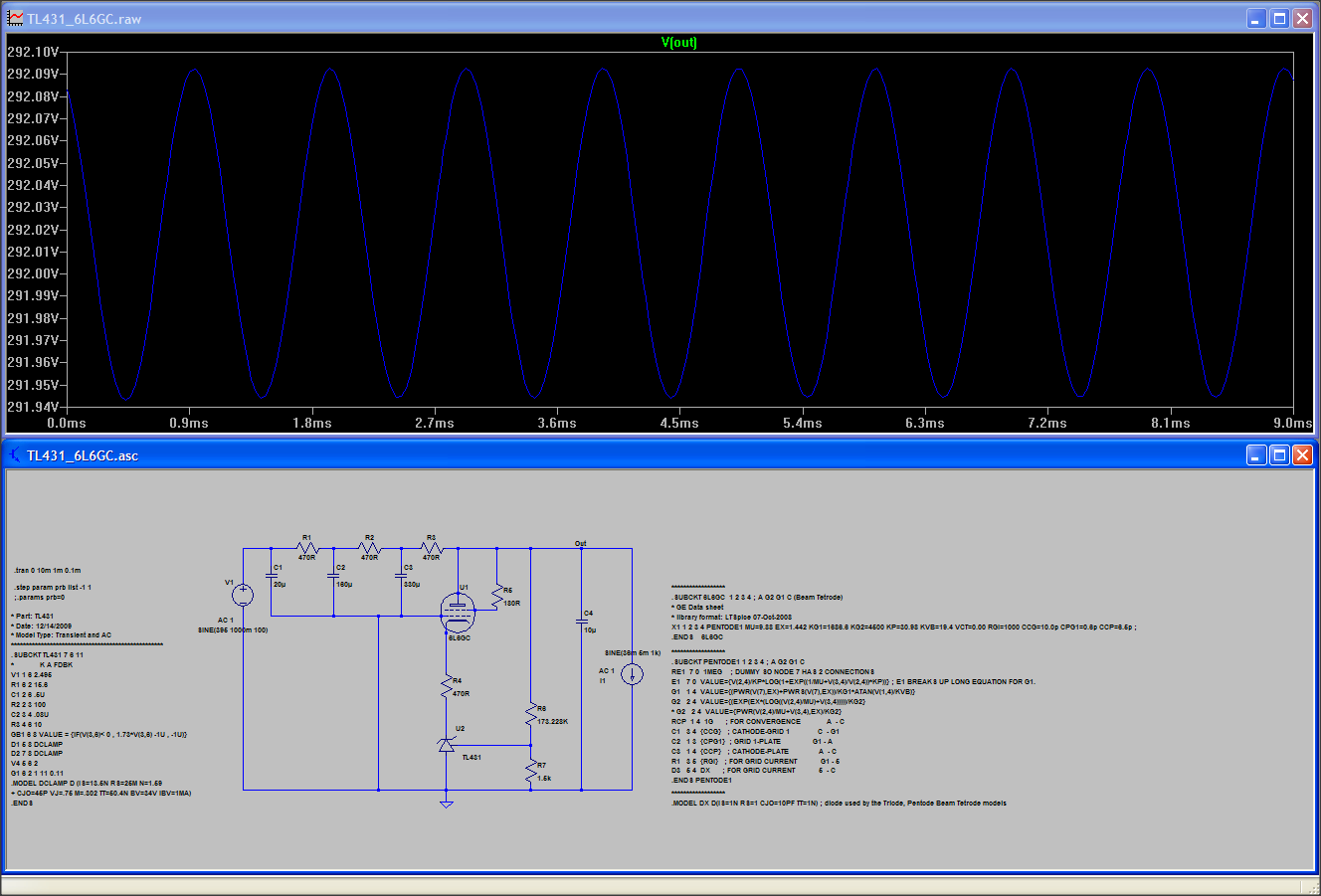

Based on your schematic and data I constructed a sim. Things of notice are:
1. Substantial voltage has to be be dropped across some series ballast to protect the tube cascoded chip for max current. As you did with your RC cells.
2. Ripple eating is so so but it works. Fed 2Vpp 100Hz dc source ripple and 10mApp 1kHz load play in the sim. 140-180mVpp on output. 12.5 times rejection on average (22dB).
3. The output capacitor looks better placed across the high value resistor and trimmer leg for filtering the TL431 ref node. Its a noisy enough chip by itself and that resistor combo is big for Johnson noise. Don't know about stability in that case, it takes much more elaborate modeling and feedback nodes breakage of some full TL431 sub circuit. A practical test would tell much faster. Zo goes higher the opposite way for cap full output shunt or resistor leg shunt, has to do with its bootstrapping the ref or not also. Thus it eats 100Hz ripple stronger due to AC feedback (pic3).

Hi Salas,
Thanks for the update, as it is, didn't hear any instability. Have been using for a week now, seems ok, did change the 10uF across to the resistor and TL431 ref point this morning though, still run as good.
Thanks again.
Keep it coming if there is any more recommendations.
Thanks again.
Was talking about the change mainly, so it proved stable too. Did it make any subjective change?
Didn't notice any changes.
