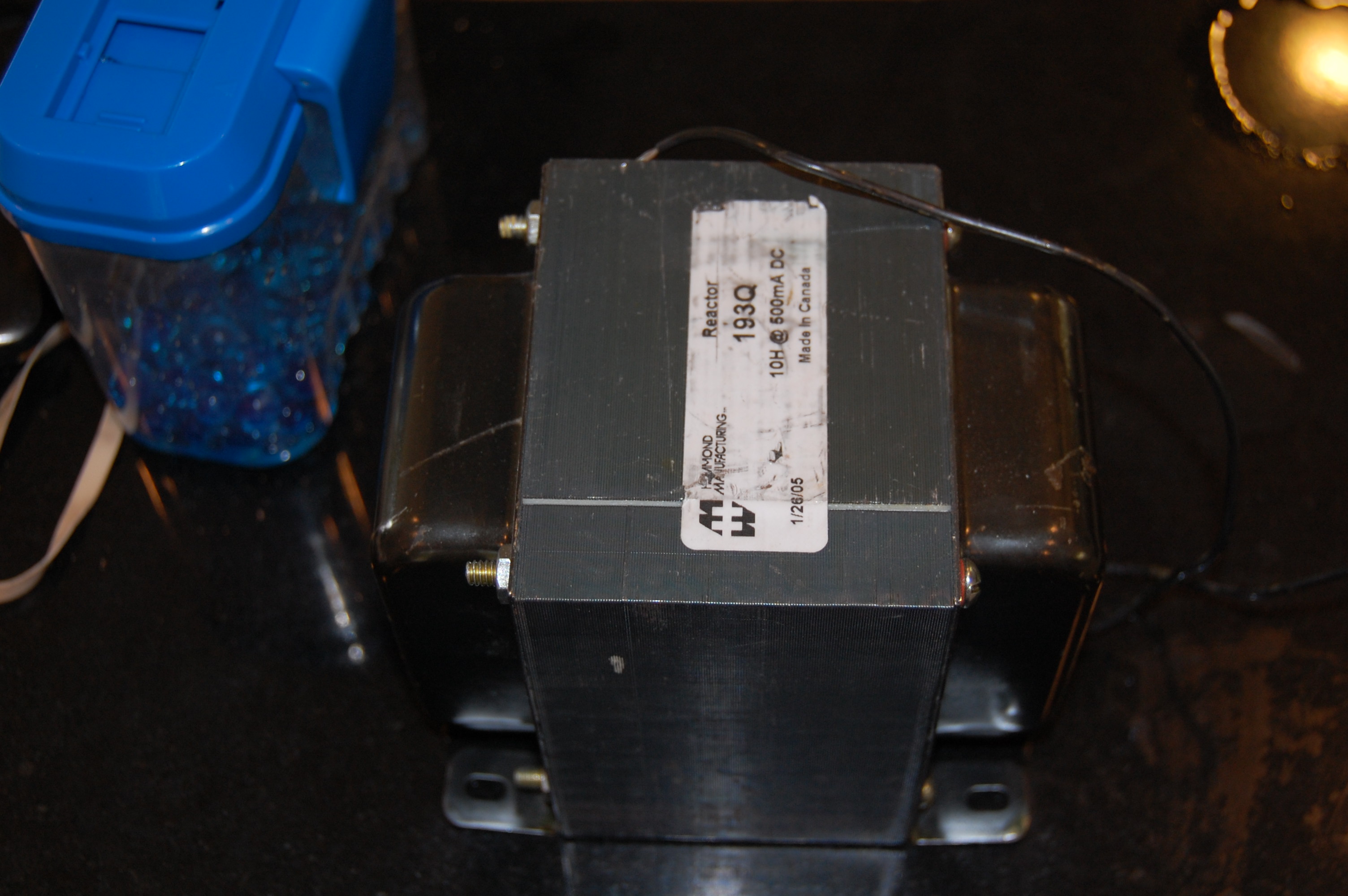

$130 for the pair. Expensive, if just building another amp, but i like this one enough that it will stay. Consider also that the match, and build quality are much higher without any doubt. Obvious that these were the creme of the crop, bein gmiltary version, in a time of the pinnacle of tube making. My brother has always been a NOS guy and i though ti twas just fo rspenin gmoney and bragging, but new tubes cant rouch these things. They plugged perfectl yinto your schematic with no filamen ttweaking or anything else needed. My brother, a long time tub enut, will be dropping by to give a lsiten. He has heard everythin gi have built and i am interested to hea rwhat he has to say about this combo. Your pre adds just th erigh ttouch of bloom and space, fo rlack o fbetter words, to my BA3 power amp. Wonderful combo. Next is finishin gthe new tube psu. Just scored a Hammond 193 Q, 10H and 500mA pooted choke for CLC. Cant wait. I will be tryin gother schemes using new Tungsol(excleent buy an drecommendation, BTW). Perhaps choke loaded and even balanced version. Thanks again Salas!

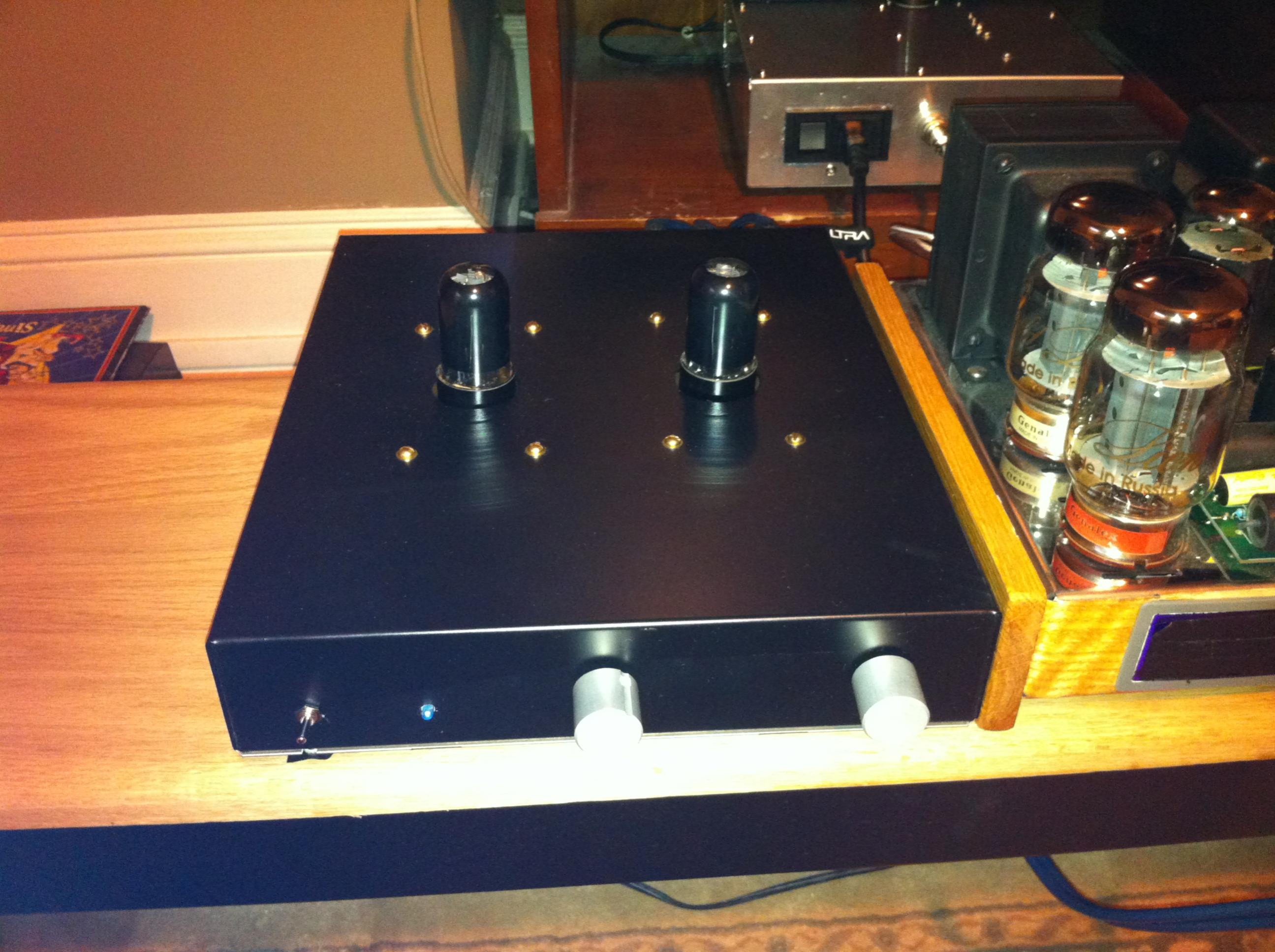

I'm using the Russian 6n6c and I really like the sound. I've got a dozen or so used but good 6V6's (RCA etc.) but these are my favorites so far. I'm driving a Bob Latino ST-120 that I put together a while back. Many many thanks to Salas for this excellent design. I built it as per post one and have probably 50 hours on it. Just keeps sounding better.
Yes sir. Sounds better than it looks. I actually salvaged the PT from a Korean era US Navy receiver. Most everything else (Mundorfs etc.) were as per your design.

Fine, as per total schematic. I see 4 golden screws around each tube also. Are there resiliently hanging boards off of those?
Any changes to bias settings using 6n6c? Any specificruusian brand.
Haven't checked the bias yet. Couldn't really find what these tubes require. Everything is running very cool. I'll check it when I get home and let you know. These are from "the bay". Price was outstanding.
You are correct. The sockets are mounted on separate 3"x5" one sided pcb's. There is a rubber isolation mount on each corner. I also put a bead of hi-temp silicone around the socket mounting hole. I then mounted the socket against this (after it cured).
I'm getting 15.61V and 15.73V on the cathode resistors. This puts it very close to the 6V6's I've had in there. I've got the data sheet for the tubes but it's in Russia. I'll try to translate it and see what the tube actually needs. Readings are with exactly 340V from the HT supply. Btw tubes came in yellow boxes.
Exactly. Tube has OTK 4 with 31 inside a diamond and 11 75 (date code?) on the glass envelope.With some ''RADIO'' like ''ΡΑΔΗΟ'' print?
Had used those too, still in my inventory. But in a USSR civilian marking. Melodic sound, one of my favorites. Some turned noisy after a few weeks from a batch a friend got back then. But the majority continued OK.
Very good! So far I'm very pleased with them but I owe the sound to your simple yet powerful design. Building this has given me pleasure and the confidence to try some other projects. My hat's off to you sir.
