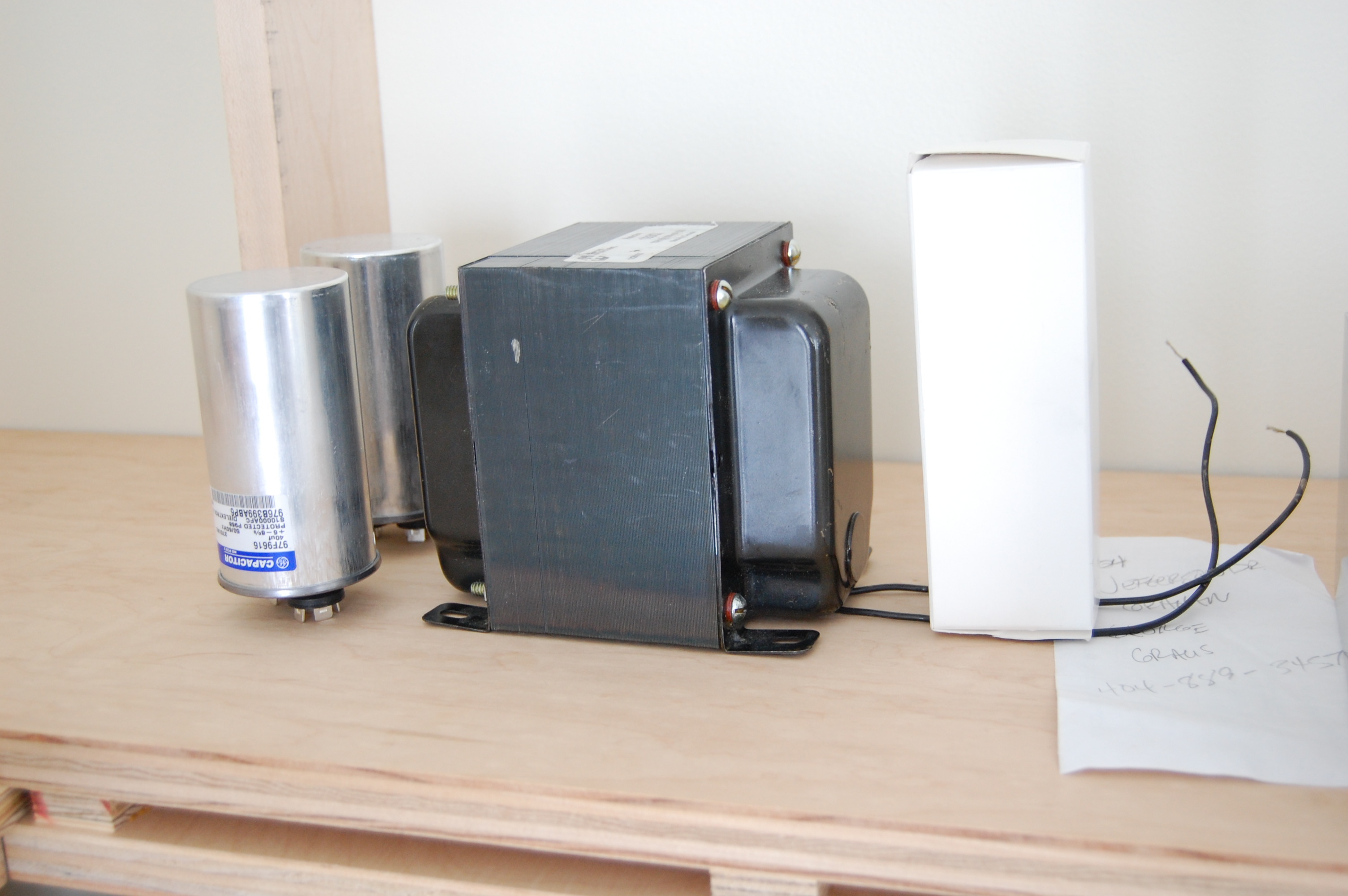

I have read other places that when arranging chokes and caps, you sometimes have to be careful about arrangement. Is the arrangement in the pic OK or will it cause problems between different components. Cjoke will be enclosed in wood boax matching main amp. White box is tube rectifier.

Going t be setting up a little test bed today. I am going to add my new choke and film caps to the PSU, but before making final decision bout tube vs SS rectification, I am going to wire it up with a switch so that I can hear both SS and tube rectifiers going through the new choke and caps. Time for a little AB testing.

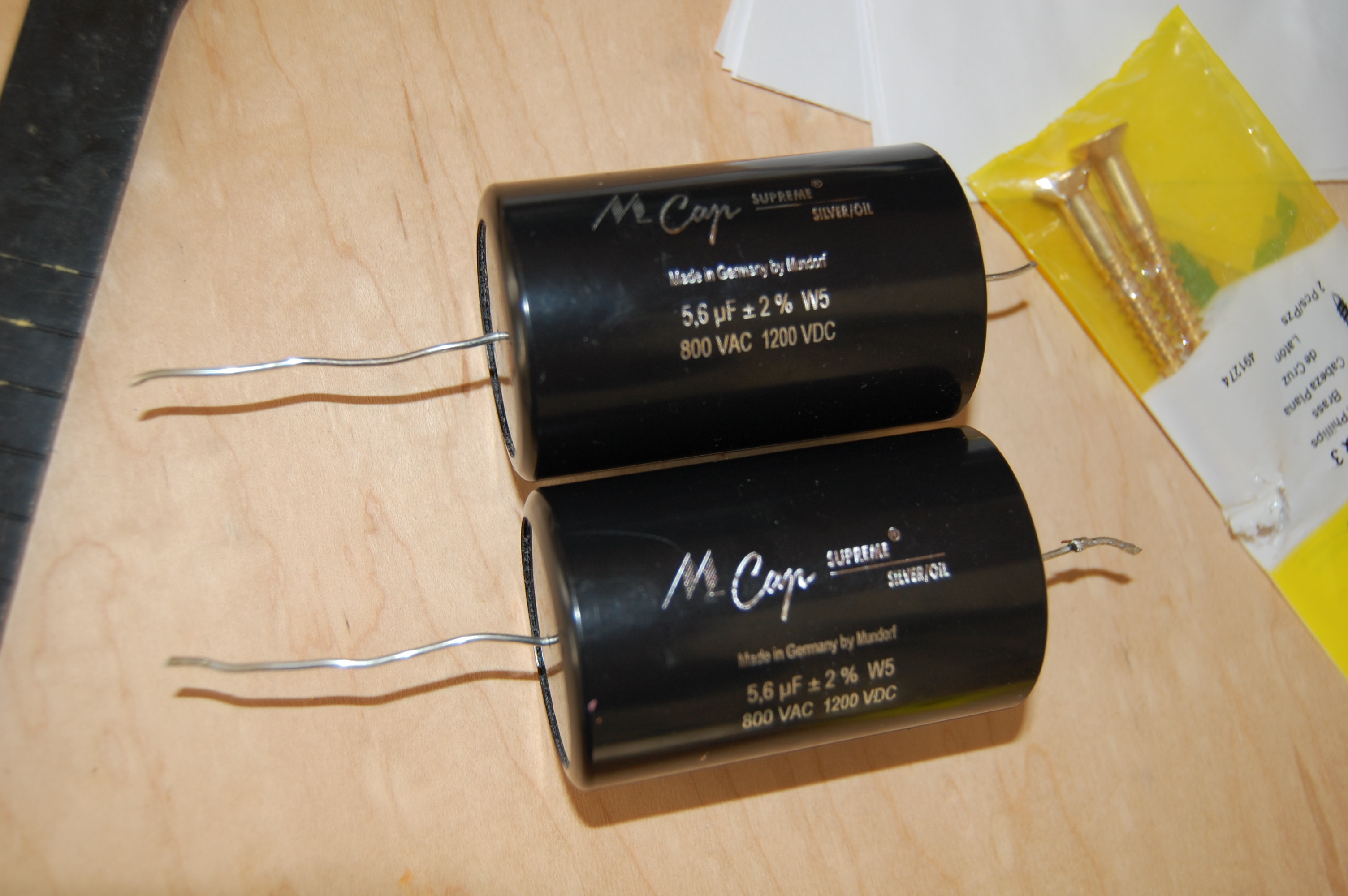

Different result to expect VS the mkp/oil obligatto can. Key is the tonal synergy they will blend to your system. The silver/oil is maybe the most agreeable cap in the Mundorf range amongst users.
Hint. Keep Mundorf oil capacitors in cool places in the chassis. It activates corrosively if heated up, not durable for heat like American PIOS of the tube era.
They will be o the signal side of the amp, away from the heat. After pulling the prefilter from the main amp, I will be able to push the SSHV2 all the way to the other side and put it on even bigger sink. Question, my NOS RCA's balance perfectly a 6.3V using your filament supply. Should i drop this some or leave as is. THese things are known for their toughness, just making sure.
There is argument that running heaters down to 6.1V helps extending life span without much degradation in transconductance but I haven't made experiments to see if the THD suffers a bit or not.

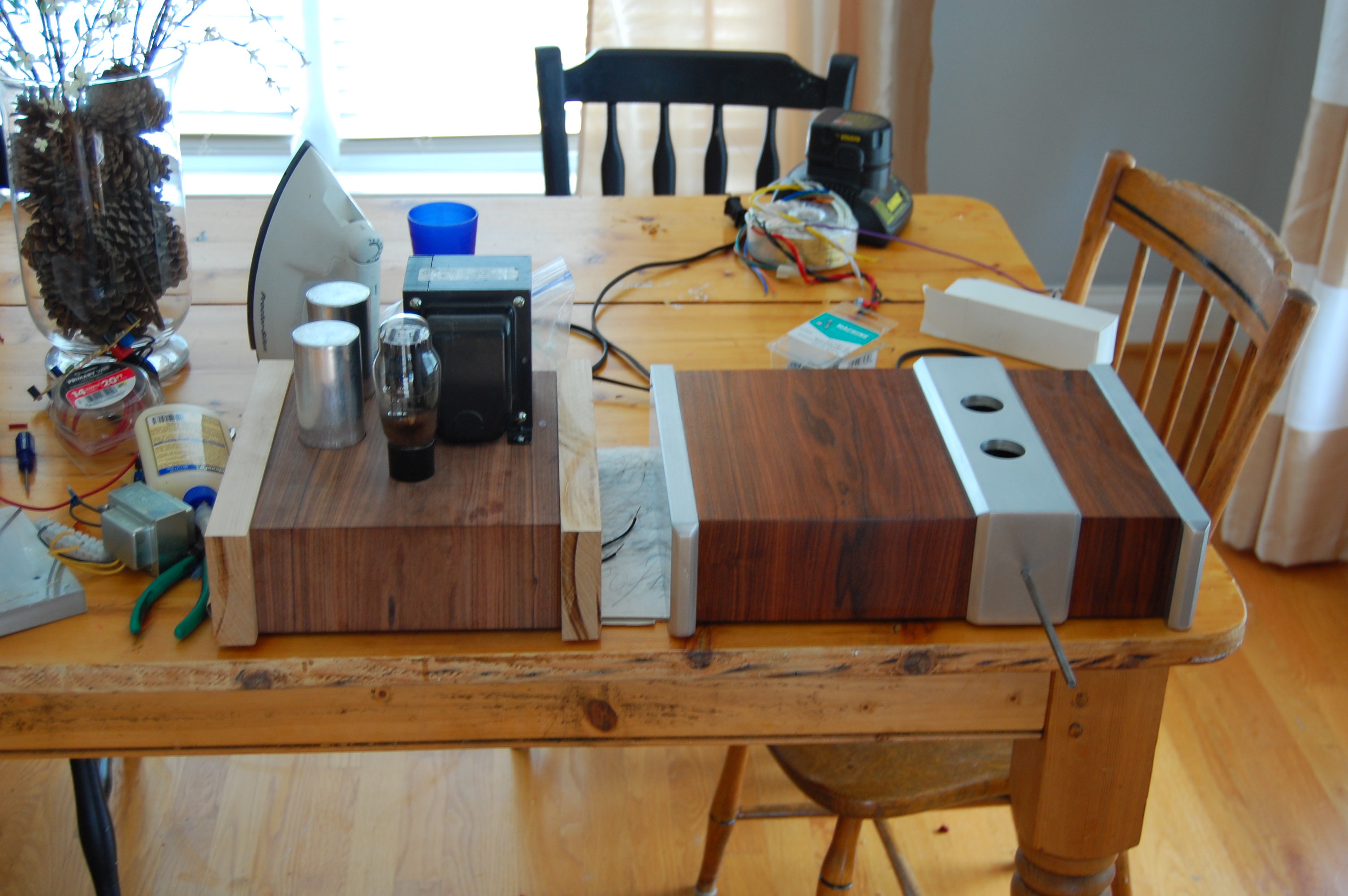

Soon to be matching PSU. Will have s switch alllowingme to switch from SS ro Tube rectification. Was going to do AB testing as stated, but figured if i could leave it in without detriment, why not. Sides will be aluminum matching main pre of course, and choke will be put in aluminum box. Will not get it finished tonight to listen, oh well.

Make sure you check the values of your Mundorf caps.
I wired 4 into an PP amp for a friend; i always checked the values, before i wired them in . .56 caps varied from .37 to .56.
imagine what a .37 and .56 would sound like in a push pull amp.
Not the best for a cap that costs so much?
