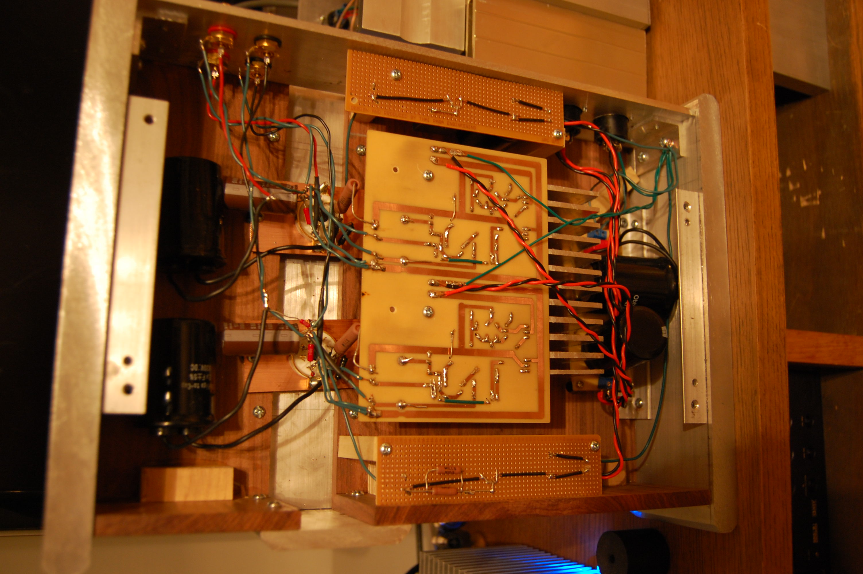

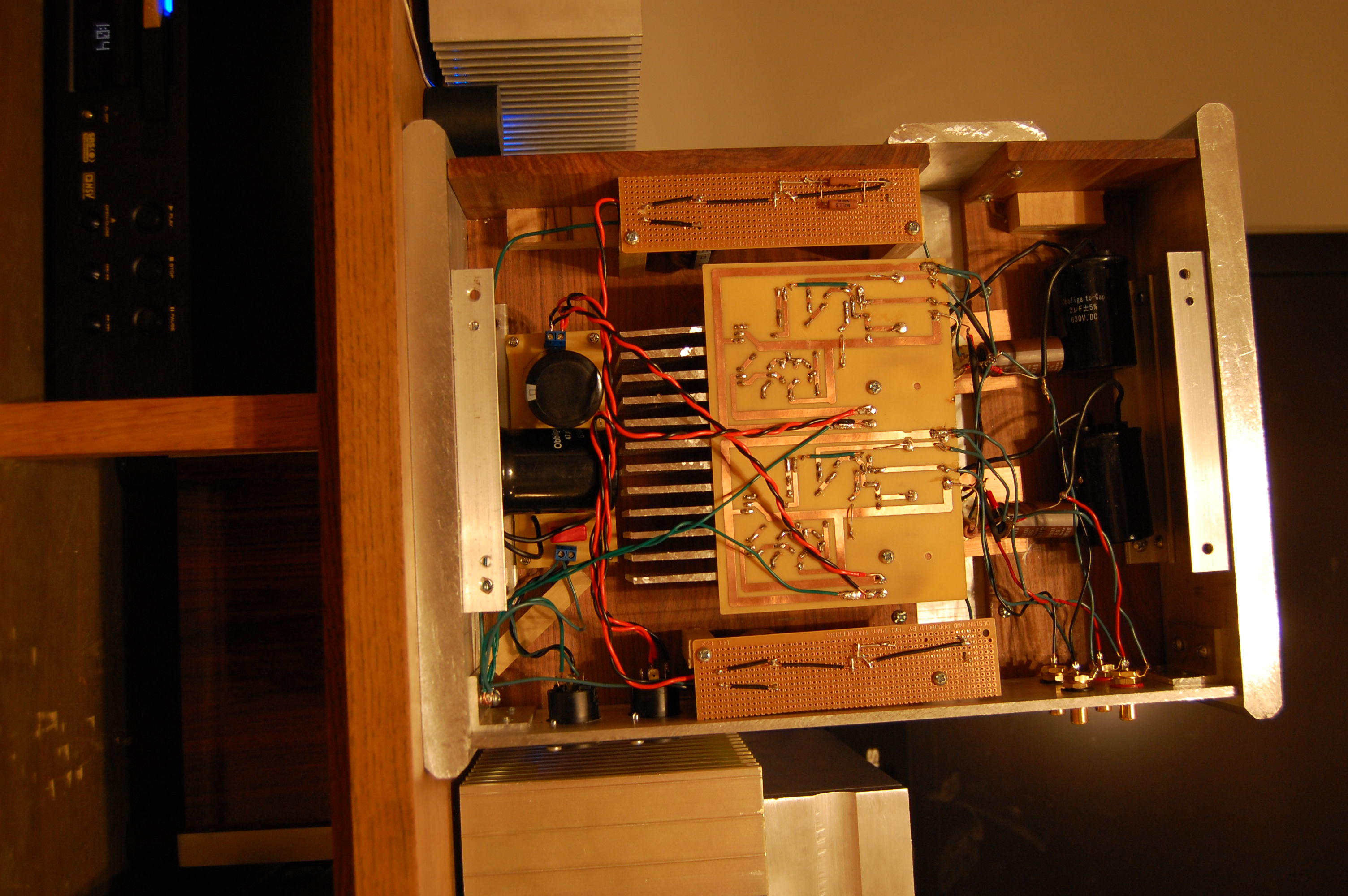

Ithink i have found it. Pin 5 is getting the signal,but thats the last of it. I think it is solder connection between pin 3 and output cap. Ill post pics soon.

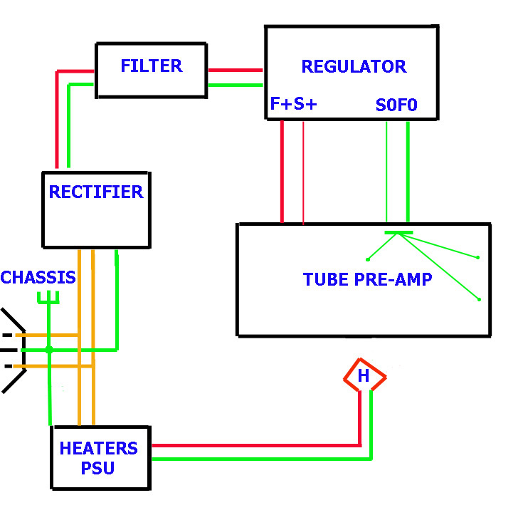

Here ya go. My next guess is grounding scheme. I have each PSU connected to earth seperately and all signal grounds, plus filament ground starred at regulator output.
Try a simple one like this first. Connect signal grounds also to the shown pre-amp star.
*Do I see the plate load resistor directly on +force and then the +sense wire going elsewhere in your pic? It will not do. 2 wire pairs go to 2 defined B+ and GND points. No more on the regulator outputs is allowed.
Mine is connected this way with the exceptionthat filament ground is attached to sense. I will route it to psu grounds like your pic. Sense wires are both connected to same place as force. Signal grounds are connected as you have them drawn. I will rework signal wiring before work.
Thats where one screw up is. I have B+ connected above Rl and S+ connected below Rl. Found it while rerouting grounds. Unfortunnately i zapped a filament this morning, so i will have to get some more tubes. Lets hope the one channel works. I am changing my avatar to Muddy Waters.... because thats what i do to a thread.
Bingo! Sense transistor was stealing my signal. I have to readjust B+ and install new tubes and we should be ready to go.Thank you for entertaining a fool for so long. Ight as well get a tube rectifier while i am at it. Can i put all the pre filter with seperate psu enclosure. I noticed Gregpry did this. Got shielded AC cable bringimg in both rails currently. Could put small decoupling cap in main box.

Made music at lunch. Problem was cut gate resistor on bottom BJT that came from changing it out. Making music, but distorted and definetly not amplified any. Will check input resistors as well as other connections. Acting almost like a buffer.
