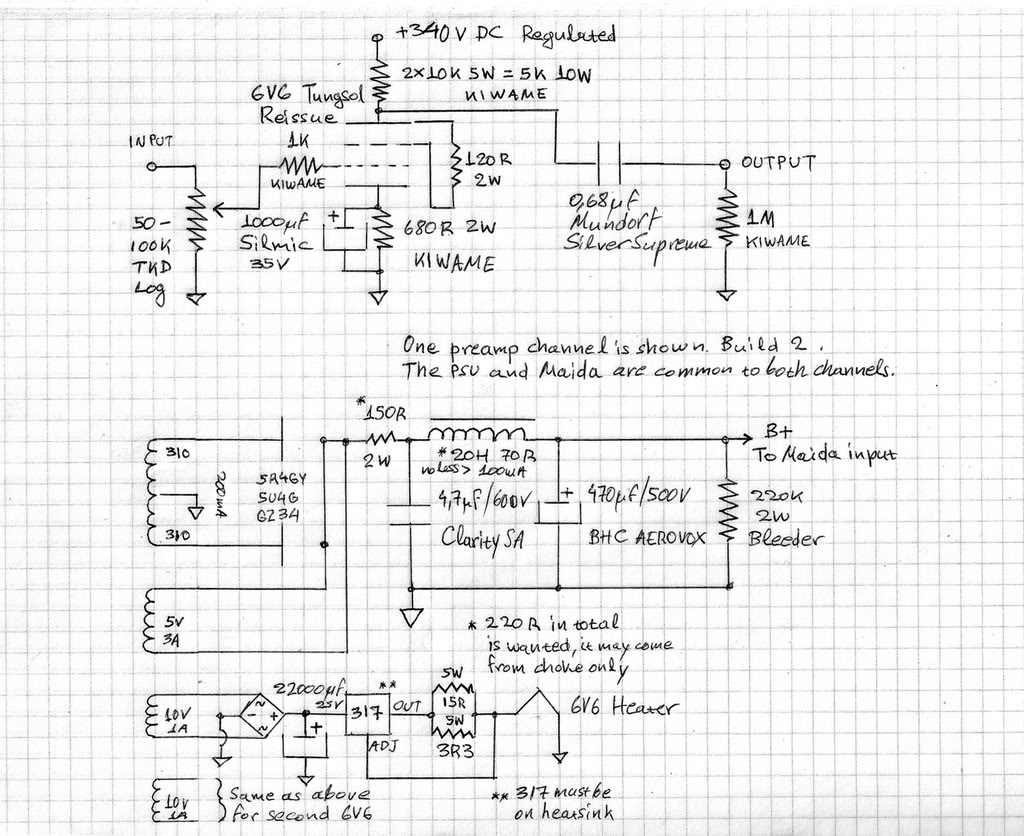

Salas, just curious how do you calculate the resistor value of 2R7 between the LM317 & the filaments?

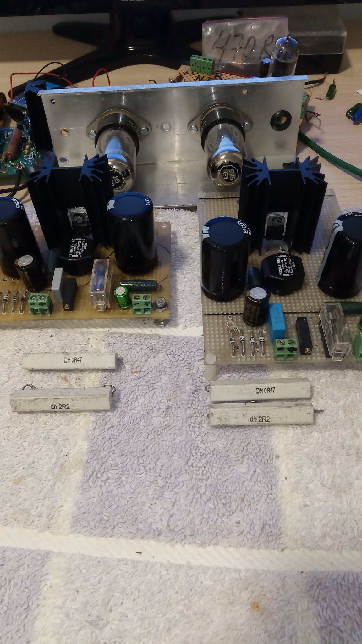

Experimenting with 5W parallel resistors is also practical. Connect heater when with a likely combination and see what Vh voltage the LM317 & setting resistors achieve on the actual tube brand and vintage. After a minute it will be fully lit.

Voltage source mode heater PSU as you already got has the characteristics of coming up instantly and maintaining fixed voltage to all tubes if you roll a lot.
CCS mode is minimalist, occupies less space, comes up soft. But various tubes can develop different Vh. Depends on exactly made filament for nominal spec current. You are happy if within 6.1V-6.5V range. Else you tweak Rset.
