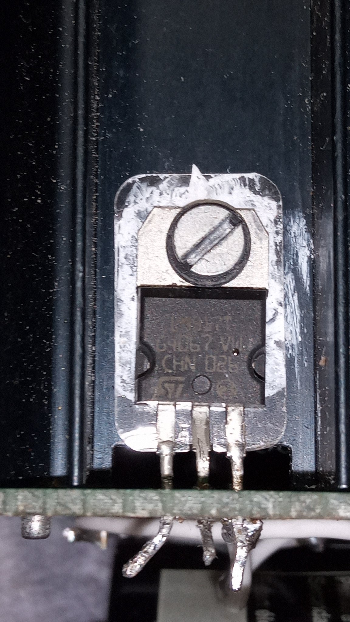

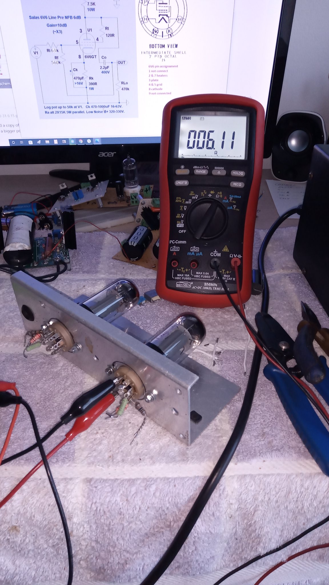

Across the setting resistor(s) there must be about 1.25V for LM317.More than 1 minute warm up. Resistor + rheostat set to max. 6R11. Across res+pot measures 2.7V = 442mA it seems not enough.
7.56V at filaments & 1.72V across 3R3 = 521mATry 3.3Ω resistor alone (between adj-out pins)
1.72V is way out of LM317 Vref spec and tolerance. It either gets too hot or its a fake sample. Is it on a sink?
Replace it. Vref in a reg chip is an essential function. Must be close to nominal and steady. Can't be far away from 1.25V or changing with different resistors.
When you measure directly on adj and output pins what gives? If around 1.25V the chip is good so review the connection points of the experiment for error.
