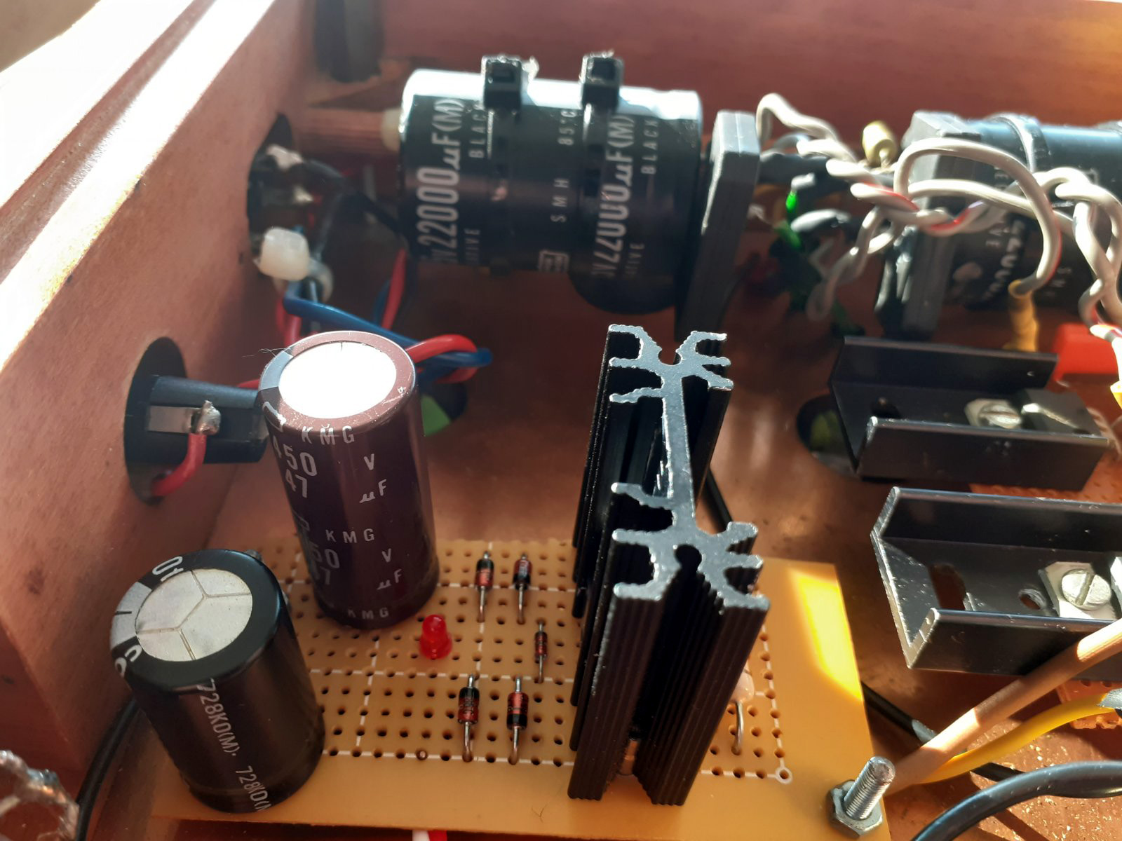

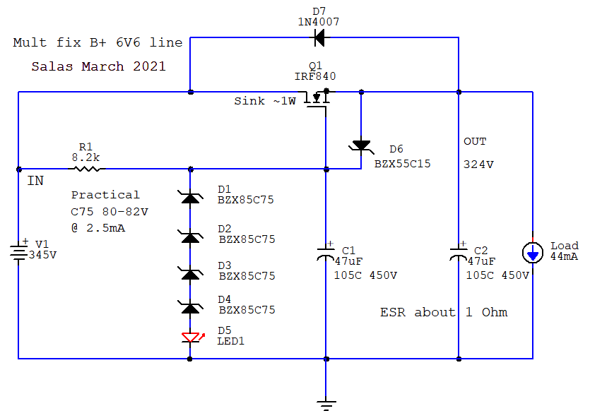

For the time being I would also like to contribute a simple capacitance multiplier alternative to the Maida B+ reg. The protoboard Mosfet Maida in the original build finally showed erratic reliability problems after many years of service. So I replaced it with this quick one to make and it worked well.
Hiss is as good as before. Ripple rejection few dB worse, but not audibly detrimental. In the cathode follower version at least. Sound is still very musical, maybe even more than before. Q1 Mosfet's dissipation is mild in this application, requiring just a small sink.
Enough builders opted for the much later introduced SSHV2 shunt reg than the initial Maida recommendation. Shunt is a whole different animal and effort. Too large for my original chassis.
I use something similar to that PSU for several builds but with IRF820, works great!

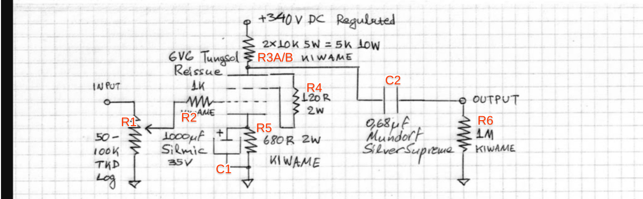

This is the schematic I will go off of from this post, and will design for the listed parts with a bit of leeway to fit alternative components. I think for the anode load 30-35mm lead spacing for parallel 5w resistors should accommodate most of the parts likely to be used, and for the other resistors I'll try to size for 1~2 watt or larger footprints to use kiwame and similar sized parts, as they are 12 or 24mm lead spacing.Cathode bypass cap assuming a 35 volt Elna Silmic will be 5mm lead spacing for radial footprint parts. Still not sure how best to fit footprints for output capacitors. A 1200 volt .68uF Mundorf is 21x41mm, so maybe 50mm lead spacing with some additional pads inline for smaller caps to also fit?
At this time I will focus on just the preamplifier signal circuitry, PSU will be offboard, unless you guys want the filament regulator to be included, assuming it will fit? As shown it's a CCS configuration, and Voltage regulator would also work well. I personally like all my power supplies on separate boards, so looking forward to hear what everyone wants to do. I'm likely to run AC heaters directly to the sockets personally, but I know lots of folks prefer DC in a preamplifier.
Awesome. I’m good with ac fili’s. Everything you’ve described is cool.This is the schematic I will go off of from this post, and will design for the listed parts with a bit of leeway to fit alternative components. I think for the anode load 30-35mm lead spacing for parallel 5w resistors should accommodate most of the parts likely to be used, and for the other resistors I'll try to size for 1~2 watt or larger footprints to use kiwame and similar sized parts, as they are 12 or 24mm lead spacing.Cathode bypass cap assuming a 35 volt Elna Silmic will be 5mm lead spacing for radial footprint parts. Still not sure how best to fit footprints for output capacitors. A 1200 volt .68uF Mundorf is 21x41mm, so maybe 50mm lead spacing with some additional pads inline for smaller caps to also fit?

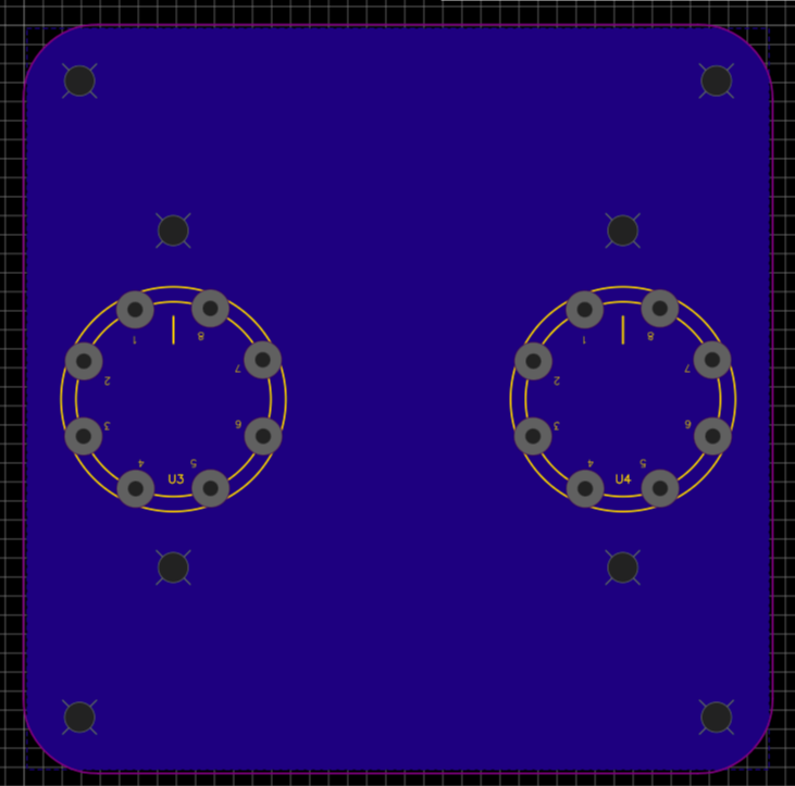

Initial layout of sockets, 4mm mounting holes, it'll have a ground plane with large clearances between traces and copper pour. Nice wide traces is the plan. I went ahead and put corner mounting holes as well as one on either side of the sockets. Does 4mm sound like enough? I think I usually see M3 holes on most other gear.
I figure a resistor between plate and screen will be a good idea, so maybe that works? I'll do the initial layout based off of the schematic posted by Salas, and then I'll add extra pads here and there as could be useful. I like PCBs with extra pads for experimenting anyway. You could even use this PCB for an SE output stage if you wired a transformer in instead of the load resistors 🙂

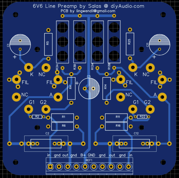

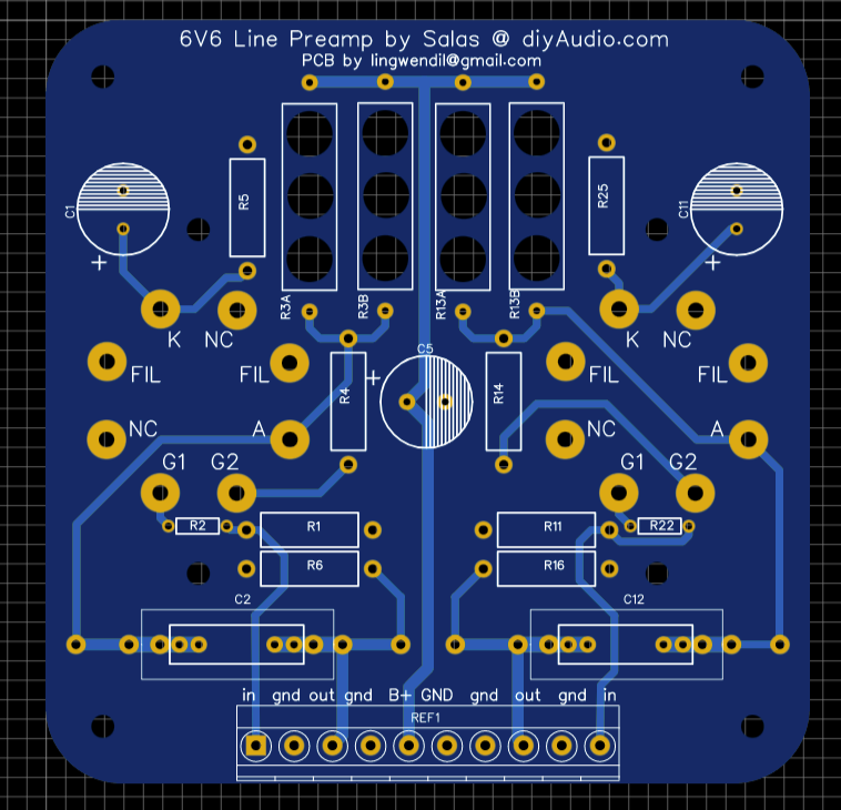

Current state of board, still scooting things around. I had to add my own labels for the parts, so as of right now all the left channel is R1, R2, C1, etc, and the right channel is R11, R12, C11 etc. I made the grid stoppers (R2, R22) smaller footprint so that they will be more effective using physically smaller parts right up to the socket pin. Capacitor footprint spacing will allow 10mm, 15mm box types, all the way up to 45mm spacing for larger "audio" type axial caps. I still have to add some holes near the filament pins.
This is the schematic I'm using, with the added labels of the parts as they sit on the board. I added C3 as a power reservoir cap on the board, and I've replaced the volume pot with a fixed resistor on the board, which of course can be left off if desired- but I highly recommend running a resistor here, even with a pot. Make it 6-10 times larger.
Hopefully nobody has issue with either addition, as they will be useful for beginners and different configurations, and can be left off if not needed.
I also added the pads for filament wiring both under and next to the socket, so that multiple wiring configurations can be done, series, parallel, independent, etc.
All medium resistors are 16.5mm lead spacing, which will accommodate 1 and 2 watt kiwame or similar, and the anode resistors are 30mm lead spacing, to accommodate most 5w or larger resistors (and the listed kiwames) with holes underneath for airflow.
