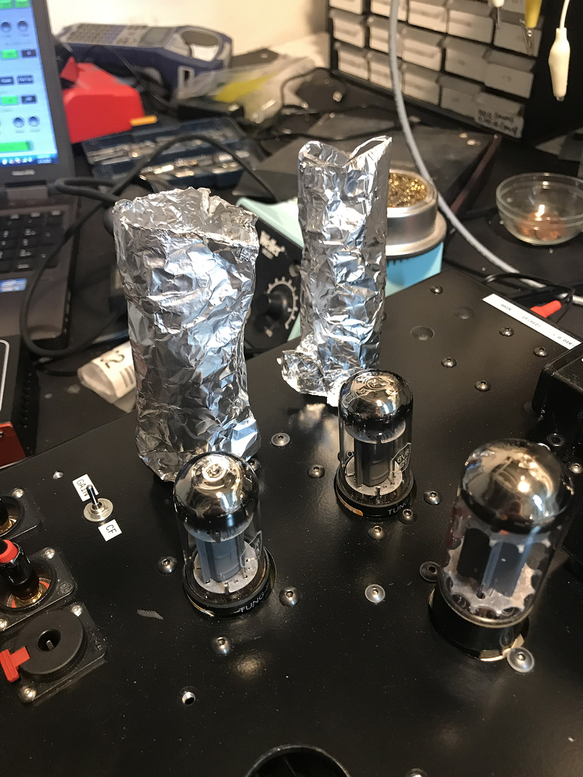

I never considered myself a tweaker, but these little gremlins have driven me to the edge. And I think I finally beat them!
Decided to go DC, using just available parts I had on hand. Rigged up a raw DC through some schottkeys. I had about 500mv of ripple that looked like a buzzsaw. Not so great. But I collect odd power electronics modules, and had these Vicor Ripple Attenuators that I've been dying to use on something. Well, the time was now. Got the ripple down to 5mv and running 6.25V to the heaters. And the gain stage is now QUIET QUIET QUIET.
And it sounds effing awesome. Still waiting for proper tube shields on order, so had to do with aluminum foil for now lol.
Anyway, I gained a full 10db of SNR, and totally obliterated that 120Hz peak (see attached measurements).
DONE!
Take that gremlins and wifi router!
Left AC on the CF stage heaters, cause it was quiet anyway and I liked it. But now both stages sound as they should.

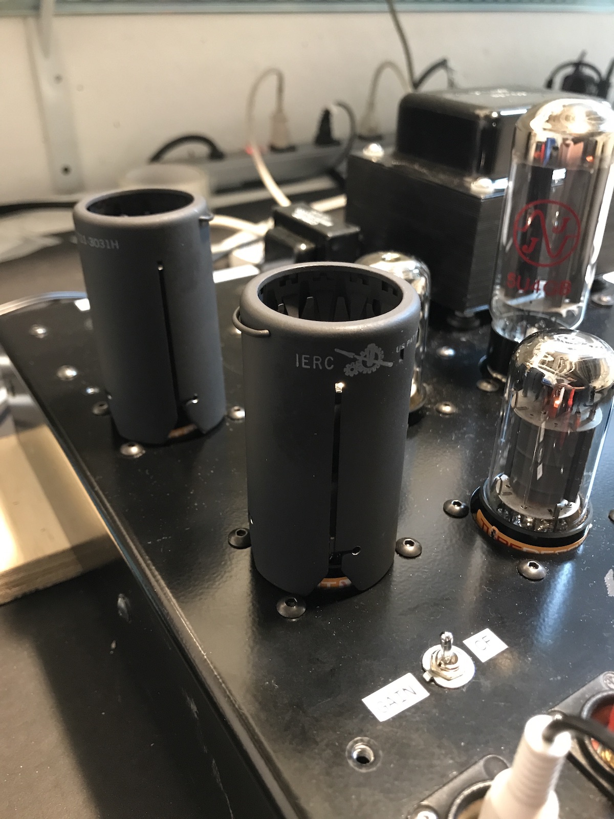

But here is the gain version with the heat sinks I bought on ebay which acts as shields. Btw, this is in a commercial building in NYC, with fluorescent lights above me audibly buzzing, and wifi router on and 2m away. so I think this is the max quiet I can get. This time I'm really done! Thanks to all.
Not bad at all for 15dB gain. Those shields look nice in black. Do they press enough on the tubes helping with microphonics too?
Look at the inside near the top of the closest shield.
You can see the top fingers of the springs that hug the tubes.
And since the shield cuts off the air from cooling the tube, the finger-stock helps to carry away the heat to the shield.
Flat Black is a good heat radiator.
Because they hug the tube, you do not even need the special sockets that hang onto the shield.

The tung-sols don't quite fill out the inside. They're pretty lose, but inside the sink are these springy teeth. So I think having just one side in contact with that probably cuts down on at least some of the microphony
