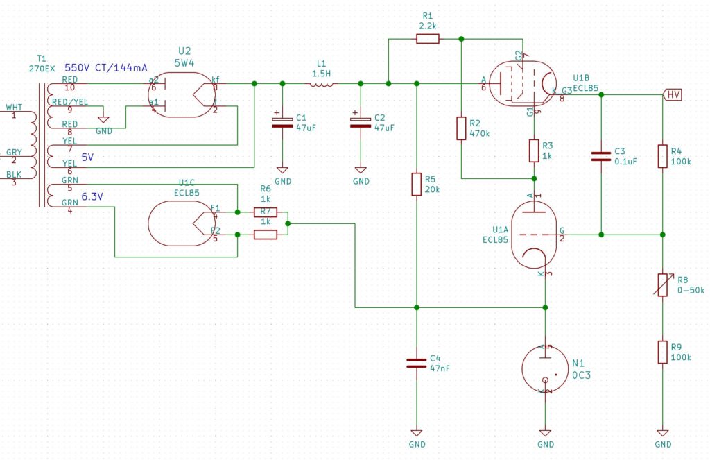

Well I'm well along fabricating my chassis for this exciting project, all the parts are kitted up, etc. I want to use a tube regulator. I believe others have used this old Gary Kaufman schematic with 0C3 reference and 6GV8 for the pass and error detector. I'll be using dual UF4007 diode bridges full dual mono regulators from a torroid with dual secondaries. Is this plan feasible for someone wanting to go "old school" instead of a modern maida regulator? I'll be using big MRC polypropylene in vegetable oil caps for all smoothing stages and decoupler, the only electrolytic will be the first reservoir at 450uf. Will I be ok you think?

I want to use a tube regulator. I believe others have used this old Gary Kaufman schematic with 0C3 reference and 6GV8 for the pass and error detector. I'll be using dual UF4007 diode bridges full dual mono regulators from a toroid with dual secondaries. Is this plan feasible for someone wanting to go "old school" instead of a modern maida regulator? I'll be using big MRC polypropylene in vegetable oil caps for all smoothing stages and decoupler, the only electrolytic will be the first reservoir at 450uf. Will I be ok you think?
OK like in working alright? Green light there. The PSRR of this 6V6 circuit is lowish so anything obvious on the PSU rails will be noticed. The penthode pass element gives rather high output impedance compared to what is possible with solid state. Do not let this withhold you from trying as most SS regulators are not ideal either because they bring a certain sound with them. If you want something high spec look at the work of Jan Didden (among others).

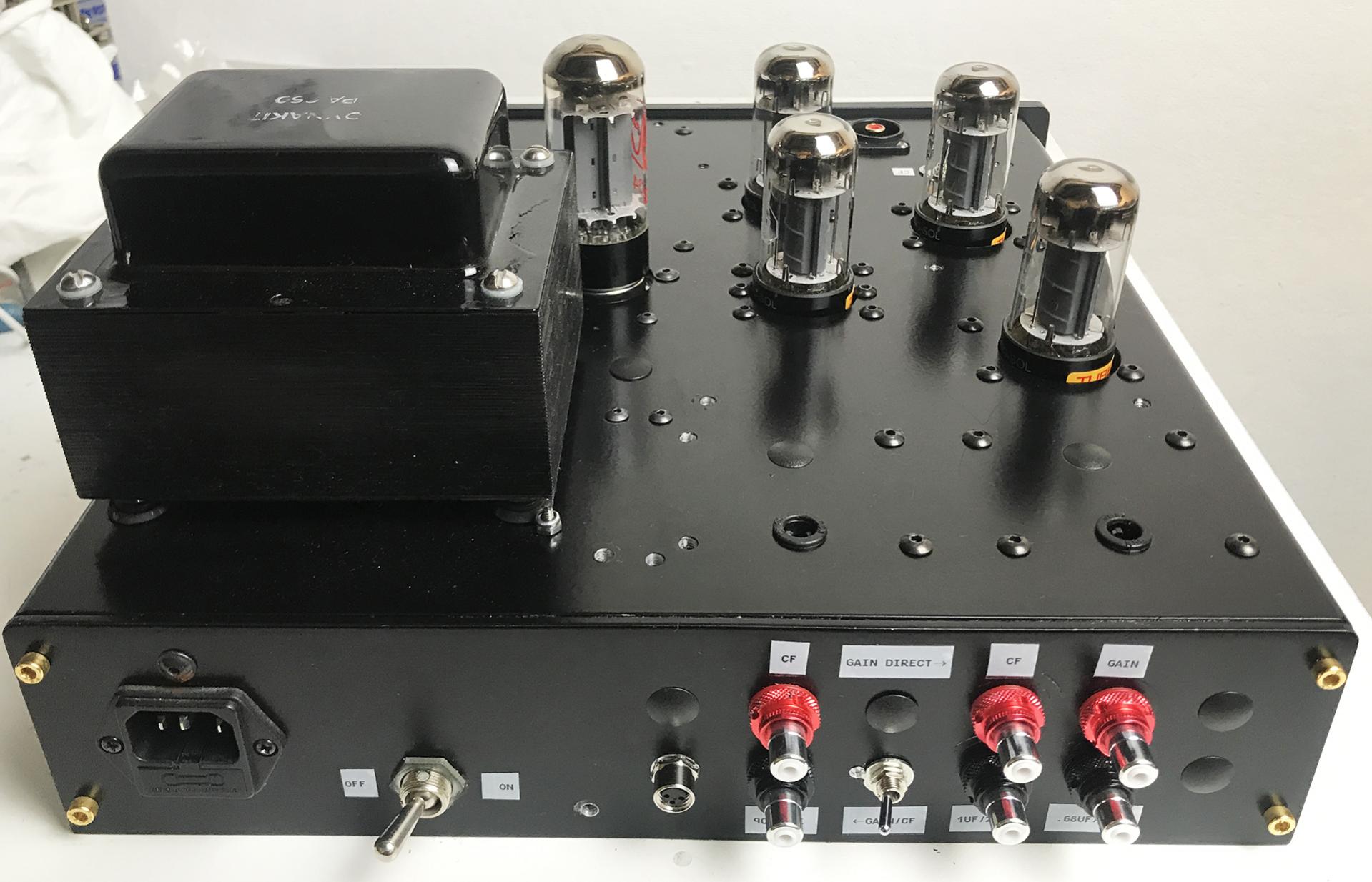

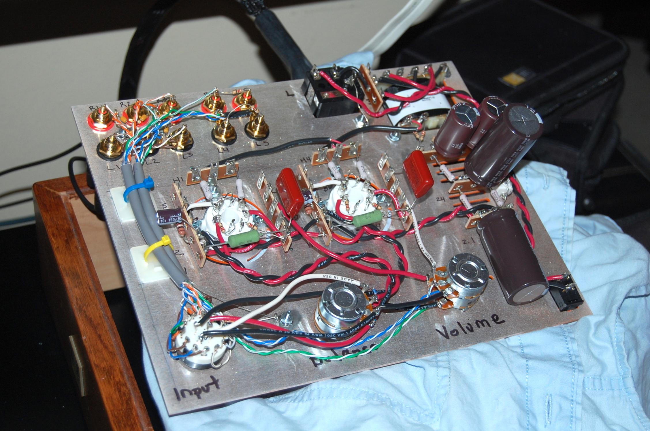

Some more updates

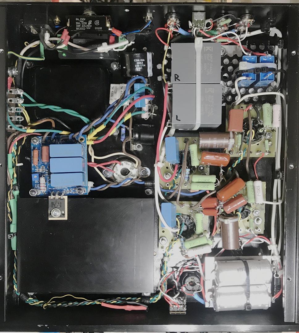

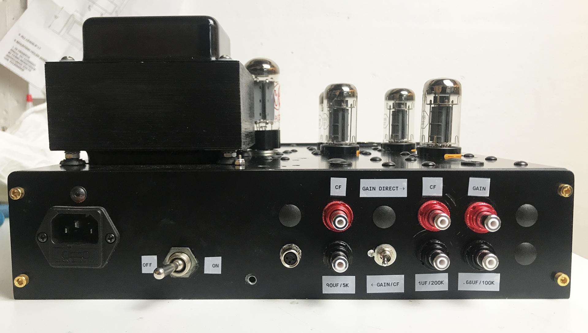

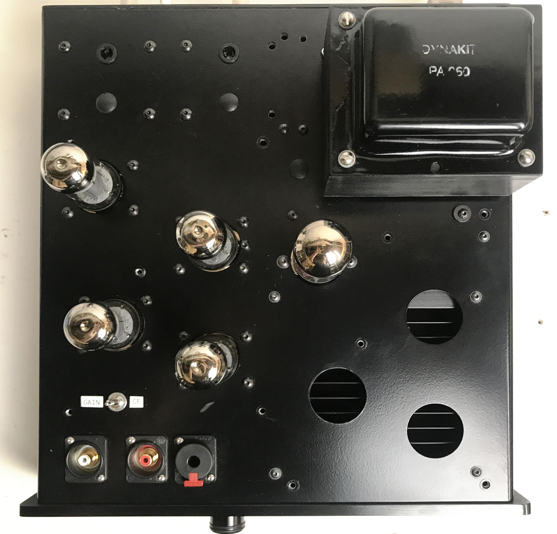

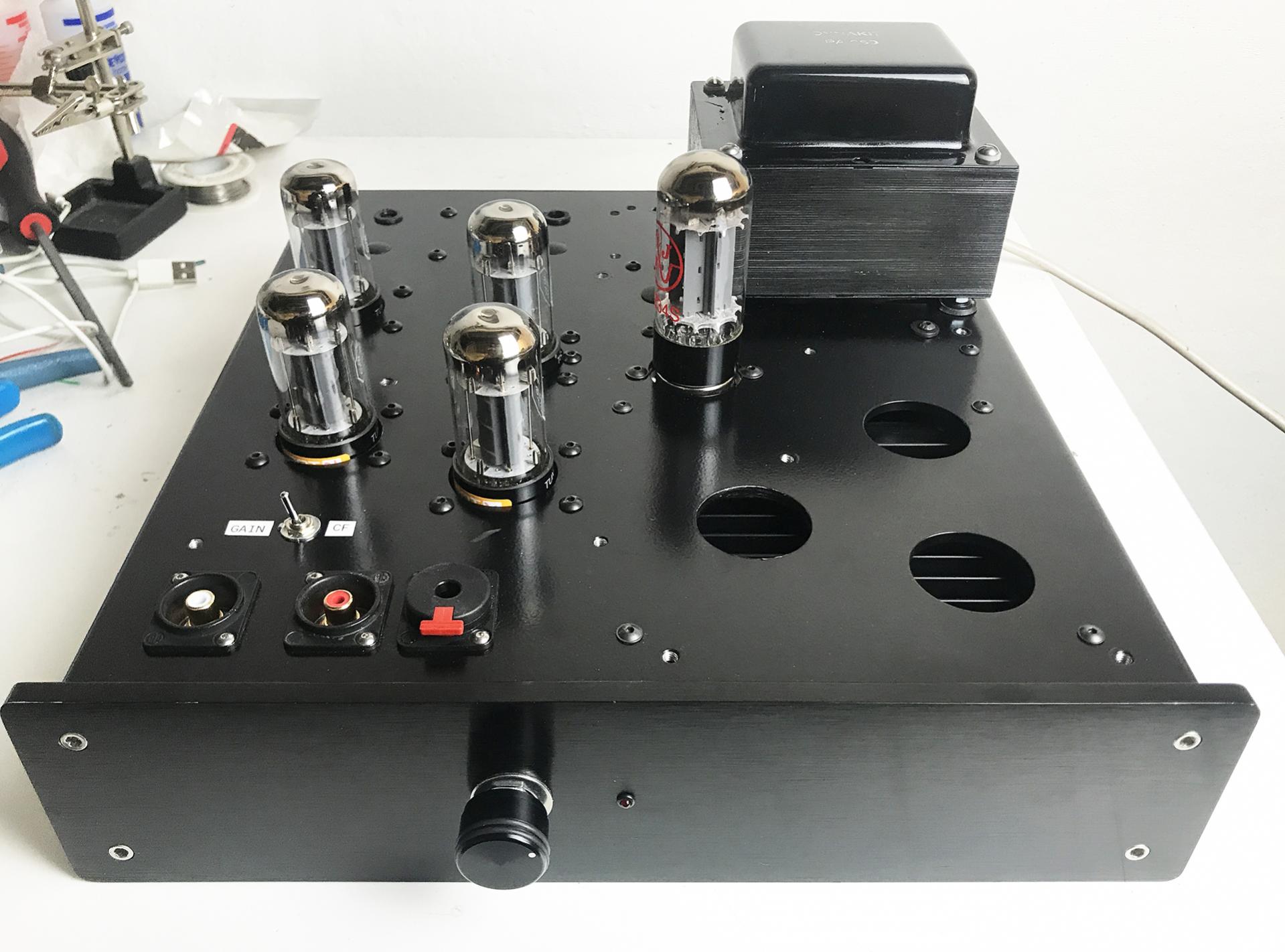

Nearing closer. I think I'm done actually, although I might have some questions in the coming days....Maybe later I rework the heaters to DC.
But listening the last few hours, I have to say this makes a very fine headphone amp for hiZ headphones. Sounds utterly fantastic. Not even a hint of hum, hiss or any noise of any kind to my ears. Really, it sounds wonderful.
Hooking up to an amp and speakers, in CF mode also sounds amazing. Big beautiful sound. No hiss. I can hear a bit of hum hear pressed up to speakers.
In gain mode though, I do hear a fair amount of noise going direct to amp and speakers. Some HF hiss, and quite a bit more hum. In addition to hum, there is a bit of very low volume pulsing. I really have to listen closely, but it's there. I'm making it sound worse than it is- still quite tolerable. Sounds, timbre, tone and everything still sounds excellent, it's just not totally quiet in gain mode. I might poke around in the coming days, but really this preamp and HP amp sounds really incredible across the board. Thank you Salas for your kind support of this thread for 14 years!

Looks like the night fighter version of 6V6 preamp builds. Very imposing. Congrats.
In gain mode handpicked low microphony tubes matter, elastic mounting also. Another way is to drop some non needed gain, first by not using the cathode bypass cap, or by going down even further with use of NFB schemes.
