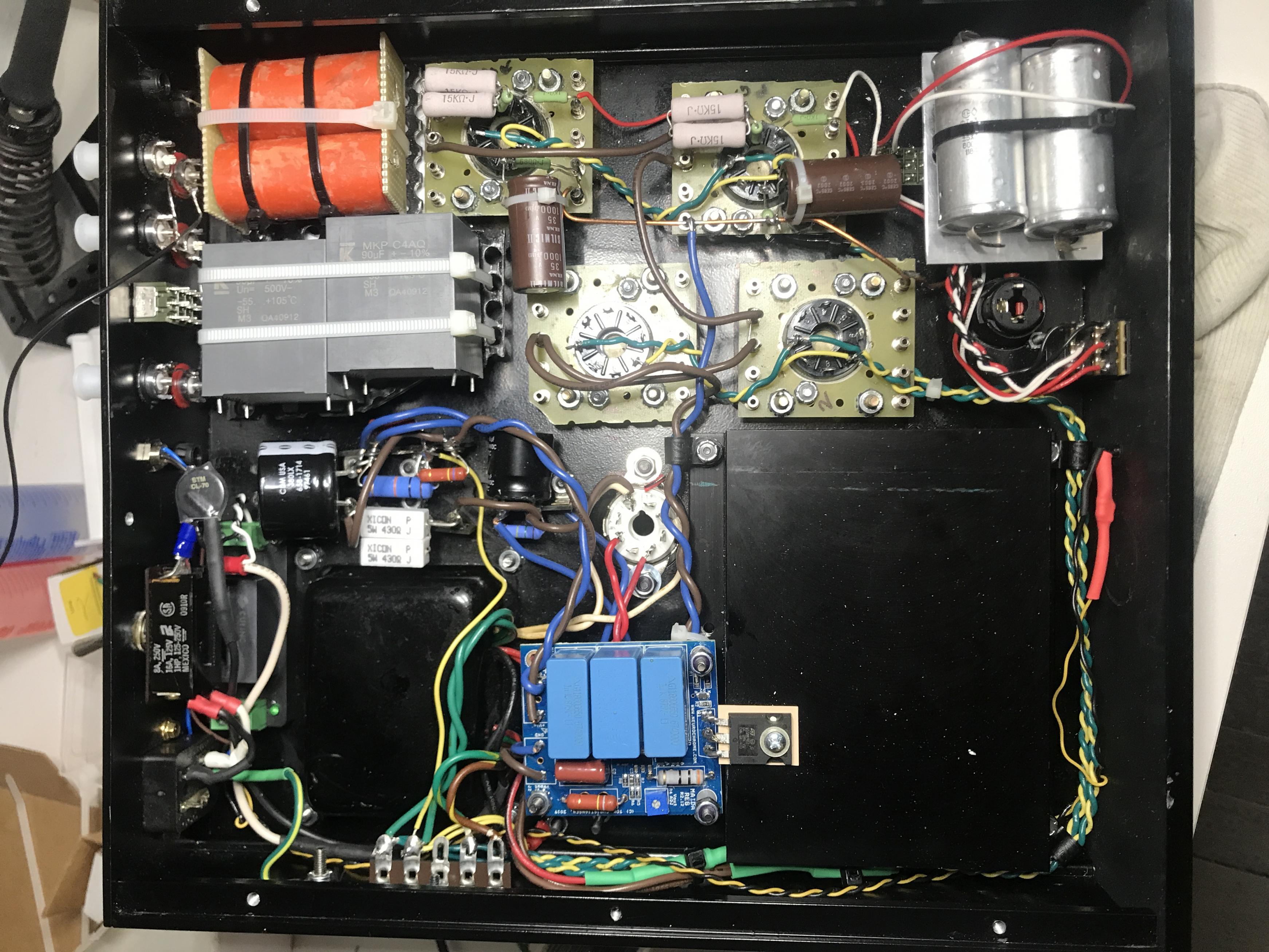

So, I'm making some progress on the deluxe 6v6 preamp. See post.
This is my first non-circuit board amp. Quite a challenge. I'm running out of room!
Got the gain stage mostly wired up. Will test soon

Looks very good to me for a first free wiring effort. I am much less patient and I usually created a spaghetti 😀
Thanks!

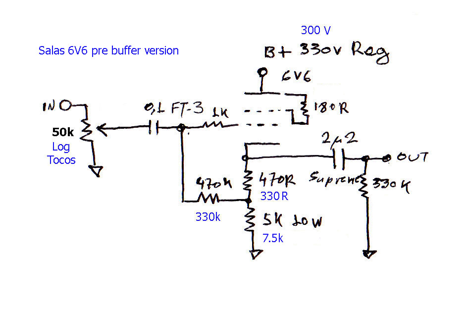

It can work with 7.5k plate load at an operating point of about 20mA Ip. But on 300V B+ also to keep things in proportion. The bottle runs cooler with less THD. The hotter standard configuration gives higher 2nd harmonic. Your subjective choice.
For a corresponding CF version with 7.5k and 300V B+ you should do like this:

So, I managed to find a few resistors to make 5K on the plates- (2) 20K and (1) 10K 5W each in parallel, so I'm good there.

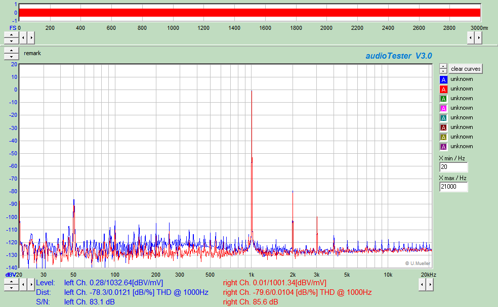

Mine is not the best arranged example and it measures like this in buffer mode. No audible buzz (100Hz and its harmonics). Left channel is bit worse because closer to the transformer. Uses the originally published constant current source DC heaters which are chassis grounded at one end.
Chart is with Russian 6Π6C, on RCA measures lower THD.

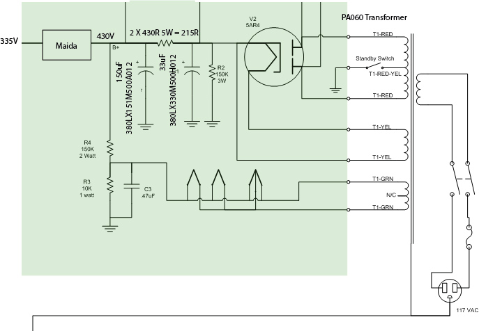

Hi Tom,
I do not have any additional decoupling after the maida. What values do you recommend? I'm assuming as close to the maida output as possible? Maybe that's part of the problem. After the maida, I have a twisted pair of wires that goes all the way to the tube sockets, around 6" of wire.
When you say at the input stage, do you mean between B+ and signal ground, but just physically closer to the input?
Something like 1-10 uF film cap from B+ to ground at each amplifier stage.
No, actually. You want it as close to the amplifier stage as possible. You're trying to combat the series inductance of the wiring to your amplifier stages (and series resistance in case of motor boating).

Which value do you have for R3 in the Maida? Looks like 30 Ω in the image you emailed me. That should allow for 120 mA peak. That sounds like plenty for a preamp, but it would be worth checking to see if the circuit draws more than that - in particular on startup.
Have you run the amp without the Maida? If you have a variac, you can dial the B+ to its nominal value by adjusting the applied mains voltage. You'll get lots of hum, I'm sure, but it would be interesting to see if the thumping goes away. If the thumping is there without the Maida Regulator in the circuit, the problem is in the rest of the amp and unrelated to the Maida.
