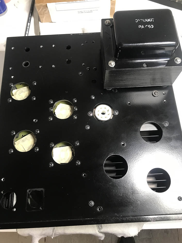

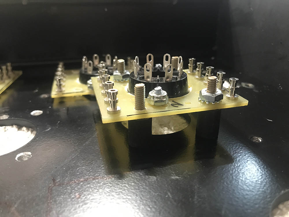

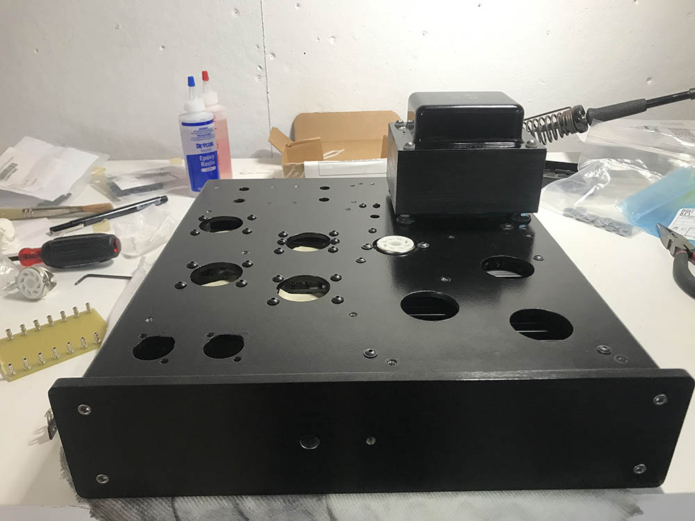

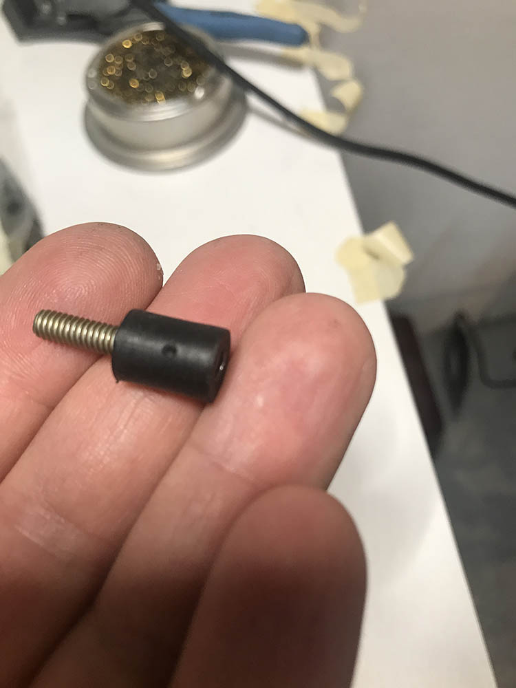

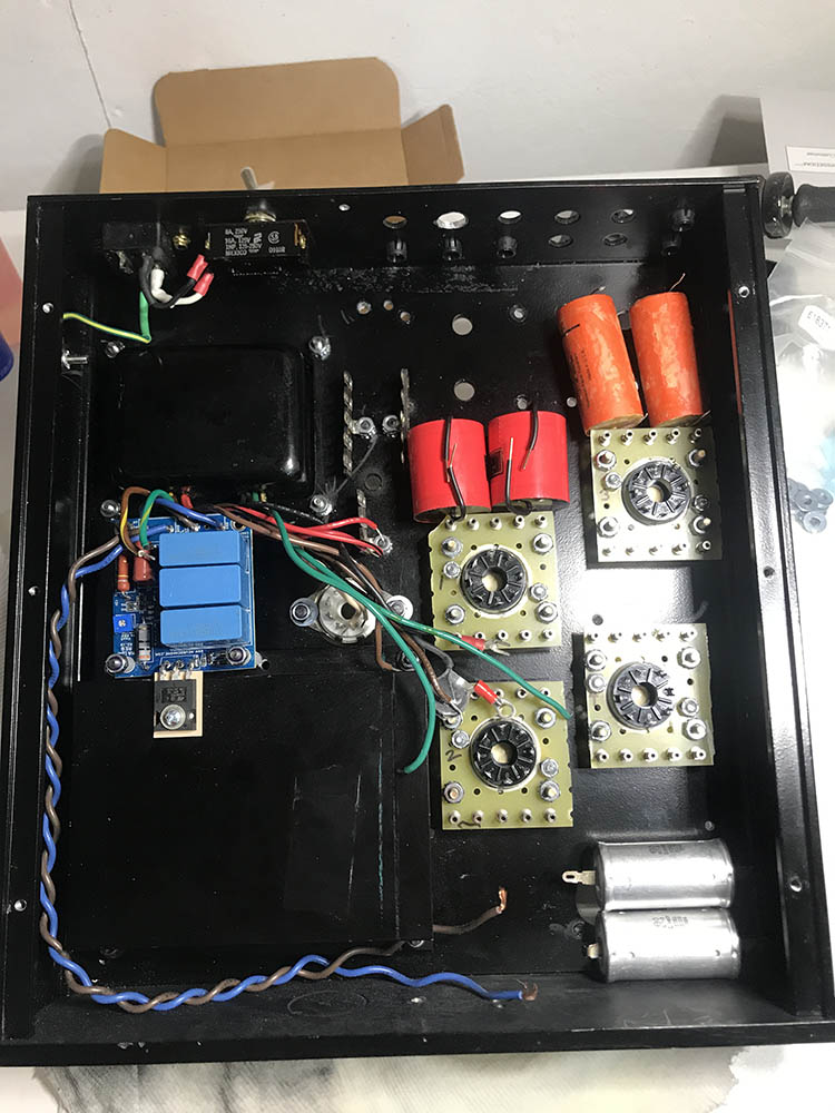

I'm working on a version of Salas' preamp that has the gain version and also the CF version in one. There will be a switch to choose which mode, and also a way to run one into the other, so gain with a follower.
For the gain + CF I was thinking to use this sometimes as a headphone amp, ala Bottlehead Crack. To do this I need a 100 uF or so output cap. Would using a cap this large negatively affect the sound when used as a line preamp?
Any suggestions on decent 100uF caps for this purpose that are not massively large?
I'm reusing a chassis and transformer from another project, so have the room for 4 tubes. I'm also using a neurochrome 21st century maida.
Thanks!

Crack was found with 188Ω Zo in that test, expect 220Ω from this 6V6 preamp's buffer mode says my LTspice simulation, so yes they are near in this regard. But is this standard good enough? Technically inadequate for headphones use, it needs a transformer. Same thing mentioned in the Crack test as well. But you could still give it a listen with 300Ω headphones and decide. HiZo may alter their response to your subjective liking. Use some nice 220uF 450V electrolytic for output capacitor. 450V has better ESR. Can be bypassed with a small film too.
You could branch to an adequate value film capacitor for line out, tap just before the big electrolytic cap used for HP out. Use bleeder resistors to ground at the output of those caps. 470k & 47k should do. Some output delay system with relay and DC monitoring like those used in power amps may come handy. To engage after warm up avoiding slow cap charge near DC cycles and on/off pops on cans.
Also a muting / cut off line out scheme with a switch should prove handy for when you need to use headphones for a while without turning off the power amp.
