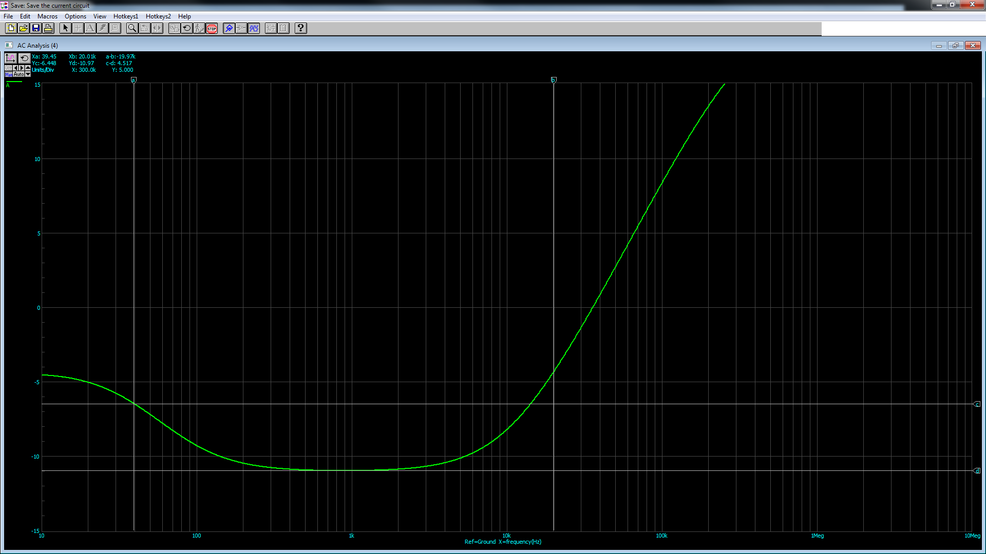

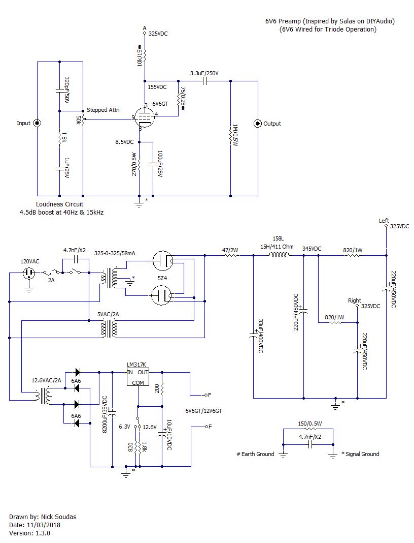

Due to my varied taste in music, I have added a loudness contour to the 6V6 preamp. I don't really need full blown bass and treble control, but a little boost is always helpful, especially at low(er) listening volumes, where most of my listening is done.
The boost curves (4.5db at 40Hz and 15kHz) were set to compliment my ported La Scalas.
I have also modified the filament power supply to be switchable between 6.3V and 12.6V, so I can swap between 6V6 and 12V6 tube types.

My final version of the 6V6 preamp was going to be transformer coupled (15k:600). However, a 6SN7 direct-coupled cathode follower (and it was free since I had all the parts) is just as effective to drive just about cable/amp combination. The cathode follower preserves the 6V6 magic, but with a low output impedance and some drive current.
Frequency Response: 2Hz~80kHz, -3dB
Signal to Noise: (400Hz~80kHz) 95dB below full output
Gain: 5.7
Note: The 6V6 cathode resistor in my previous post is supposed to be 470, not 270 Ohms.

Personalized with some frequency shaping for particular speakers and listening habits, an extra stage with parts that were laying around i.e. customizing and readiness are strong DIY benefits. The gain at 15dB as with my original. Those old tubes were made to good standards. I also see that the cathode capacitor is moved across the full cathode resistance in the last two iterations, no split decoupling as in your first, also as found in the original.
Congrats for finishing it up :up:
I needed the few dB of gain back after implementing the loudness contour and cathode follower.
Overall, this preamp sounds amazing. I highly recommend a version with a cathode follower to isolate the 6V6 from your preamp cables and amp.

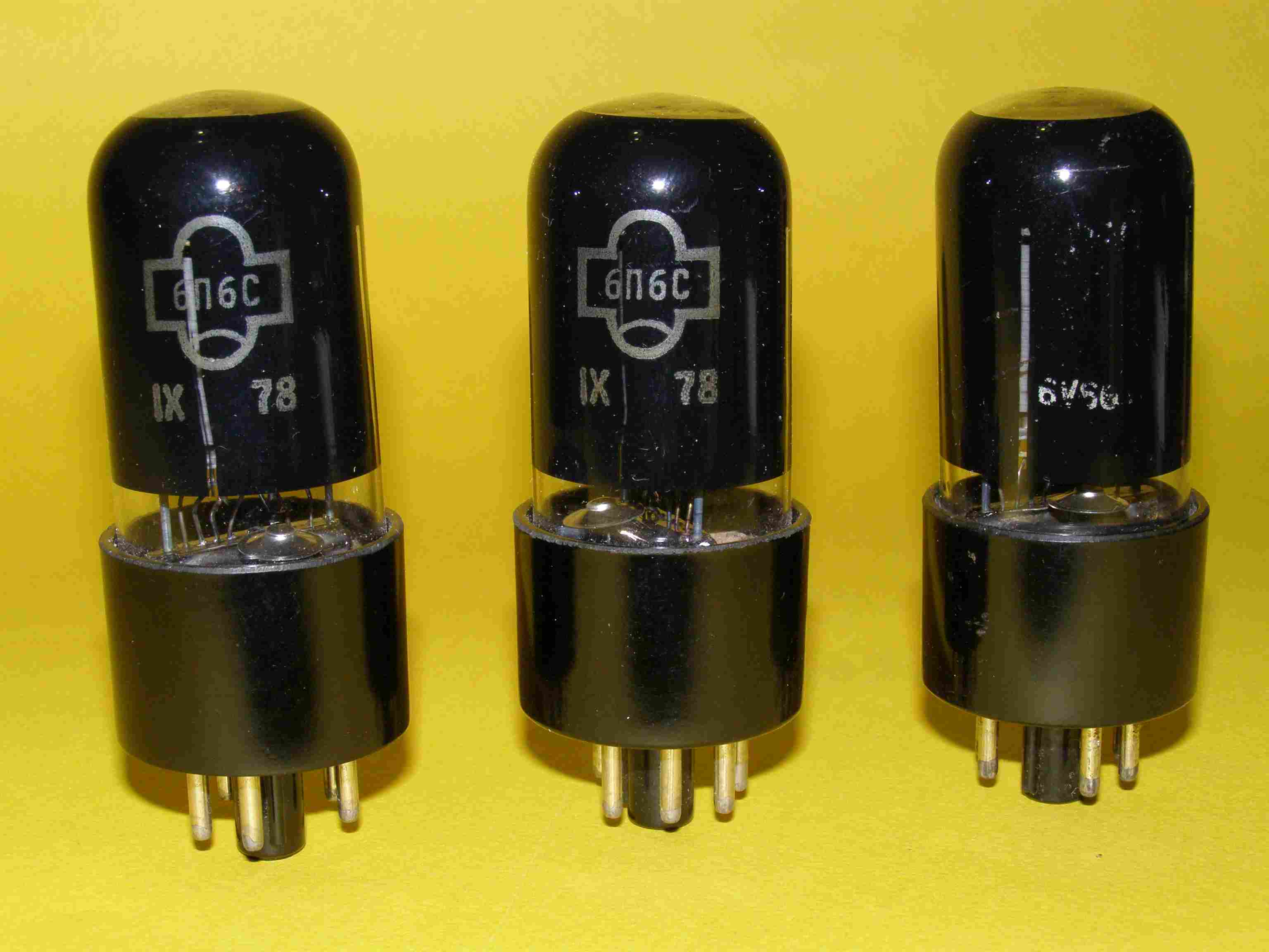

Salas,
Are those Russian 6V6's any less microphonic than USA NOS 6v6's?

Or the 6V6 preamp CF version itself for those who will not strictly need line gain. Russian reissue "Tungsol" 6V6GT were good for microphonics when I got them, better than most NOS I had around. I did not have black anode RCA nonetheless. The "Tungsols" also had a clean but balanced sound. I don't know if they are still making them exactly the same as ten years ago though. They were rather newly introduced back then and many samples even had a cosmetic fault, their bottles were cemented to their bottom bases at an angle. Like the Leaning Tower of Pisa but much less dramatically so.

Yes, many of us. They sound good and bit melodic, also well built, but in cheap multi-piece offers there can be duds among them, like hissy or to be dying out of the blue. No problem with those offered as selected measured pairs or quads though.
