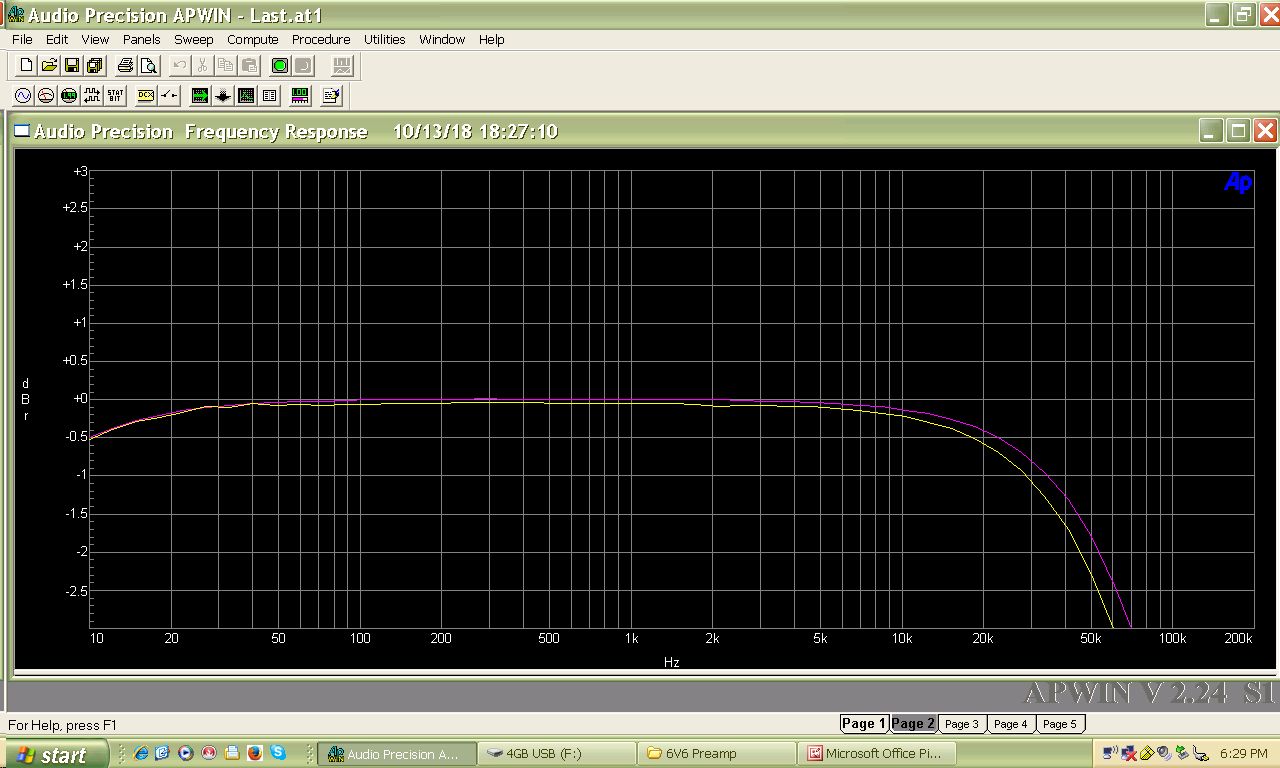

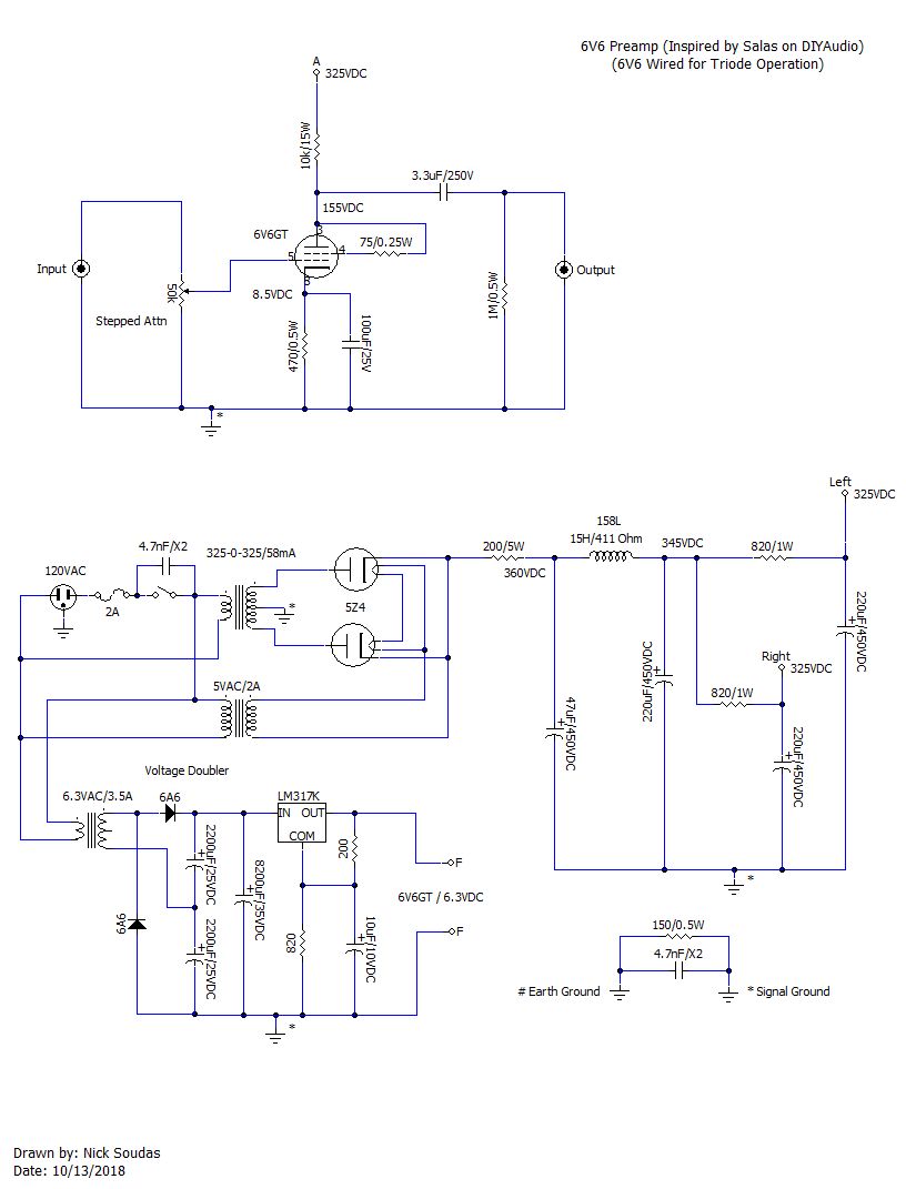

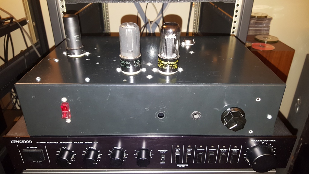

Here is my version of Salas's 6V6 preamp (gain version) that I put together.
Power supplies (filament and plate) are very quiet and performance seems reasonable for not being buffered.
I have it connected to a 2A3 stereo amp (that I also built) with ported Klipsch LaScala's. If I place my ear to the LaScala tweeter, I can barely hear a faint hiss.
The design was mainly dictated by an old 6SN7 preamp chassis that I had on hand. It was a fairly easy conversion. I want to ultimately use a pair of Edcor GXSE5-15K (Primary), Secondary (Output) Impedance: 600 Ω instead of the cap coupled output.

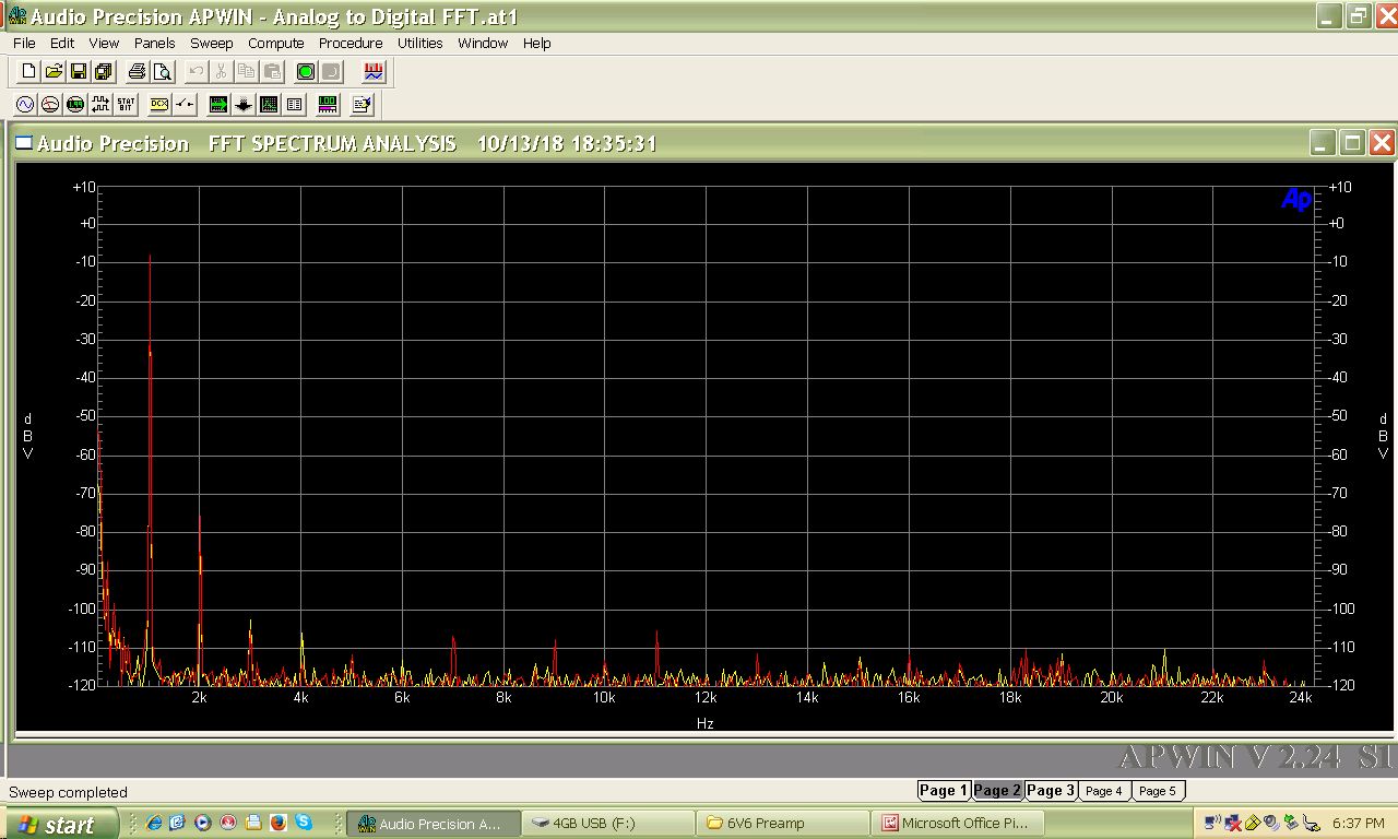

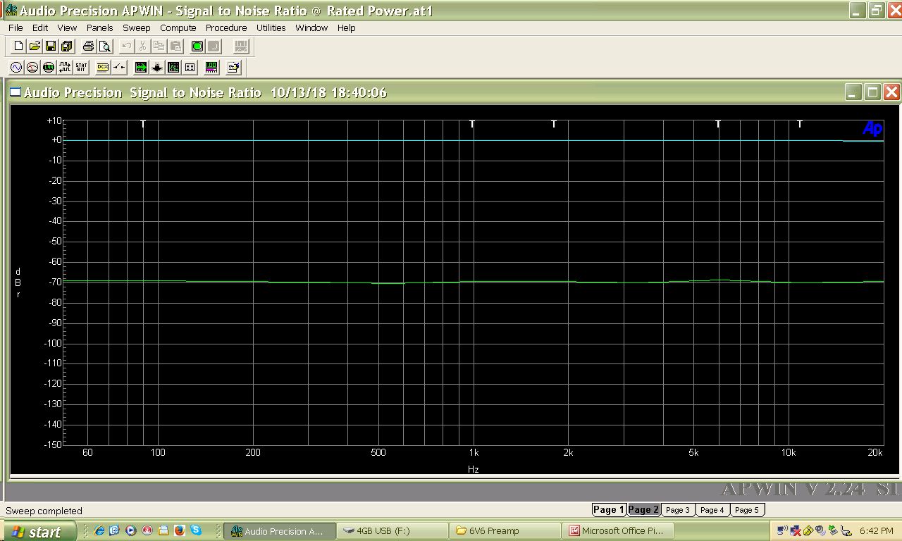

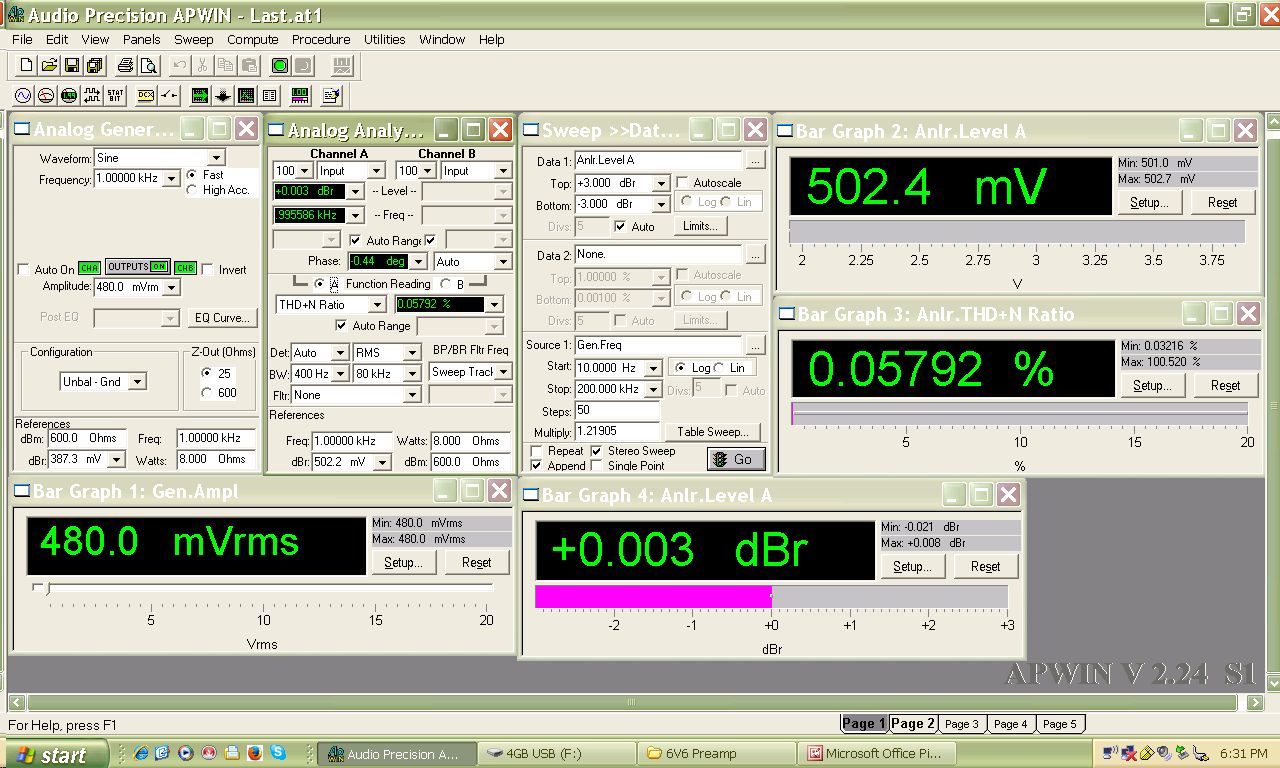

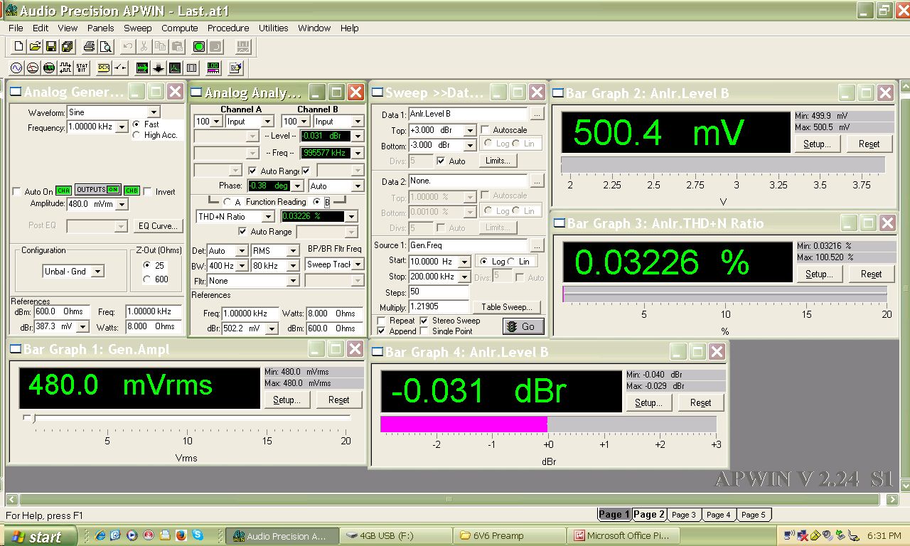

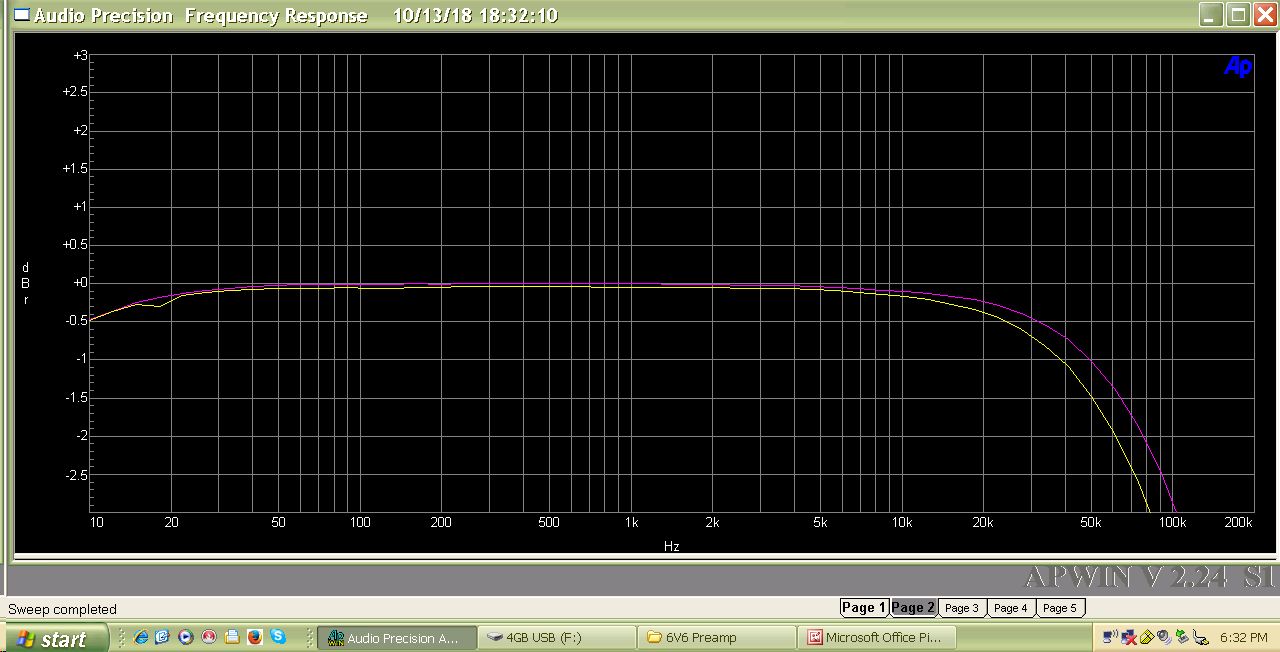

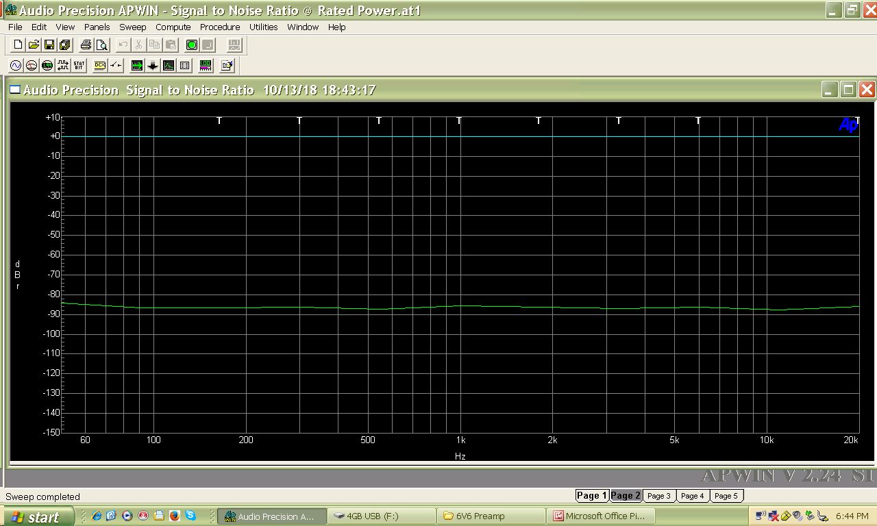

Some data from my Audio Precision (AP). The frequency difference between channels may be a component (or wiring) I am using. When I switch tubes, the disparity remains in the same channel. I'll figure it out eventually.
- Signal to Noise bandwidth is 400Hz to 80kHz.
- Signal to Noise is un-weighted.
There is an issue with my weighted AP filter that I need to resolve, which is why there is only un-weighted data.
A cathode follower or step-down transformer would help extend the frequency response and allow the preamp to drive just about any load without frequency anomalies.

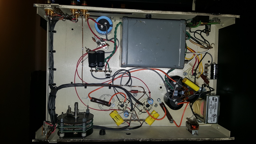

A few pix of my preamp test bed. Not pretty, but it is good for proof of concept projects.

Congrats. Nice presentation and testing. You opted for 10k plate load instead of 5k I see. That gives better THD but more Zo. Its a fair trade off when the load permits.
The -3dB HF response can be extended with a lower value pot. Maybe the 100kHz to 80kHz response difference between channels in the curves has something to do with the pot's output resistance and unequal pF to the grid. Wiring, bases, pot decks, could affect. That would give different Miller and RC time.
Ultimately, if you don't strictly need voltage gain, the cathode follower version offers better extension and general spec. Tx output instead is good also, at least for SNR and Zo. The Tx has its own response and THD spec to mix in. You could rather easily try both and decide.
The CF (buffer) version is not inverting of course so remember that during comparisons with an inverting version. Just swap the speaker leads between red and black at the cabinet's binding posts to restore absolute phase for the inverting one.

The 6SN7 preamp had more gain than I needed. It also had more noise.
Overall, I believe this 6V6 version will suite my needs better (especially after the transformer conversion). The 6V6 sound and performance seem to be a perfect compliment for my listening tastes.
Forgot to mention... the 6V6 is microphonic, but I'll address that in the final build project by isolating the tube sockets. I have some 6V6 metal tubes which measure and sound good, but seem to be the most microphonic.

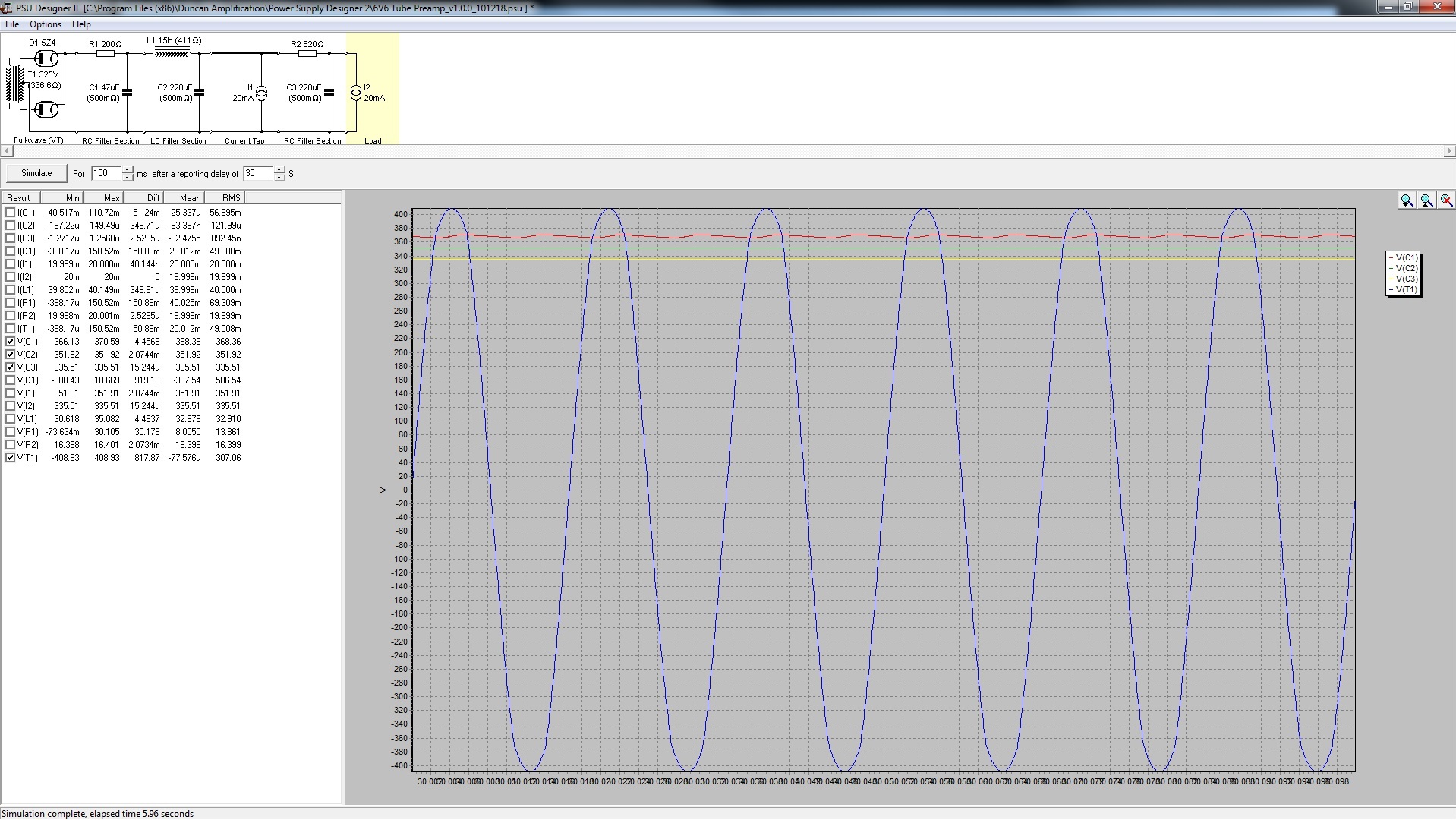

Attached is the power supply simulation for reference. The power supply can be fairly simple, but still low noise. I'm usually a fan of simple, but high performance. I don't like to make things overly complicated, from a sonic standpoint and service.
Its alright when you got the iron i.e. good high value choke that won't saturate loaded with two 6V6's current bias.
I added a very small amount of current feedback to reduce the gain a bit (about 1.6dB or 0.5VRMS reduction). The gain structure is perfect now for my taste and equipment.
Although I can't measure it, the residual noise structure is now "quieter". Before feedback, with my ear to the tweeter, I could hear faint "popcorn" noise, now it is just a faint hiss.

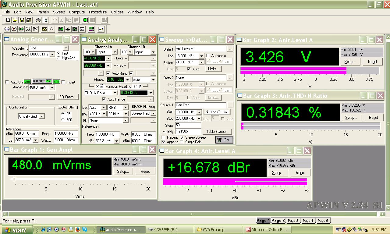

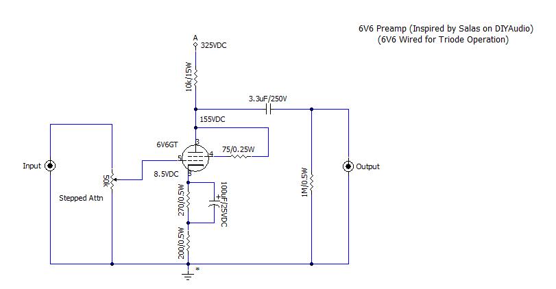

Spice says 0.03125% THD (not +N) at 1kHz 9.8dBV out* for the above circuit, seems optimistic
For bias point it says 8.22V and 17.48mA at the cathode, the model is very close at least for that
*0.5VRMS in 3.1VRMS out (pot at max, gain X6.2)
For 450mVRMS in, I am getting 2.7xxVRMS out (no load).

So your real gain is X6 vs X6.2 modeled, not bad, within tube μ variation error

Gain error between channels is < 0.1dB
