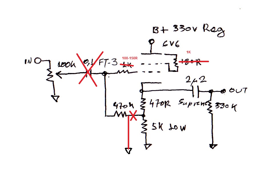

Ok, is 200V ok on those FT-3 input caps, or do I need to go 600V. Size is a bit of a concern.

Theoretically 200V is alright for that input position in the buffer version (cathode follower) but prefer a higher rating if you can because the thicker film material inside achieves better spec and reliability.

Good news about solving your hum. If you mean 4u7 in the output position, that's also legit. When you want same bass and upper bass "feel" between systems calculate the RC time (translates to frequency) of your output cap and next stage's input load (each system's poweramp) to be roughly comparable in phase shift.

I think that design change would put the grid at at more than -200v relative to the cathode. With rather tragic consequences.
It would lower the valve's now bias current roughly by four times rather. Whatever practical changes to the cathode resistor(s) values would not compensate a much raised THD result vs the original topology. Including the raised presence of higher harmonics than the second one. Some loss of level would take place too when for same I-bias.
