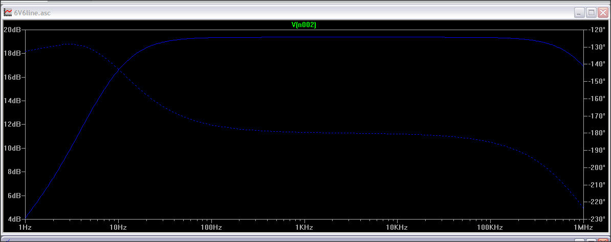

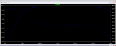

I have a pair of Magnequest plate chokes, BCP-15 which is 50H/40ma/575ohm. I'd like to know if theirs inductance is enough for adequate bass response and in the case they can be used then how is the new B+ should be.
Congratulations for your build. Let us know more about the system you added it in. Build photos are welcome. About the plate chokes, yes they are a bit on the low Henry side...
It will roughly show -3dB at 10 Hz and 40deg phase shift there theoretically as a combination. Not great for zero LF phase shift, but it will play bass. Up to you deciding a test if its handy so to see how you like them. It will play couple of dB louder also, so normalize that when comparing. You will be needing 180V B+ for them.

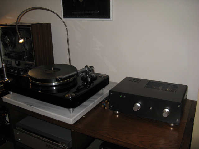

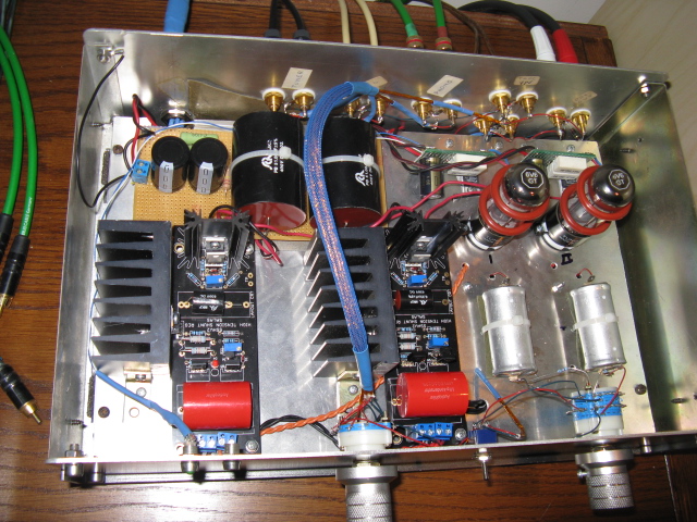

Winter came, got cold outside - finally - so found some time to rearrange my 6V6 pre as CT and finish the wiring.
If you can live without the gain it has one of the best sound for a preamplifier. Also much easier to get it quiet and not microphonic. I really love it like this.
Sound wise, more bass more resolution and more natural than a #26 or an AVC from Intact audio I was using.
When I find some time and persuade myself to get it out of my system for a few days, I have a more solid aluminum subchassis to put everything on, and maybe arrange thing a little better, especially on the underside!
