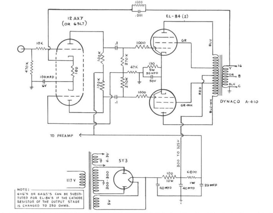

Does your PP amp pass a 10kHz square without ringing edges?

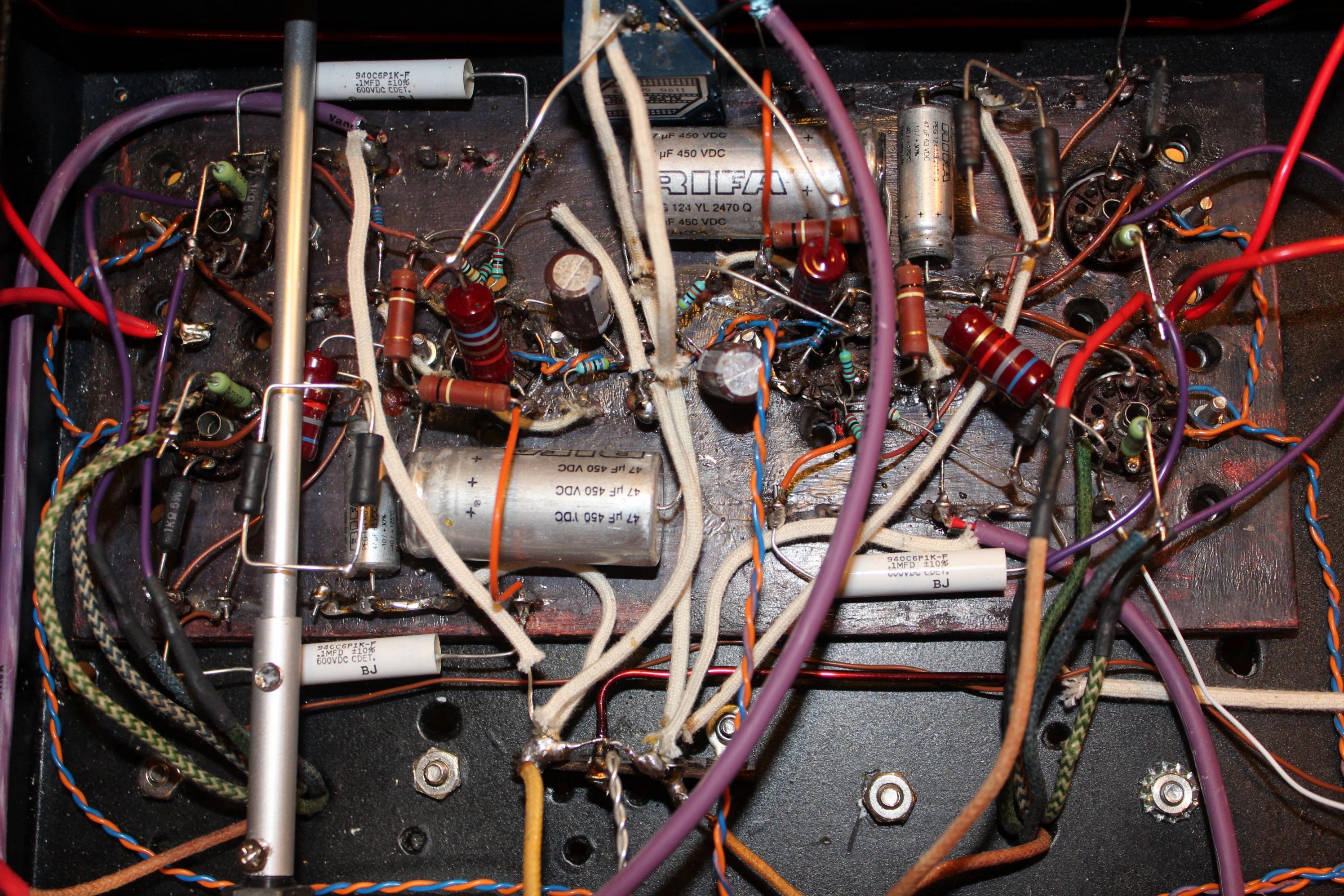

Probably not. I've tuned the Z565s with small caps, but atm I have a small motorboating 😎 so its not measurable at all. But its listenable. I went of from attached and did some tuning. I like it very much.

You got to sort out the amp stable and passing a smooth HF square. Now you have the TDS 340 to help you.

Yes. I was planning to rebuild it but I havent got around it yet. Right now its in some reused chassie with a completely oversized tranny.

Regarding the amp see about screen stoppers also.

On UL taps you mean?

I cant remember if I have them or not. I have hesitated on putting on the table cause I would probably start to completely rebuild it. But now I have a scope as you say.
Some 100-220 carbons might be a start.
The stupid motorboating just showed up one day. It comes after some playing and doesnt show up without signal in. Its on some half Hz or so and affects the stereo positioning a bit when listening. It goes away if I testchange to ECC81s.

Yes on UL circuit. To dampen the screen grids right on their pins. The sketch has none.
Well it wasnt the G2s, 150R carbons in the hornets nest and still 'boating. Search goes on.
That 100uF 6V could be doing something along with the 0.1uF couplers and the OPT turning the phase at the same point is another suspicion. Some value changes test in those caps maybe.
And/or a grid stopper on the return to the input tube's lower half.
I have a 1 k on both halves. I have tried to increase the cathode caps by adding a 470 on the 47 as Artosalo suggested in other thread. Still boating. I just soldered in 2k2s on GNFs but my son wanted some friday movie evening so I didnt have time to test. Later maybe. Thanks.
