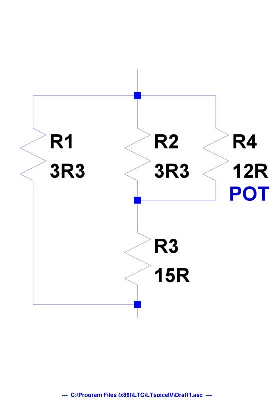

A voltage doubler on the 6,3 taps gives me 11,9 VDC over a 12R, so I guess I will go for a CSS right on that, no headroom for a voltage reg inbetween.
no need for voltage reg

If your transformer has a 3A heater winding use it !
alter R3 to 18R , if needed
If I calculate right this circuit gives me between 2,79-2,84 in CSS resistor value (edit, calculated with 18R on R3, which I had handy). When I tested some different tubes CSS regulated they were close to a voltage, atleast it was over half a volt as I remember, in difference between each other with he same resistor values.
Ie different 6V6es give about the same voltage (linear or regulated) voltage driven but differs alot when current regulated.
The thing is that I would not only want to tweak some with starvation, I would very much like to compare different tubes with the same voltages over the filaments.

The 10 R Flathead pots is good for a watt or 3 I guess. Maybe i should rethink?
Skipping R2 and make R3 a 12R?
