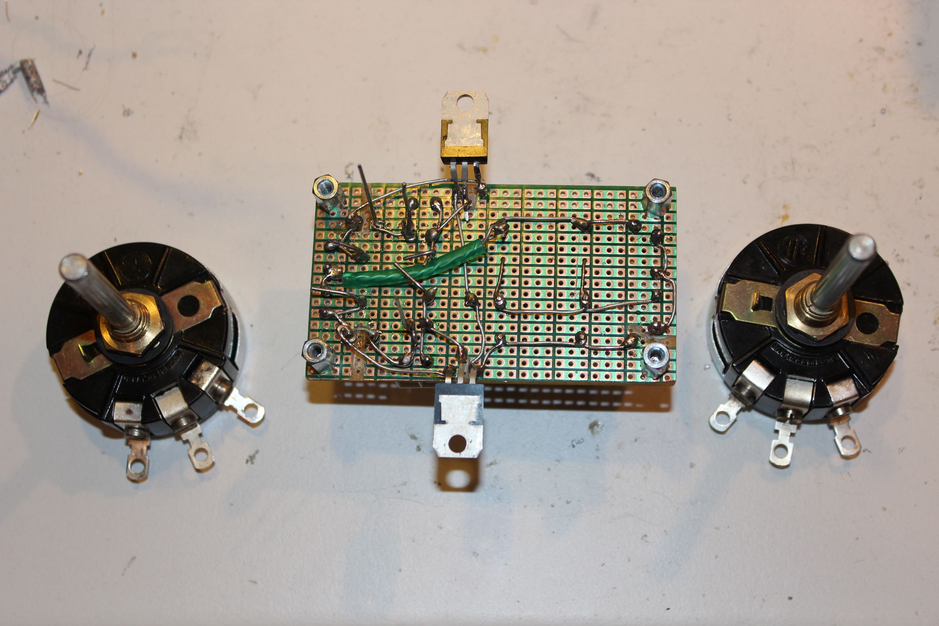

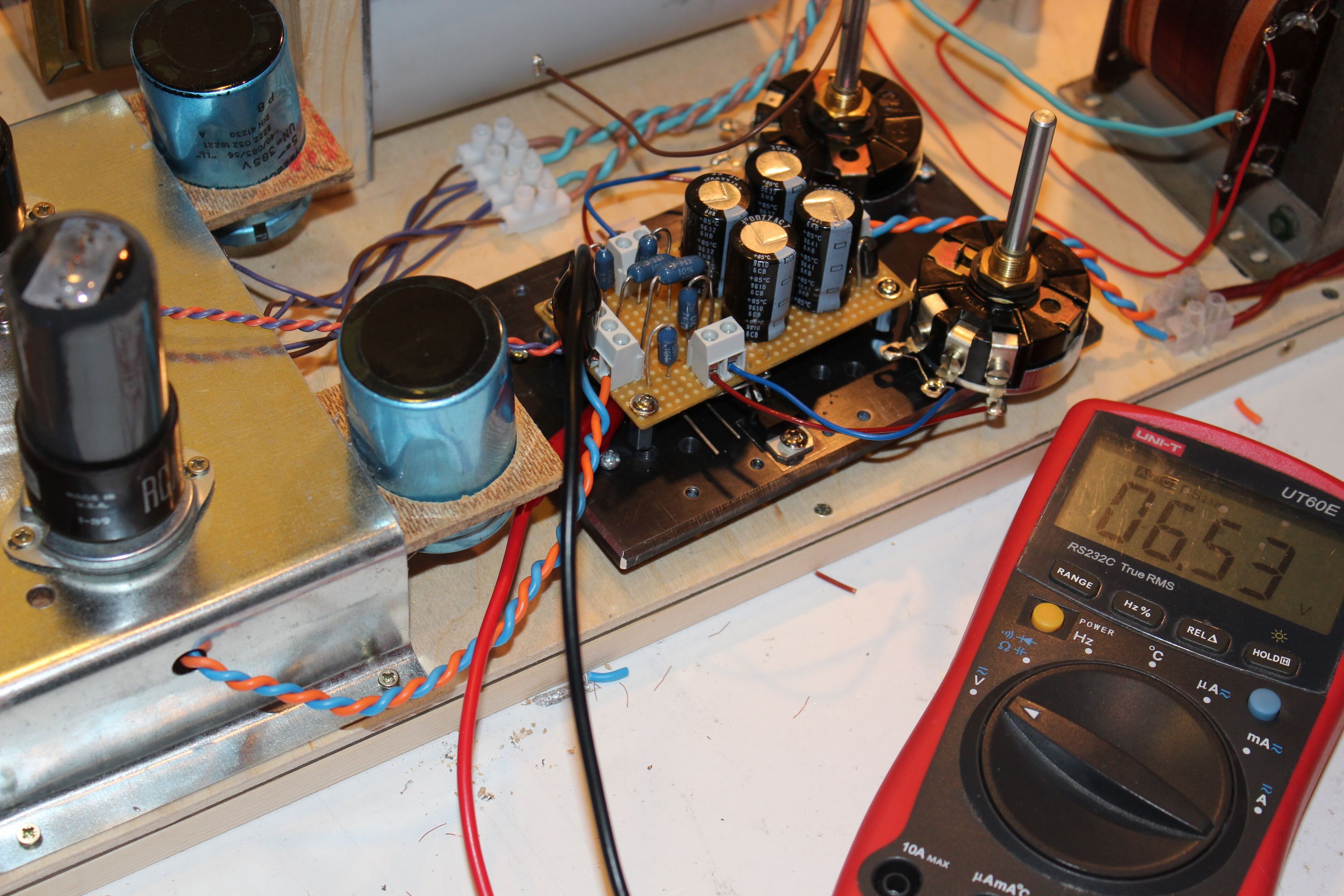

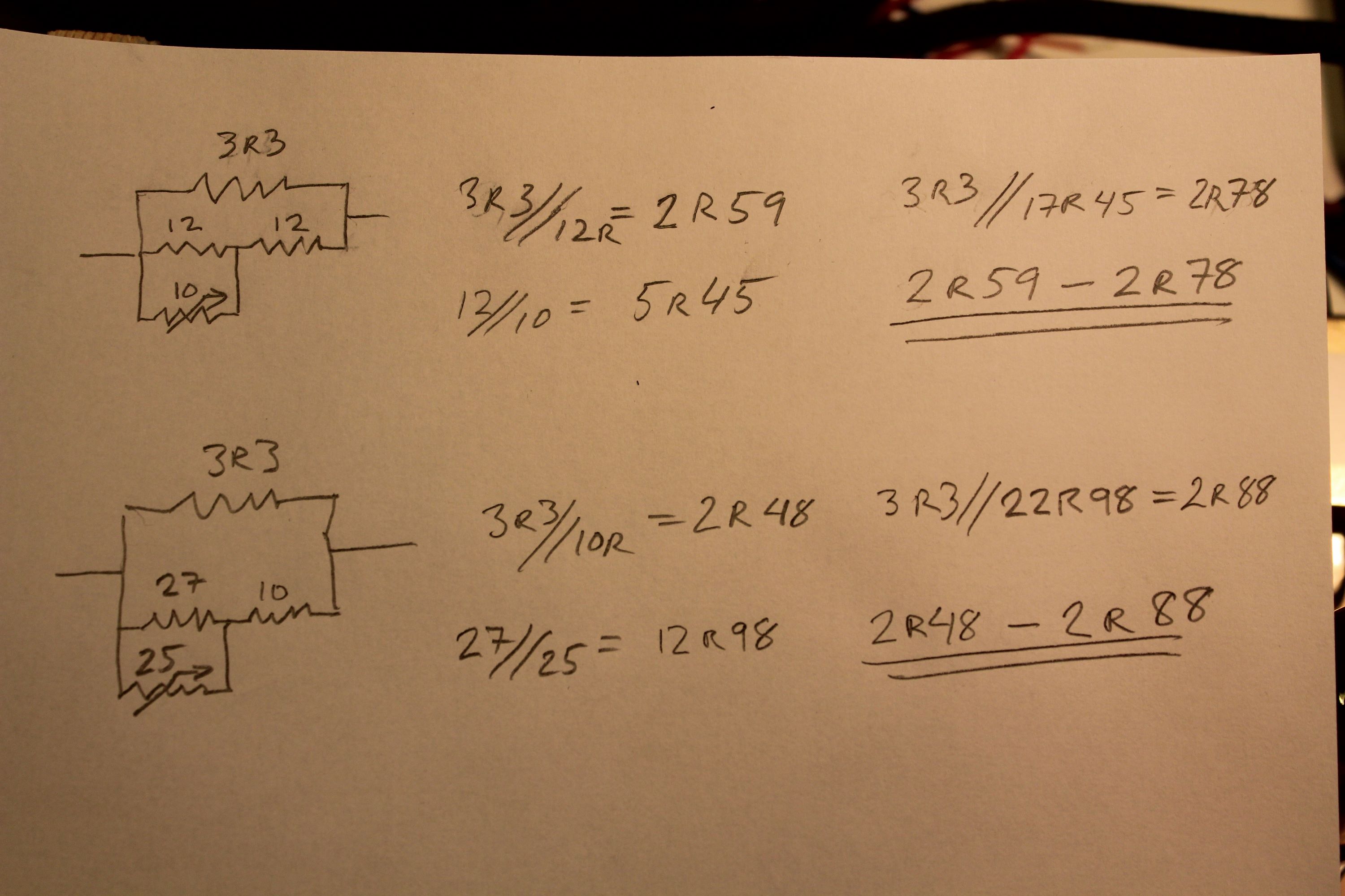

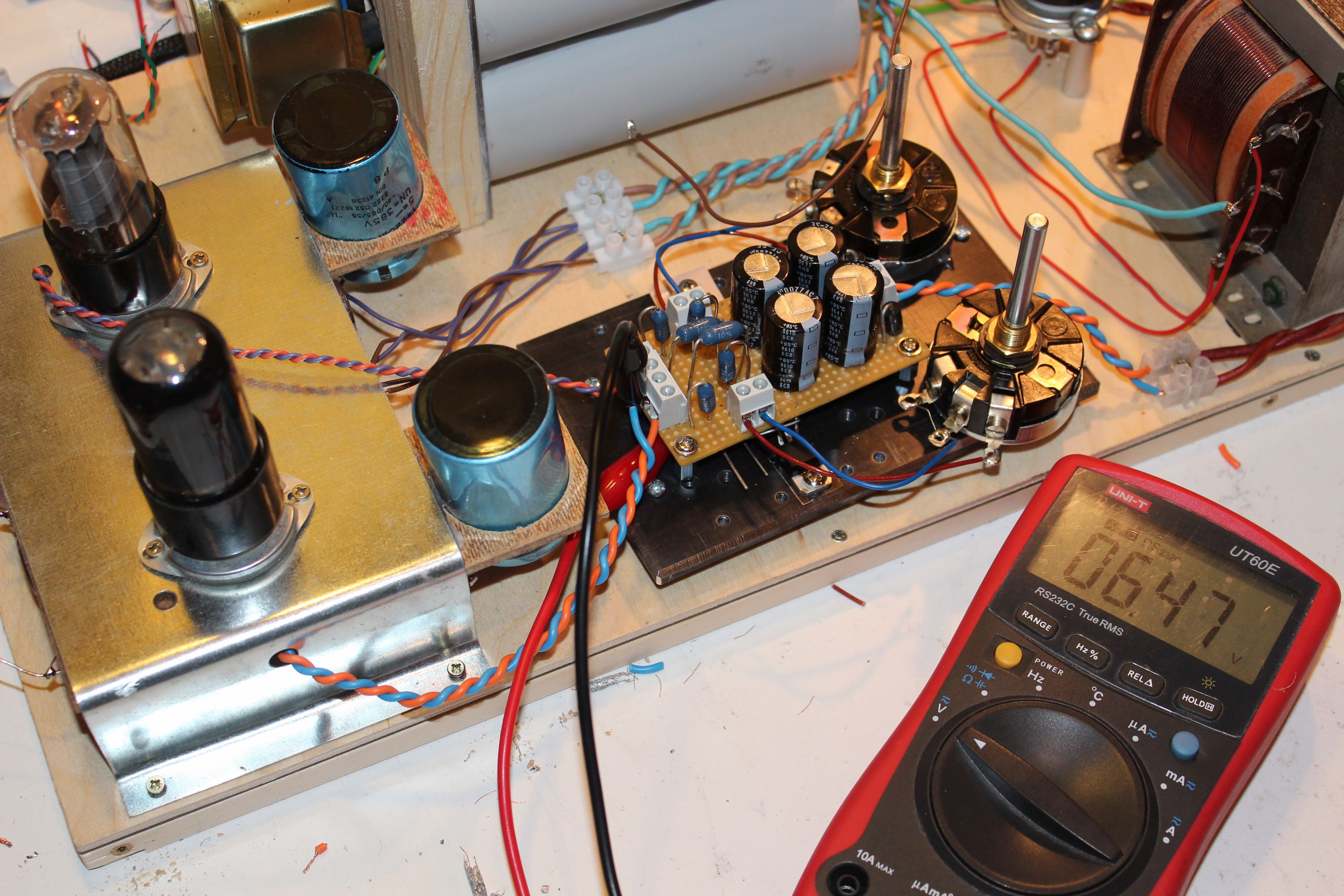

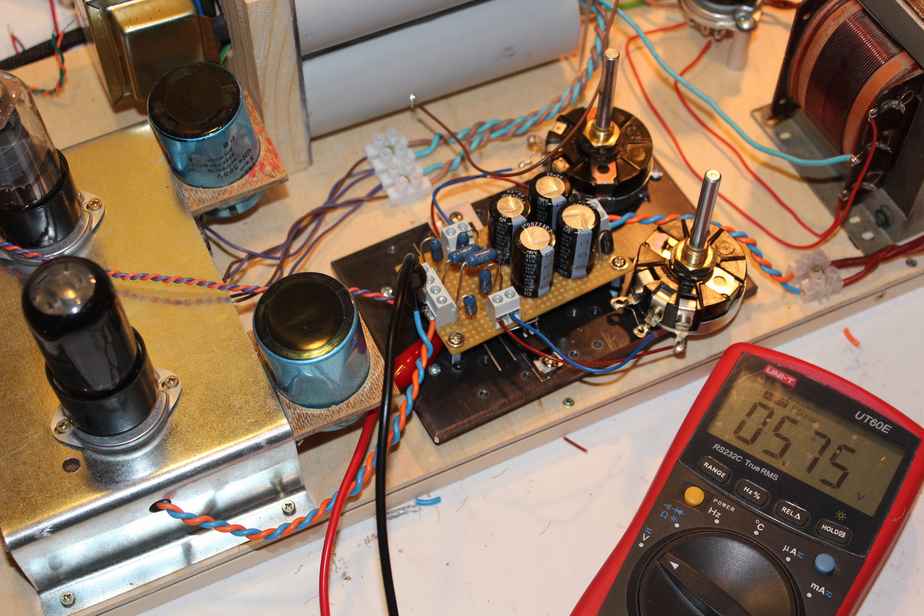

So, I secretly met up with the man with the goldmine again exchanging goods in a secret place. A pair of 25R pots. We shall se where that gets us. Attatching my calcs. My goal is a larger span, yet a fairly safe circuit if the pots for some reason would go south. Any objections, red cards etc hand them out now cause the iron is warm.

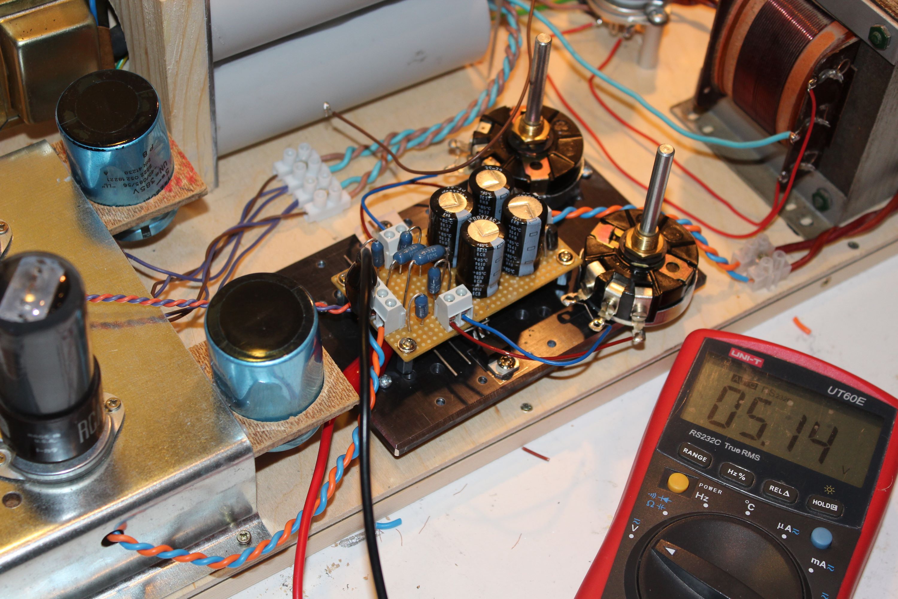

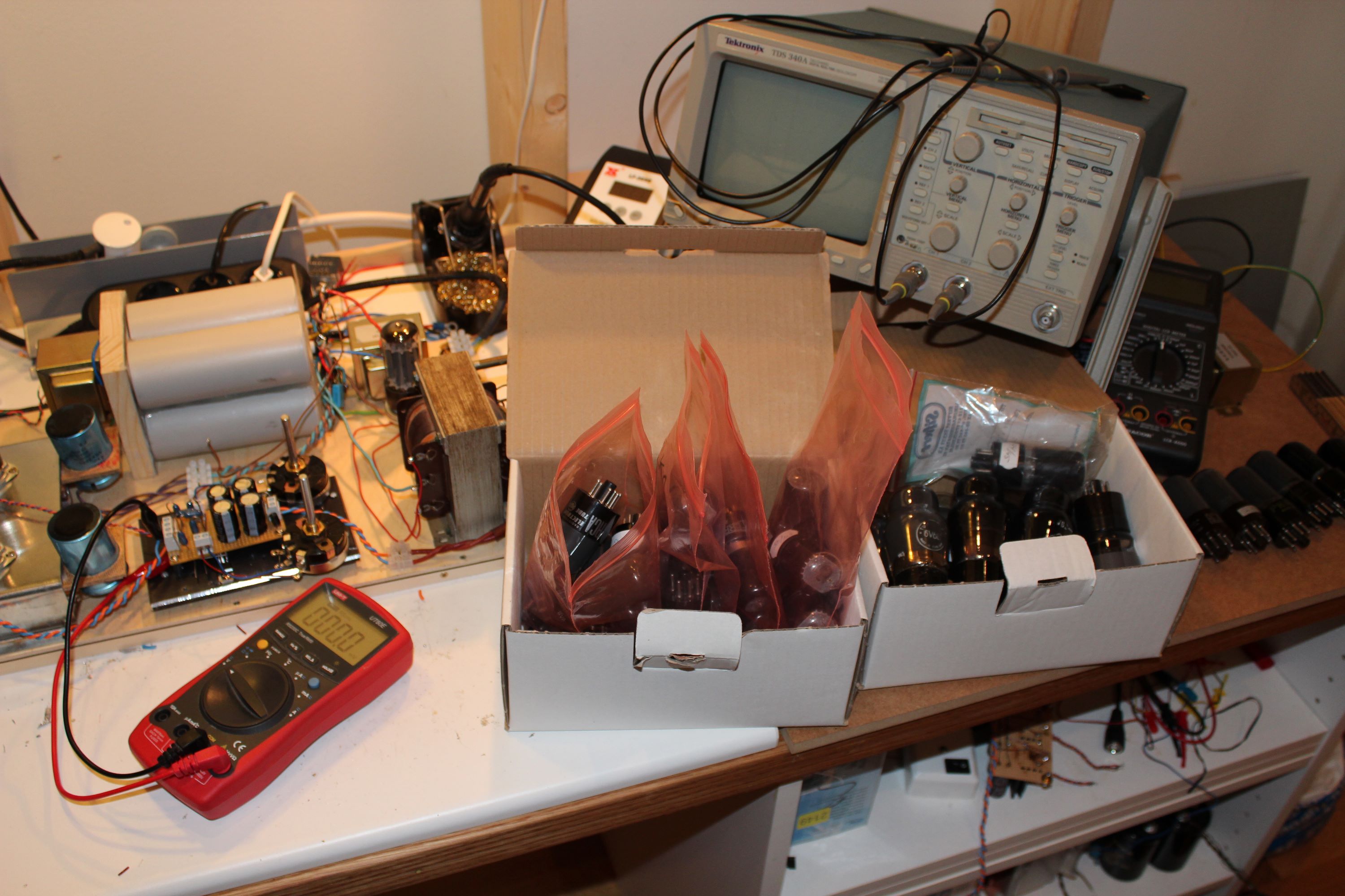

Ok, I tested the circuit (the lower on the above handscetched photo with calculations and 25 ohm pots) and it does the job very well. I tested a little more then a dozen different ones, RCA, Sylvania, Philips, KenRad, Ferranti, Haltron, JAN, SER, Tungsram, 6P6S, cocebottles, steelcans etc, different in age, measures, construction and they can all be set to a nice choosen level. They start usually around 5,5-5,7 volts and can be screwed up well beyond 6,3, which I avoided.
So I think this is going to be my setup for later build. If it tests ok that is. Thats the next part.
Thanks for help, you who assisted:)
/Staffan

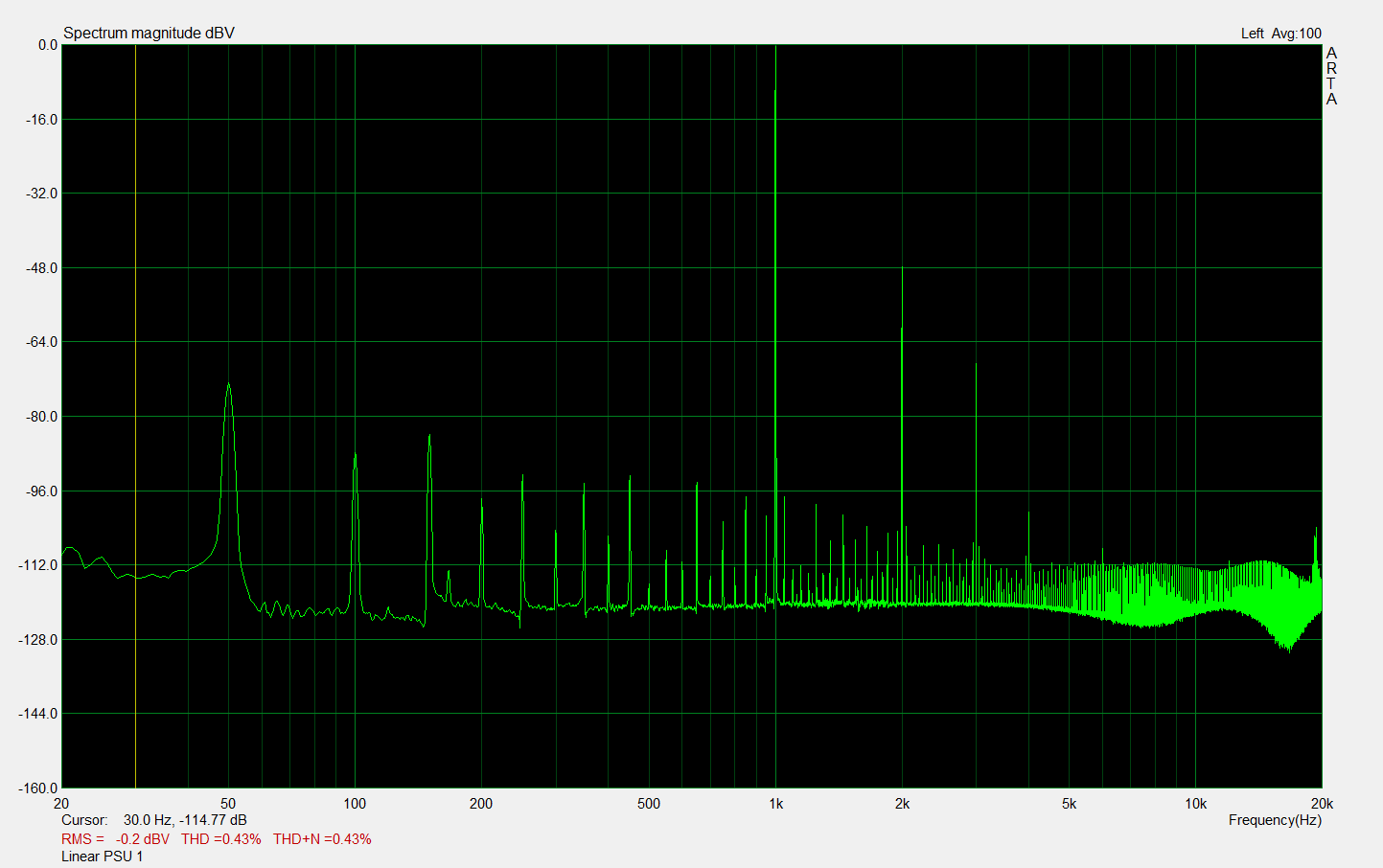

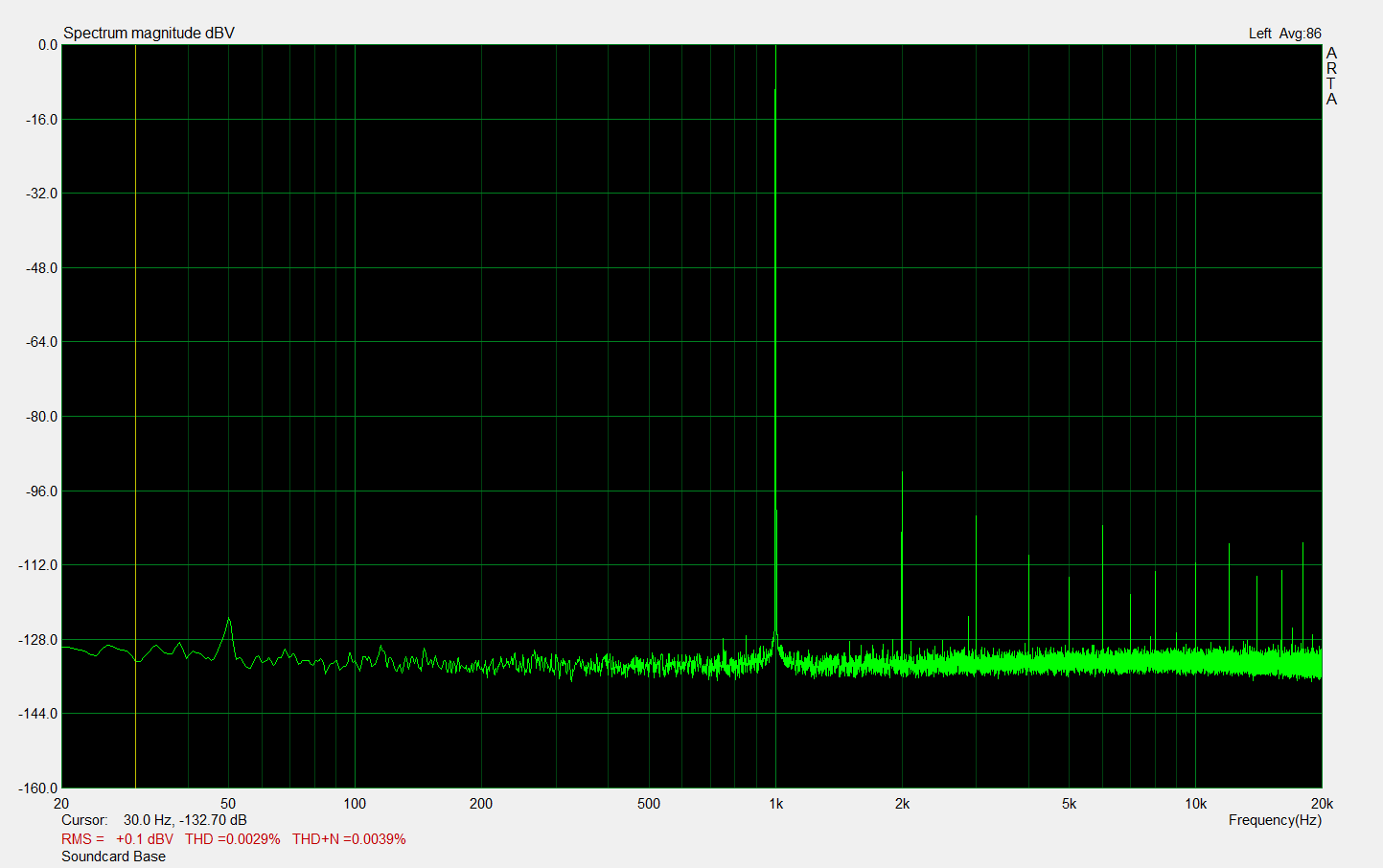

A near dead silent 340 V B+ 5k, linear PSU anodefollower is playing since a few days now. It added some brute horsepower to my little 11 w EL84 PP. Sisters of Mercy is moving the walls at just over half log pot:).
I had some busy days with other stuff but I will see if I can regulate it to and maybe try choke loaded anodes.
Strangely enough, tho its quiet in the speakers, no 50 or 100 Hz there, it measures worse then my humming cathode followers. I used the pot to level it to around zero gain for soundcard measuring.
