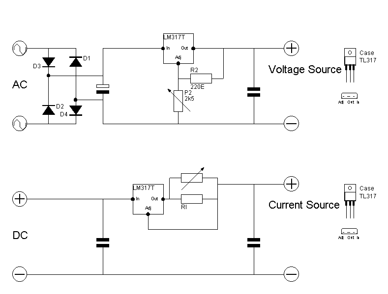

This is what I use. Simple but it works. (Plus I had the pcb's lying around doing nothing) I have the current source after the voltage source. But really some dc followed by a current source is good enough.
The pcbs can still be ordered if you don't want to do it p2p.
Scroll to LM317 PCB
A simple General Purpose PCB for Voltage and Current Sources
Or I'm sure there are cheaper alternatives on ebay.

Start by figuring out your max and min values for the resistor to get the desired set span.
Then choose a fixed resistor with the max value.
Then another fixed resistor that parallel with the first gives you the min value.
Add a pot in series with the second resistor.
That way you cant frye the pot turning it to zero.
Guess I'm ending up with expensive pots then since we're talking atleast one watt
Most current will pass the fixed resistor.
Adding a series resistor to the pot takes away the the high load at lower settings for the pot so no need for a huge pot.
You know the value of the resistor and the current for the tube that gives you the voltage drop across resistor.
Voltagedrop and value of second resistor gives you the max disipation in the pot.

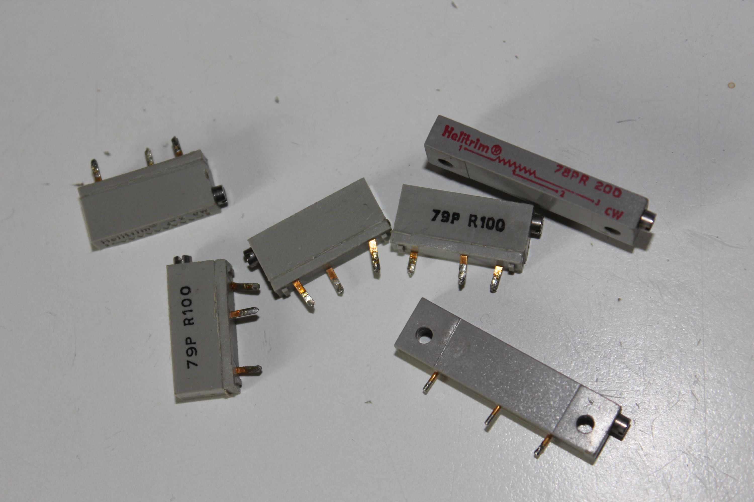

I found those in a box. I dont know their values other then big ones are 200R ans small 100R, but a guess would be 750-1000 mW. I guess I can try with a fixed 2,7 parallelled with a fixed 12R in series with 200VR

3R3? And maybe go lower then 12 in series with the pot to use that one resisting more then just a few ohms to ease it from passing high current. This is where I get a short in my head when I try calculating the wattage on the pot.
You can look at the series resistor and pot as a voltage divider.
So if you use a smaller series resistor you increase the load of the pot.
From the tube current 0.45A and the total resistor value 2.7ohm you get the voltagedrop over the resistor.
If you split that over the series resistor and pot you can calculate the dissipation in the pot.
Thank you. I know I sound silly here, the VR must pass same current if its serialed with a 6R or a 12R, its just that Im using the few ohms of its full variable resistance with the 12R and somehow something tells me that it going to fry it.
Pen and paper, here I come. Thanks!
