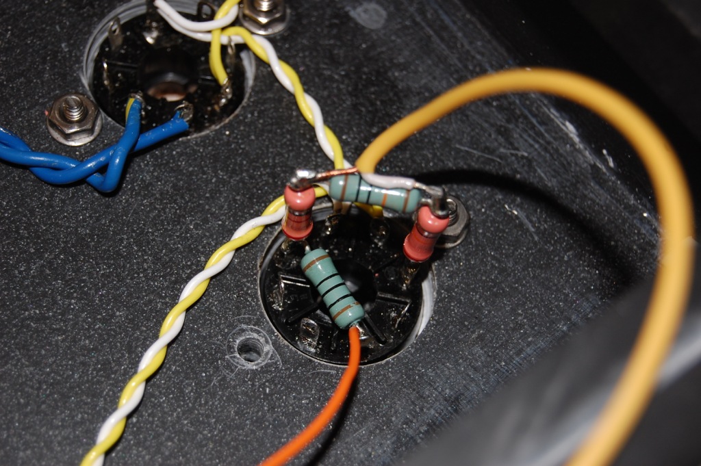

Good afternoon all,
I have taken the tag board out and pulled the wiring off the tube sockets. I tied the resistors for the input to the 6SL7 tube socket (See Picture). I still have to attach a ground wire to run to the star ground.
Is this connected correctly per everyones earlier posts. I just wanted to verify I understood the concept of what everyone was talking about (even it seemed like a no brainer) before I completed the other side and re-installed the tag board. I also added some extra turrets to allow me to get the wires neater and shorter without having so much slack and they will be separated (grouped) better.

Nice work. Looks good to me😉
You should also place the gridstoppers on the output tubes right on the socket pin.
Just from quickly looking, have you put a 1K resistor to ground from the 2nd grid as suggested before? If so, I would suggest removing and sticking to the original schematic, with the exception of grid stoppers. The suggestion to do this was due to not recognising the paraphase circuit. I would then run the amp without the feedback connected. When that is sorted, connect feedback (and determine if it is the correct phase, if it is not you will have positive feedback, leading to problems).

So - We are now going to go with the original input circuit? Take out the 1K and 100K resistors and put the 16v 100uF capacitor and 470K resistor back in?
I'm just making sure before I pull apart the wrong thing.
Also the 1K grid stoppers for the 6V6's are soldered to the tube sockets now, and the signal input + is going to the 10K which is wired directly to the tube socket.
I'll do these mods when I get home from work, just let me know if you see anything else.

This got kinda messy, easy to overlook the details.
You can go ahead and finish the amp per Ian's schematic1, just add the 100uF cap to bypass the 1kohm resistor.
The input resistor as mentioned is rather large at 470kohms though that is a classic value more common in the old days when sources had problems driving lower resistances. Today, espescially with all the HF muck around us, a lower resistance value is more common. It's a matter of taste, and anything from a few kohms to 1megohm can be used. I find 100kohm to be a good compromise for HiFi, and I doubt you will hear any difference between that and 470kohms.
The feedback resistor should be 10kohms. An eventual pot in series can be 10k-1megohm, the higher value, the less feedback. I'd try 100kohm.

Yep got it now.
Looks like, I was working on my port when you were clarifying yours. I'll put this together tonight using one channel to see what happens,then we'll go from there.

There you go😉 Good job.
You even made the grid stoppers a value I would use, though 10kohms on the input is fine, probably better at rinsing out HF sheit if that were to be a problem.

Looks good guys, thanks for all the help. I will get the tag board back in tonight, then start working on some of the power supply grounds as mentioned earlier.
I had a little set back so it is taking a little longer. I soldered the 1K gridstoppers inplace then attached all the wires to the output tubes then re-installed the tag board. I started to re-connect the tag board, then it hit me! I installed the gridstopper to the wrong pin.
I installed it to pin 8 instead of pin 5. So, I had to fix that. Now I'm ready to re-install the tag board and go forward.
I'll resume building tonight.
