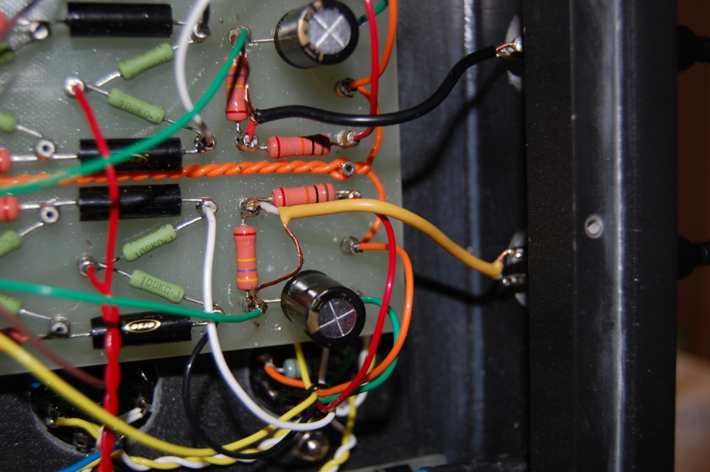

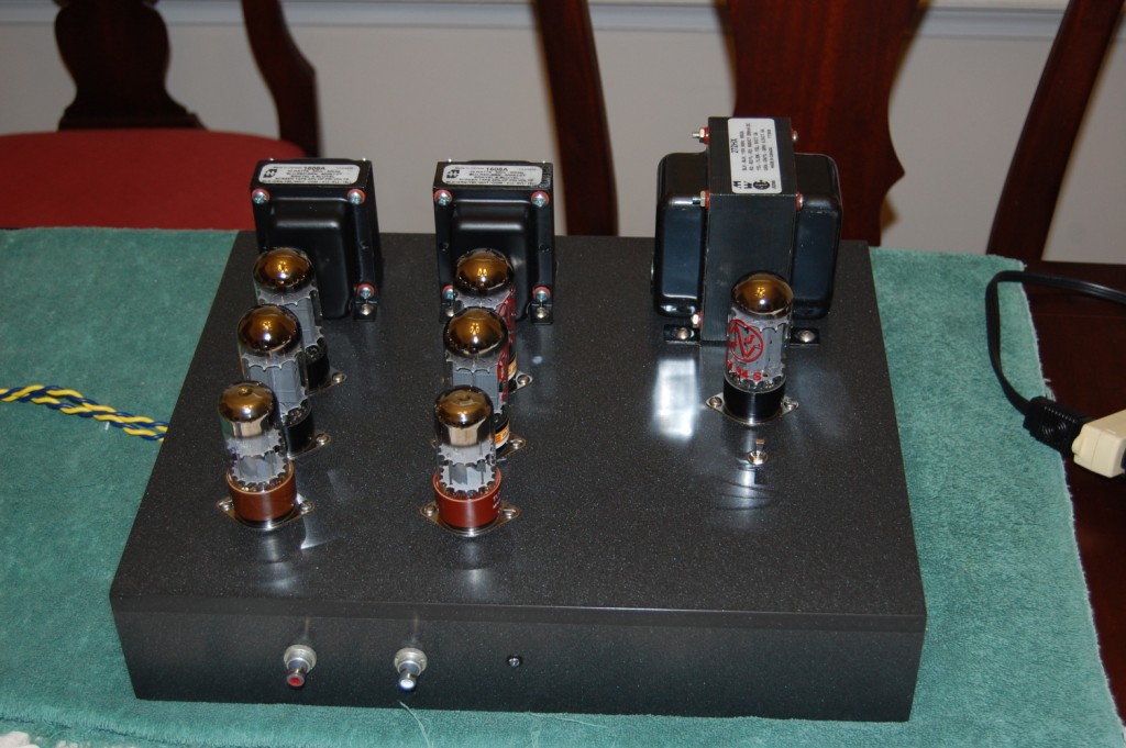

I just finished rebuilding my first 6V6 pp amp and I am having some hum issues.
The first build I had a hum/buzz that would be present when the amp started up but when a source was plugged in it would go away. Also when a source was plugged in there was a very slight hum when you put your ear to the speaker. I blame the lower hum on using a non-conductive material for a chassis and will address that after the main problem is found.

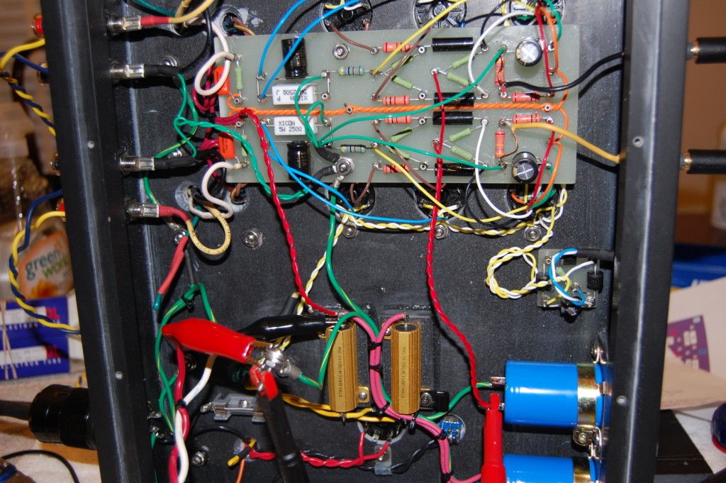

The second build I made a turret board with 1/2 spacers to keep it away from the heater wiring. I am still getting the same hum/buzz when a source is not connected, but it goes away when I connect an iPod. Also if I short the input terminal, the buzz goes away.
The input jacks are isolated, the earth ground is tied to the 3 transformer chassis for safety (not connected to the PS Ground).
Does this sound like a ground loop problem? Or a PSU problem? Both channels do the same thing. I am using a GZ34 rectifier tube.

I would modify your grounding scheme slightly. Keep the star on the tag board, but isolate it from the chassis. Have a separate sub-star for the power supply. Have this separate star point right at the second power supply negative terminal. Bring the first power supply capacitor -ive and the ground of the cathode resistor of the 6V6s to this point. Take a wire from this power supply ground and mount with a lug to the chassis. Make sure you use a star washer and scrape any paint/anodising etc from the chassis at this point. Then join the power supply ground to the star on the tag board with a bus or thick wire. The third power supply capacitor (22uf 350v) should be physically close to the 6SL7, as it is decoupling/filtering the power supply for the sensitive input stage. Ground it to the tag board star.
Oh, and grid stoppers are the 1K resistors on the 6V6s grids (and the 10K and 47K on the 6SL7 grids) and should be mounted right on the tube pins with no excess lead length. These help stop oscillation occurring from the inductance of the wires, hence right on the pins.
Someone else mentioned the grounding of the heaters. Have you attached the centre tap of the heater output from the transformer to ground? If not, you can make an artificial centre tap with two resistors. Improved noise performance is gained by elevating this ground reference voltage. The simplest method is to reference to the top of the cathode resistor of the output tubes. See here for reference and explanation The Valve Wizard

Take the centre tap of the heater supply to the new star ground at the negative terminal of the second power supply filter cap. You want this power supply star at the second filter cap neg terminal to keep the largereturn currents away from your sensitive input stage.
Here we go -
I think I found quite a bit of the problem.
First - As I said before, my chassis is non-conductive. The material works and machines lovely buy doesn't help with interference.
The turret board was built to keep everything neat, but the input stage area is where part of the problem is. if you look at the first pictures, you may see a red and yellow wire. These goto the Grids of the 6SL7. When I touch or move them the amp starts screaming like a Banshee.:irked:
The input wire is 1 inner conductor with 1 'ground/shield' outer conductor. That goes to the turret board to the 10k input resistor, then from there a piece of silver plated/ teflon insulated wire to the grid (pin 1).
So basically I have made an atenna sensitive enough to pick up transmissions from outer space. :rolleyes:
I am going to order some better shielded input wire and re-work the inputs to go straight to the tube socket and bypass the turret board. This will cut down on the length of wire plus give better sheilding. I will also rework the Grid wire (pin 4) that goes to 270k resistors.
That should take care of a good part of the hum. I will address the heaters as well. After that I will come back with an update and then we can see if we can get the rest of it knocked out.
