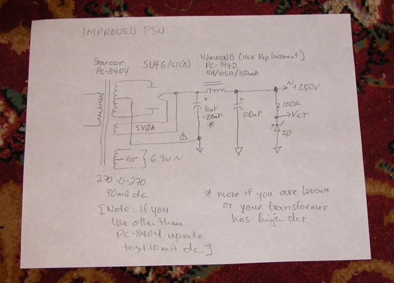

I've ordered a small Hammond 5H/105 ohm/150mA choke and will convert to CLCLC supply once it is in.. The ripple on the CRC filtered supply is rather excessive and can be heard quite clearly through the Half Chili Changs this amp was designed for. (Yes it is running!)
Ripple on the CRC is >5Vpp and is quite audible unfortunately, converting to CLC will reduce the supply ripple amplitude by roughly 26dB (20X) based on simulations and this should be good enough to get the ripple down to a couple of mVrms on the output.

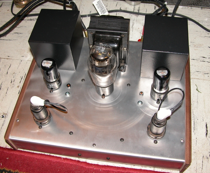

I decided to use some of my used metal Kenrad 6J7 - surprisingly they sound very good, and are immune to the external pick up issues that my glass NOS ones do exhibit.

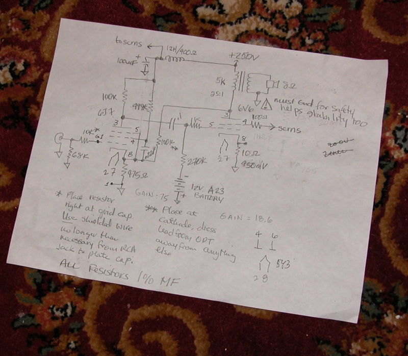

Here are the schematics in rough draft (not sure when if ever I will get around to drawing the real thing..) and a picture of the functional amplifier.

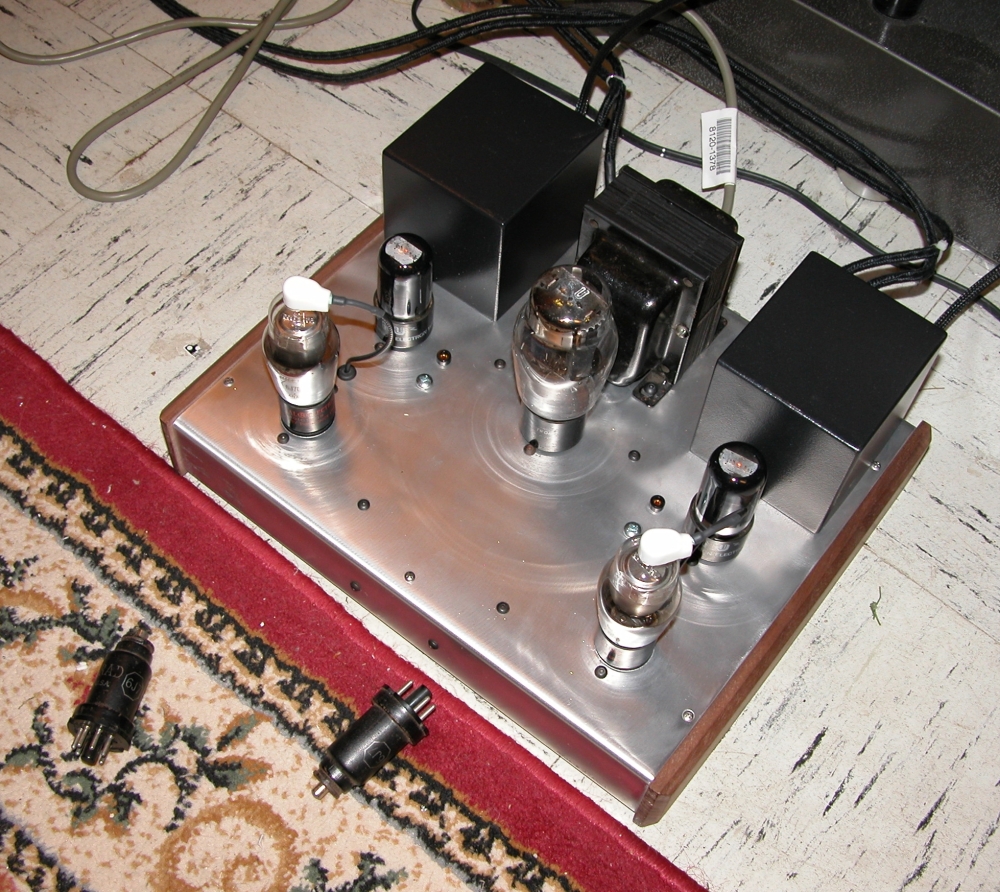

I have reinstalled the Canadian made GE 6J7G and think I might like them better. The metal Kenrads are quite good, but these sound a bit smoother.
The amplifier is sounding a bit smoother.
Note the gain is a bit excessive and you can probably use this with a passive line stage. Gain was calculated (not modeled) at ~18dB and it is at least this - oddly enough I did not actually measure the gain. Still more work to be done.

Kevin you could use a mixed bias: 9V batteries and some cathode bias with 22 or 27 or 33 or 39 ohm resistors. This should result in approx. -10 to -10.5 V bias (as you don't get enough current at -11V).
