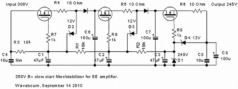

Instead of triode connection I would suggest you to try to power screens from an active filter consisting of high resistance voltage divider shunted by a big enough capacitor and a source follower. I.e. low dynamic resistance, and very low ripples.
I might be able to fit that in somehow.. Need to get some more HV mosfets first though.
