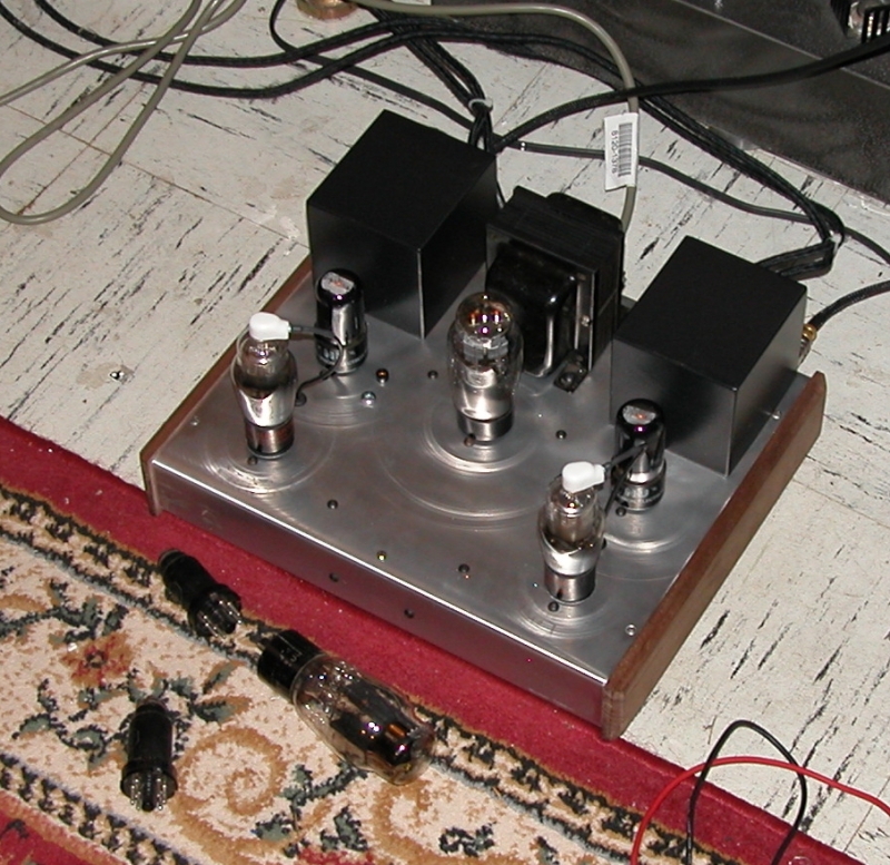

Made some fairly minor changes to the design today, mostly adding the global feedback from the secondary I mentioned in a previous post.
Turns out the OPTs are phased incorrectly from the factory which is a minor disappointment that was easily dealt with on the secondary side. The fact that the gain increased by a significant number of dB above the LF corner of the transformer was a clue, and it dropped radically below it.. 😱 No buzz reduction either. The stability margin was adequate to prevent oscillation despite the addition of a lot of positive feedback from the output: gratifying. 😀
I did some measurements which corroborated all of my off the cuff calculations, basically the gain with the internal loop closed was exactly 18 or 25dB as I had previously calculated (and may have mis-posted in a previous post) The open loop gain is extremely high - you can see hints in the little notes on the schematic. In any case I felt that a closed loop gain of around 14dB is about right for the supporting components in my system. This left me with 11dB margin which reduced the output buzz to about 2.0mVrms and lowered the output z by more than a factor of 3..
Incidentally the amplifier bandwidth measures at -3dB at 40Hz and 55kHz.
I boosted the plate voltage to roughly 270V and the measured cathode current is ~56mA - no red plates. Sounds slightly more dynamic.
The HCC are not very efficient with 5dB of BSC kicking in starting at 600Hz so with the feedback struggling to correct the falling bass response the amplifier now clips audibly on low bass driving these speakers at anything more than 92dB or so.. At reasonable volumes it sounds quite good - transformers need to have more primary inductance, otherwise they are quite good.
Here is the latest schematic, and another picture showing the amplifier with a GZ32 installed.
Note that the only change of significance is the addition of a 2K feedback resistor from the secondary back the 6J7 feedback node.
When the choke comes in I will install that as it will reduce the need for feedback from the secondary of the OPT if I wish to slightly increase the gain. Higher levels of feedback are possible which will extend the LF response and push down the buzz still further, but with the penalty of the amplifier clipping harder and more often on LF material - a trade off that is already on the wrong side of the tipping point IMO..
