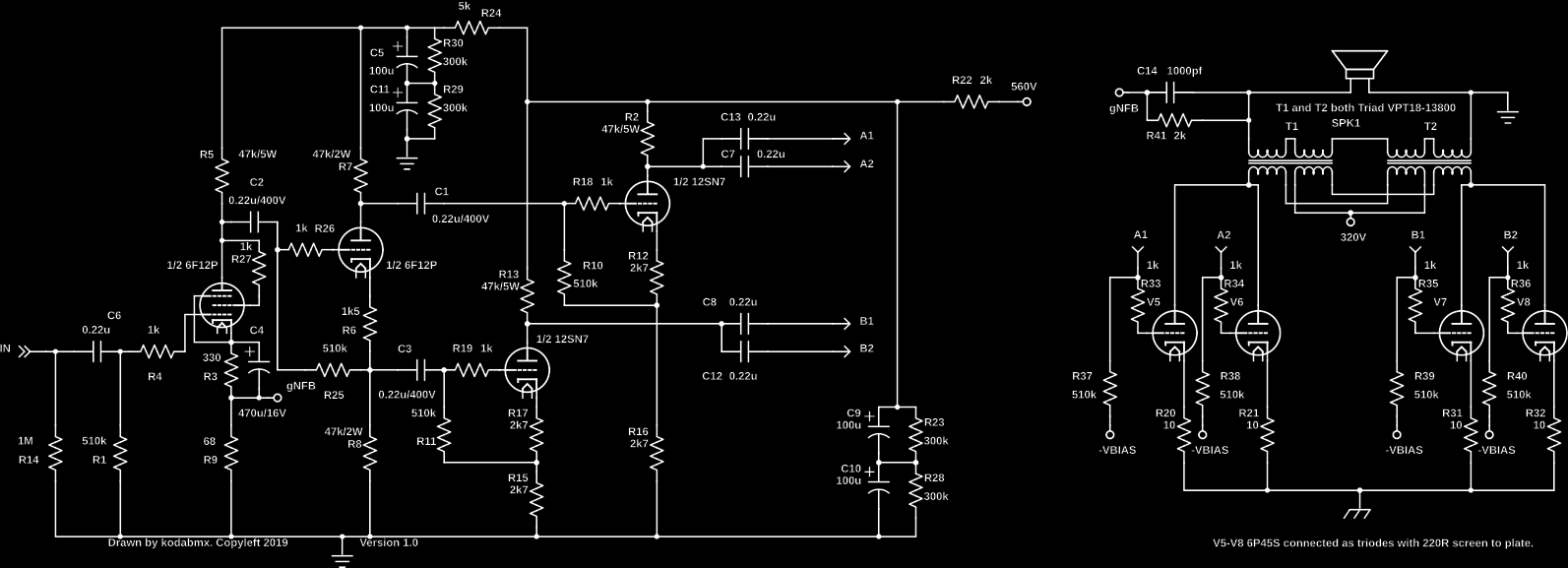

6P45S PPP Monoblocks.
OK. One final tweak.
gNFB is now 2k || 1000pf
This makes the square wave response more accurate.
