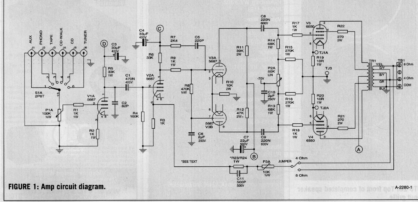

6P45S PPP Monoblocks.
I have a couple questions about these amplifiers, most specifically:
1. How did you establish that these output transformers are suitable? Are the secondaries also in parallel, or are they in series?
2. At what low frequency does the core saturate, at full power? How much power can they output at say 30Hz without visible distortion of a sine wave?
3. How is the high frequency response?
This is a really interesting idea, to use a power transformer as an audio transformer. Looks like it's possible to save a lot of money this way, I'm curious how well it works.
1 I calculated the Z ratio from the turns ratio. In this case it's 1k3:8R. The secondaries are also in parallel.
2 I can't tell you right now as my scope is acting up, but the input stage clips before the output right now. I'm thinking of adding a 6CG7 driver but I would need to reconfigure the power to get 500 odd volts for it...
3 HF response is flat out to past 50 kHz. 10 kHz square wave looks excellent.

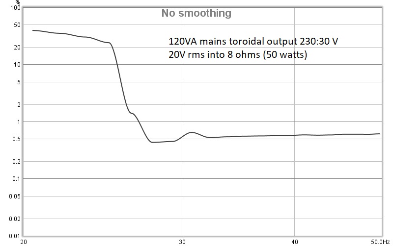

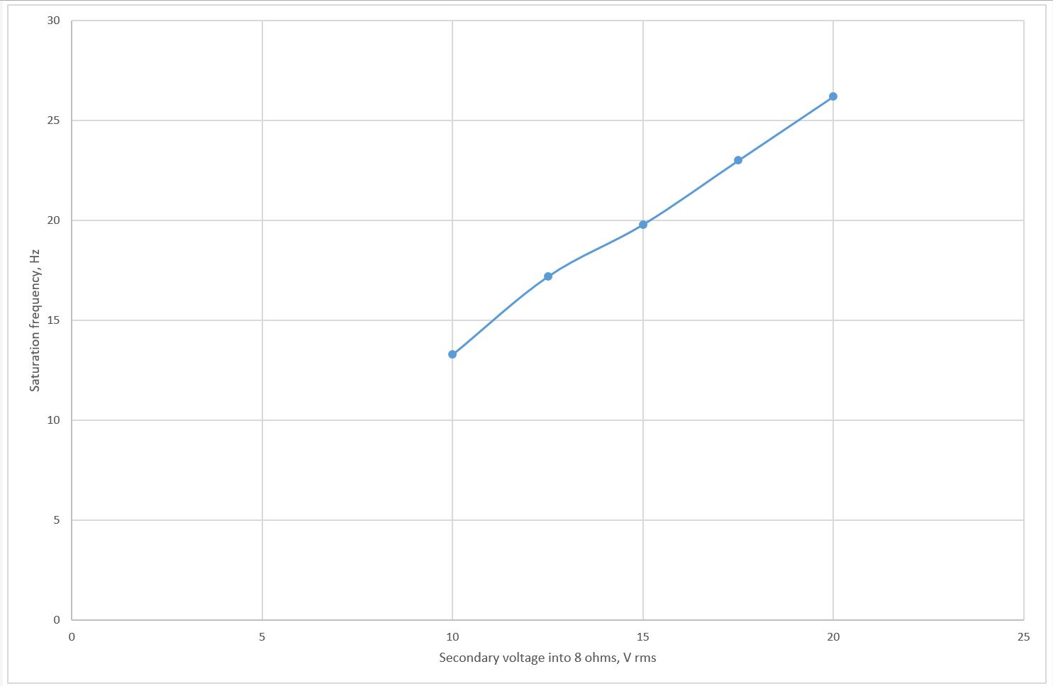

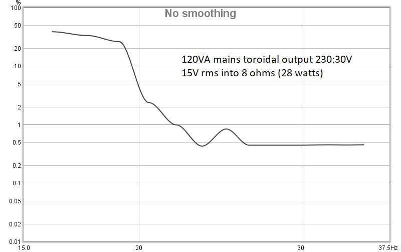

Attached is a plot showing saturation frequency for various secondary voltages into 8 ohms. The output transformer is a 120VA 115+115:30V toroidal, driven by PP mosfet hybrid triodes with B+ of 160V. Voltage at saturation is about 25% higher than what you might expect based on the rated secondary voltage. For saturation at 25 Hz, voltage is about 19V rms, although onset of saturation happens at a lower voltage. The other two plots show distortion for 15V rms and 20V rms vs frequency. Onset of saturation can easily be seen.

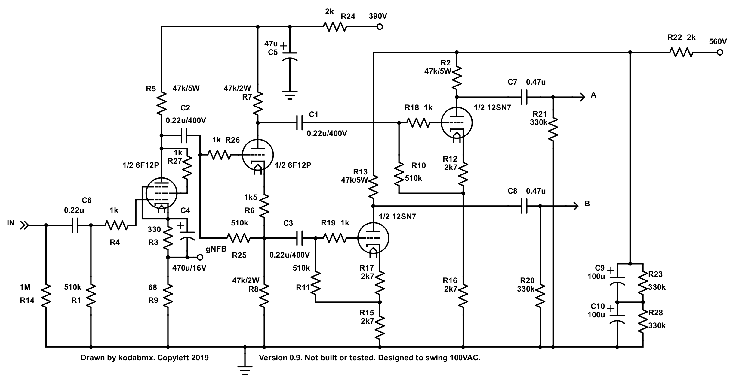

Here's a question for you all:
I've been using triode connection because I prefer the "voltage controlled resistance" rather than "voltage controlled current source", and that I think the low Rp works better with these toroids, but what about tetrode connection?
If I leave the voltage the same (300V-320V) what would you suggest the screen voltage be? 150V?
I assume the drive requirements would be reduced substantially? Right now the output stage wants 140Vp-p for full output. I'm guessing this will be reduced to about 60Vp-p or so?
EDIT: I also found a sheet that says 6P45S can use 500k grid leak in fixed bias so I can increase those from 51k.

If you change to beam power tube mode, the output impedance will rise to the extent you will need some kind of loop feedback to tame it, or the amp will sound terrible.
The drive requirements will be much relaxed, but now you will need more gain to support the negative feedback, and will have to figure out how to make it stable.
Edit: I see that you mentioned in the message that the feedback components just are not shown on the schematic.. sorry about that.
You will have to use the curves to figure out what the optimal screen voltage is. I suggest to regulate this voltage for best results. Something simple like a dropper resistor and an 0D3 or zenor stack is perfectly up to this task.

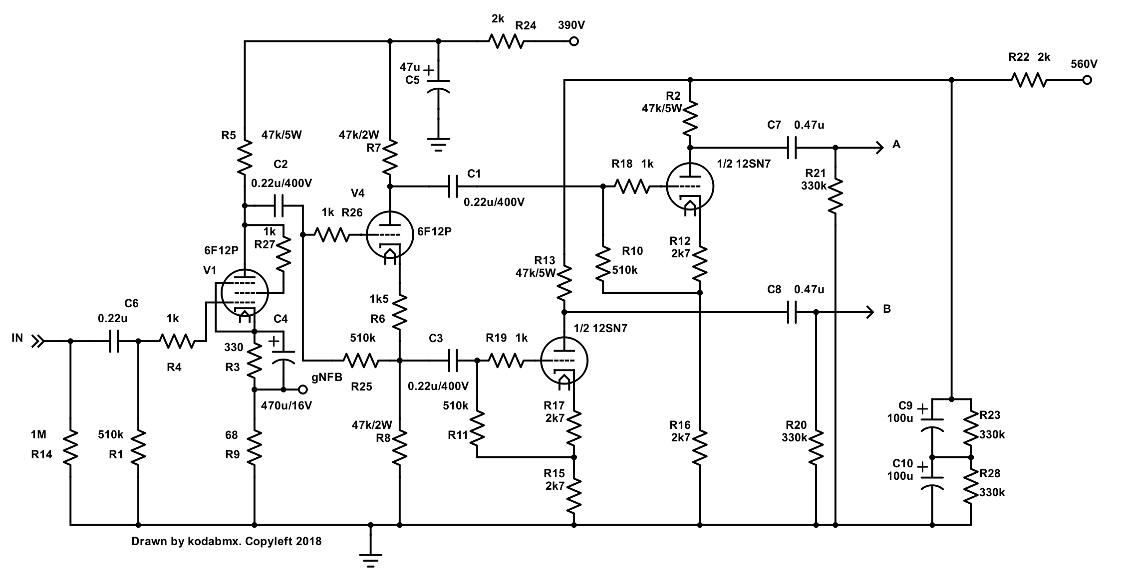

Ok, so since the 6P45S isn't terribly linear as a tetrode, I've decided to continue with triode connection with the following modification to the driver.
I've added a 12SN7 gain stage basically lifted from an RCA manual that used it to drive 6AS7G (100V swings).
I've like to hear ideas/suggestions before I actually build this, but at least it's a pretty easy addition.
Thanks!

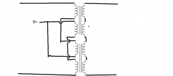

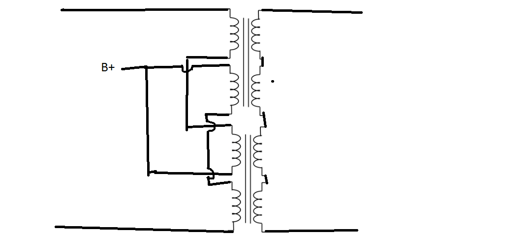

Since his design uses two transformers in parallel, I wonder if it would make more sense to connect them in series instead. It would certainly allow for a lot more headroom at low frequency, and I can't see much in the way of a down side. The ratio could be preserved by connection the secondaries in series too. This would give an allowable primary voltage of 480V at 50Hz before core saturation, and 240V at 25Hz, which is way more headroom than the previous 120V at 25Hz.

It's not different electrically from having them in parallel. Both transformers see both halves of the push pull signal and DC balances in both.. I think it should work much better than the parallel connection in this application, because it allows twice as much voltage at low frequency before core saturation.
If you used each transformer separately for the top and bottom push pull halves, and didn't wire it as I showed, then DC would not balance, and performance would be very poor.
