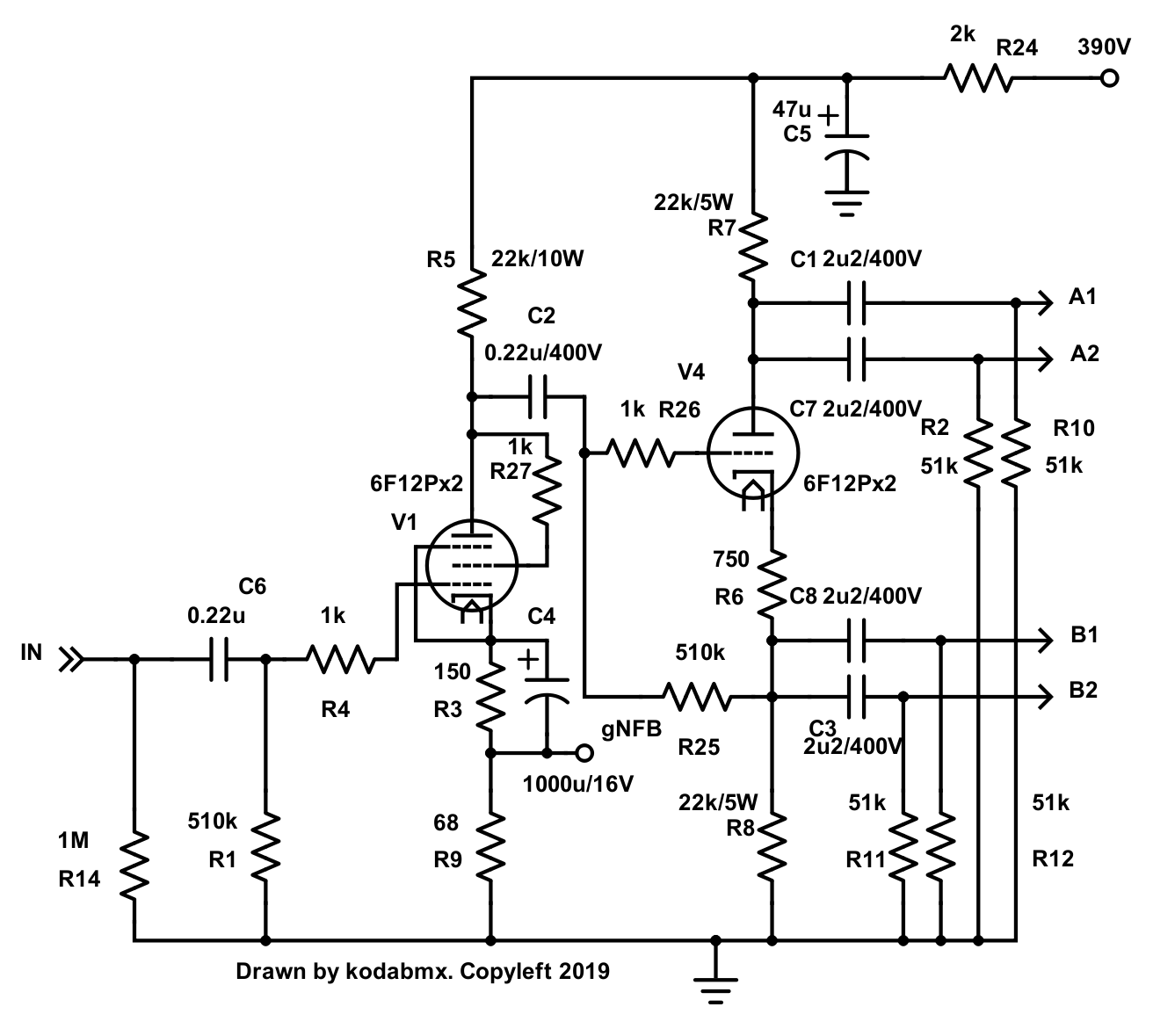

kodabmx Member Joined 2011 2019-08-14 5:34 pm #62 2019-08-14 5:34 pm #62 OK. One final tweak. gNFB is now 2k || 1000pf This makes the square wave response more accurate. Attachments 6F12P-12SN7-6P45S-monobloc.svg.png 156.7 KB · Views: 1,724 ••• More options Share
