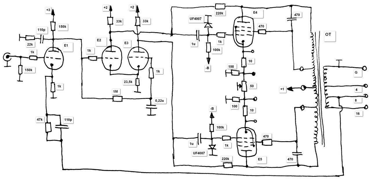

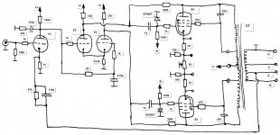

Decrease R4. but why would you want it without the global loop?
I was just trying to make it as low-distortion as possible before applying global NFB. Also, stability concerns. I'd rather not go crazy with little compensation caps, ferrite beads, etc.
As an option, 6AU6 for the first stage, 6AH6 for driver tubes. Nice cheap sleepers. Cheap 7-pin sockets. Also, 6AU6 triode strapped for Concertina.
All good ideas, of course.
Is 6AC7 basically identical in specs to 6AH6? If so, is there a problem using those? I have a bunch of them.
I have plenty of 6AU6, but no 6AH6 in my collection.
Or Soviet 6J4P for the first stage, 6J5P for the rest. Even cheaper, but still nice.
I'd use those if I had them. I do have some 6J51P (similar to EF184). Would those be useful as the LTP driver?

Yes, 6AH6 is a naked 6AC7. 6AU6 is a naked 6SJ7. And yes, you can use 6J51P too. It is a nice tube of later color TV era.

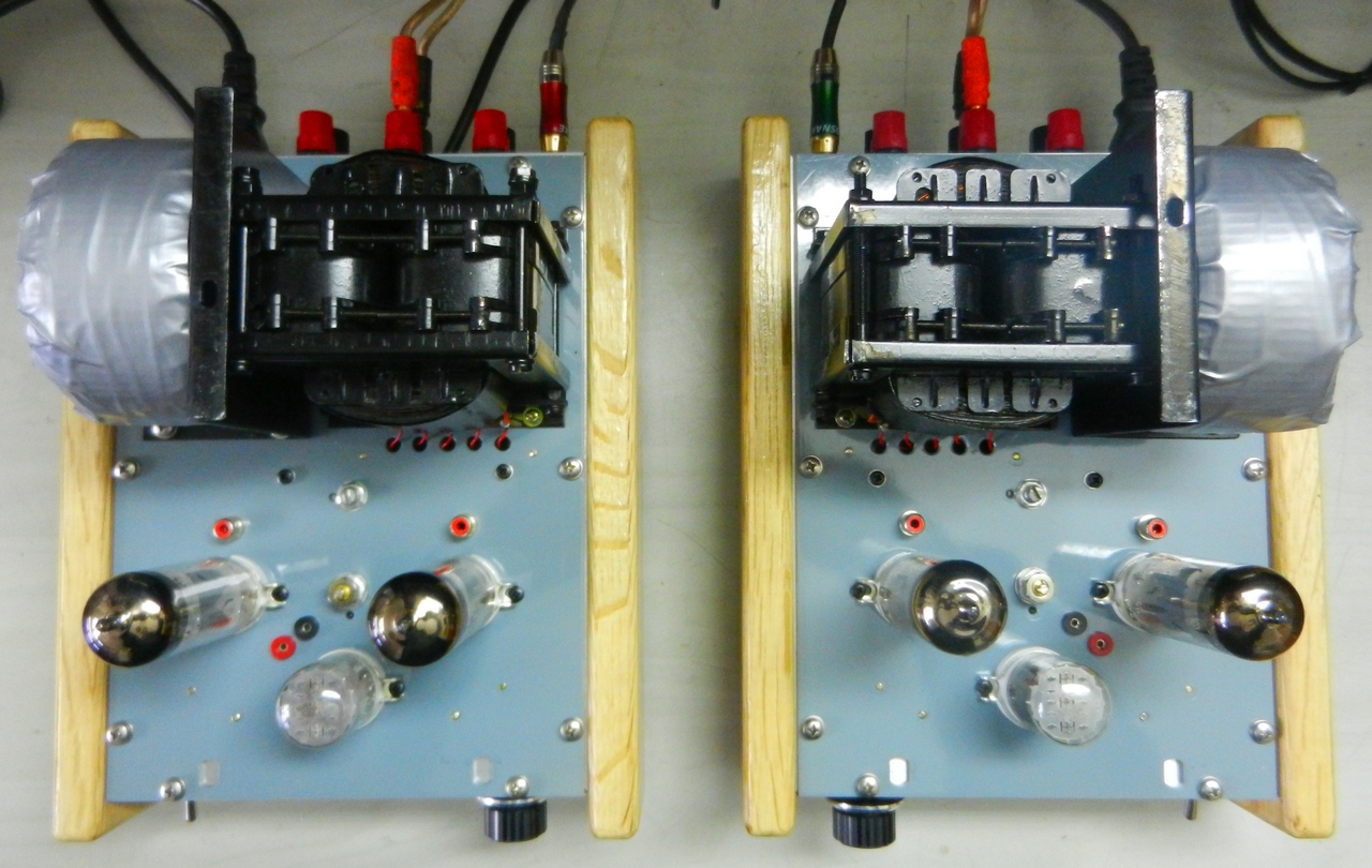

I've picked a Rowe-Ami recently and I modified it for use in hifi with a couple of 7591 and I enjoyed working on this device.
I bought a second that I want to mount in 6l6 or 6p3S-e and i'm looking for a simple schema, clean and stable for this new amp, but I seek above all to learn and understand.
So you want re-wire the Rowe-Ami for octal tubes? Wouldn’t that affect the look of the unit too much?

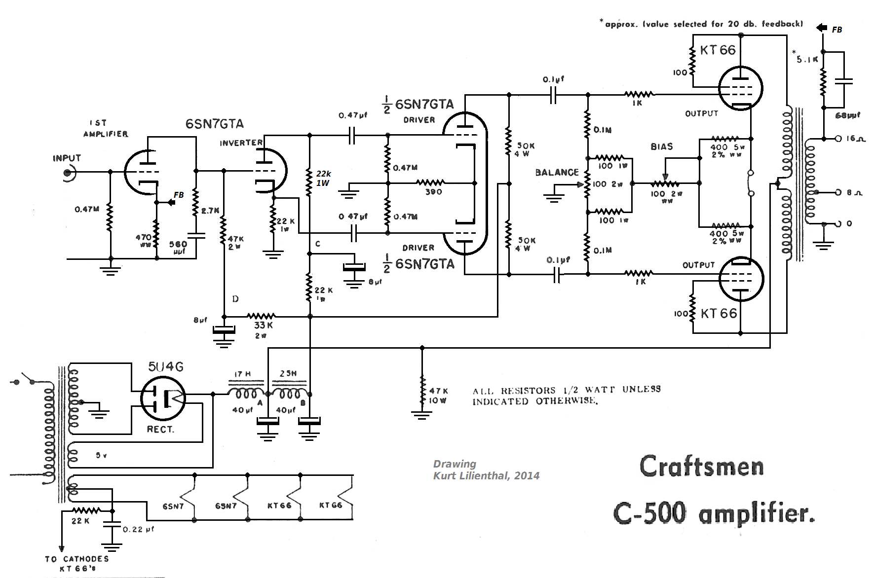

I see, since the tube characteristics are different, you may need to change the drive circuit and/or the feedback network, but it should be pretty straight forward. The last schematic that you posted requires another tube to be added, which is probably too much work, so you might as well start with the original Rowe-Ami design and make some changes.

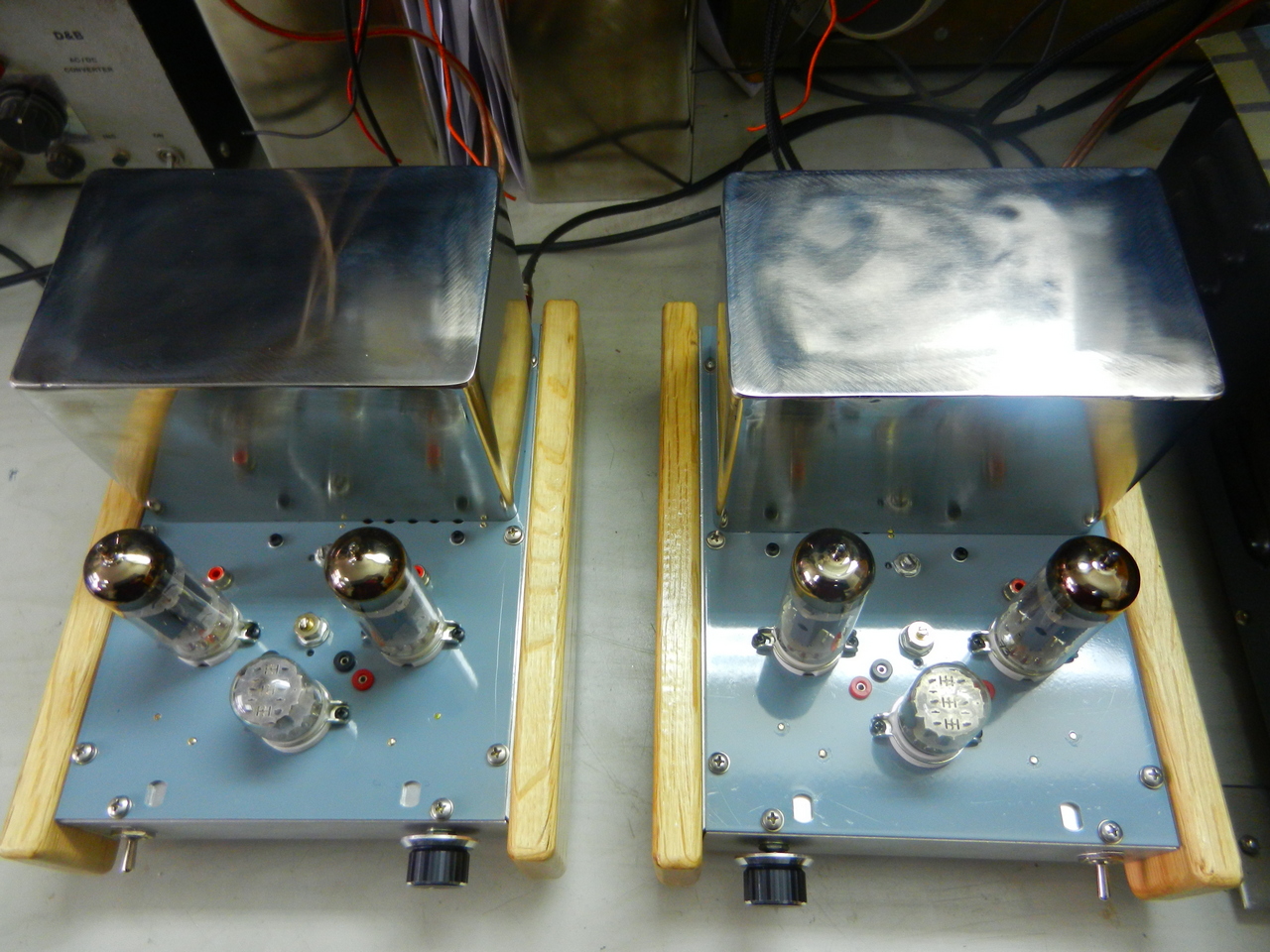

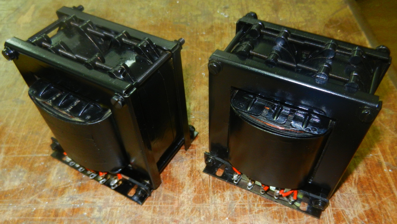

Monoblocks based on 2x6P41S and 6U10 in UL push-pull output amplifier with Pout more than 15W (~22W at start of clipping!).

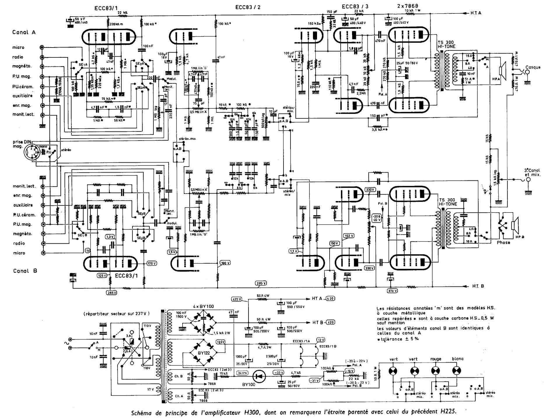

The Craftmen is indeed a good design, but it would require adding two more tubes and lots of re-wiring.I think I found the winner 🙂
