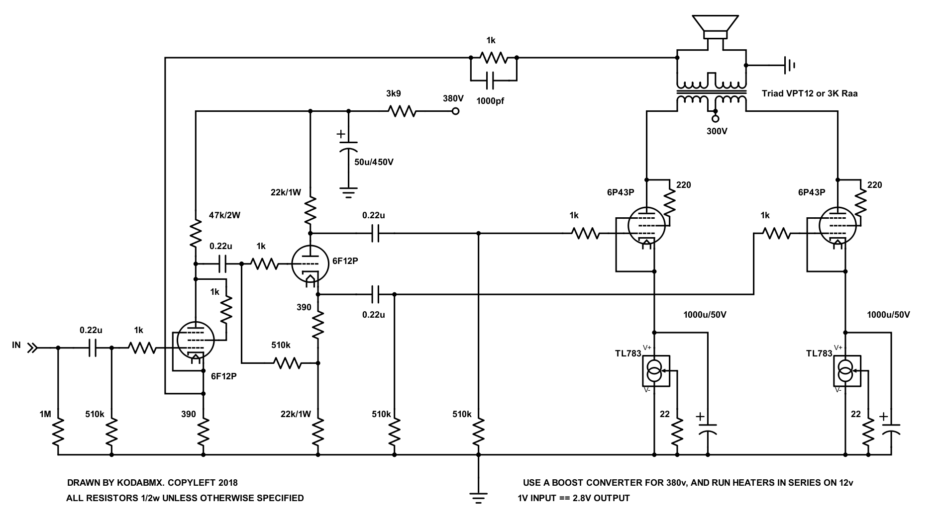

huggygood; tube stages are so straightforward that I am always too lazy to draw them out in full-I normally just scribble down any semiconductor support circuitry, equalisation circuitry, etc as well as looking at the anode curves and making a note of my operating points. As I said, if you look at any of kodabmx's recent schematics, these can easily be adapted for 6P41S. From memory, I used a HT of 290V with the grids at ground potential and individual AC coupled current sinks returned to a negative supply providing 45 mA per triode connected tube. I used another Russian tube, 6Zh51P as the (differential as well) driver at about 8 mA. Because very little power was required for the large Tannoy Lancaster speakers I used a mains toroid with 6V secondary windings in parallel. The sound was deemed acceptable without GNF. You will probably want more power and will need feedback. kodabmx seems to be building an amp like this every few weeks, so you should check his posts.
Yes, like that; good use of 6F12P, I must say. I'm not familiar with 6P43P but I think it's a fairly low impedance tube. You could probably substitute 6P41S directly with some loss of gain (50%?) and increase the current somewhat. kodabmx will likely chime in.

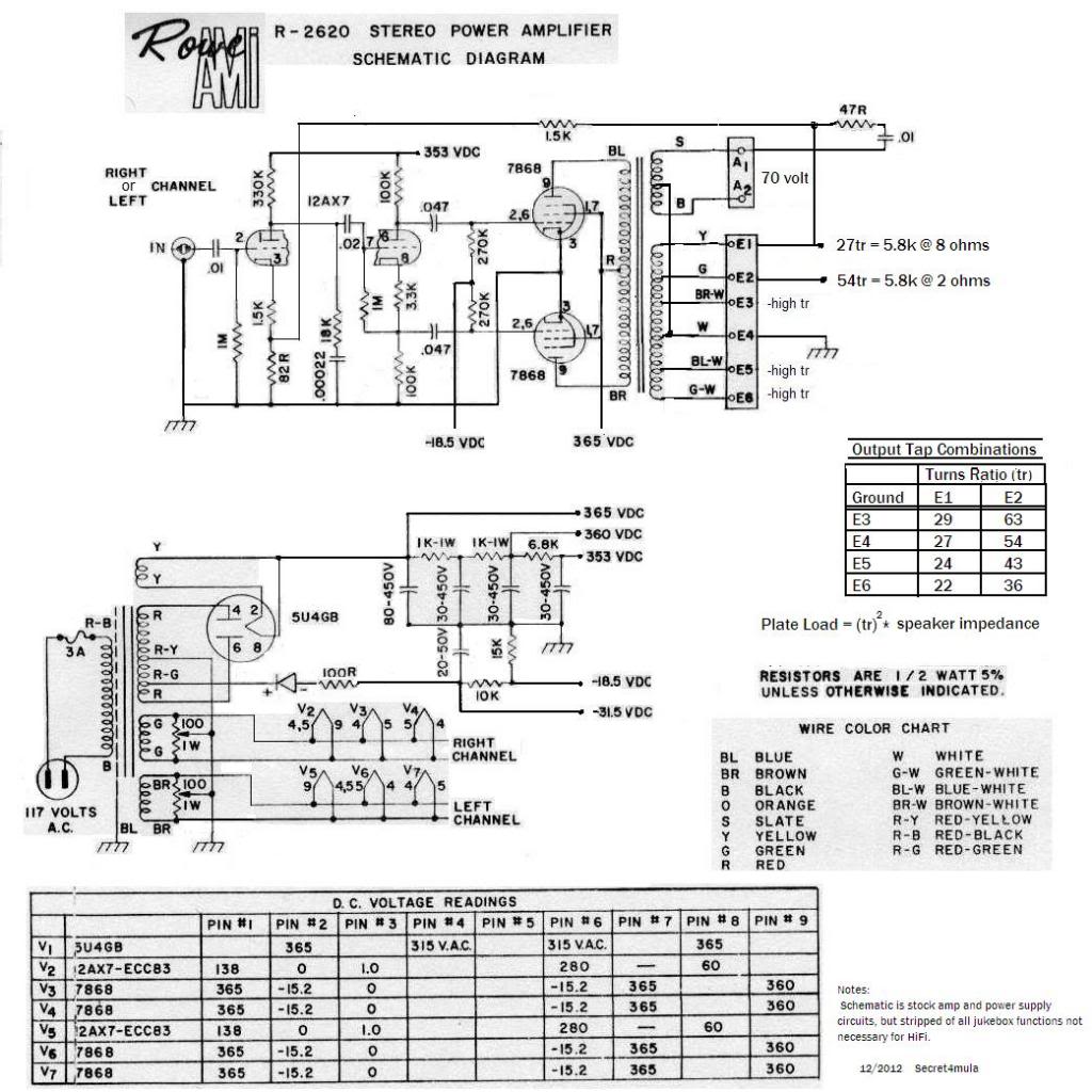

i'm ready to convert a new ami/rowe r4359 to 6p3s-e
I will probably need help to increase the voltage gain of the inverter stage
because of the difference in gain between 7591 7868 and 6p3s-e.
if it amuses someone to come play with me, I'm interested
i have all schematics for this amp

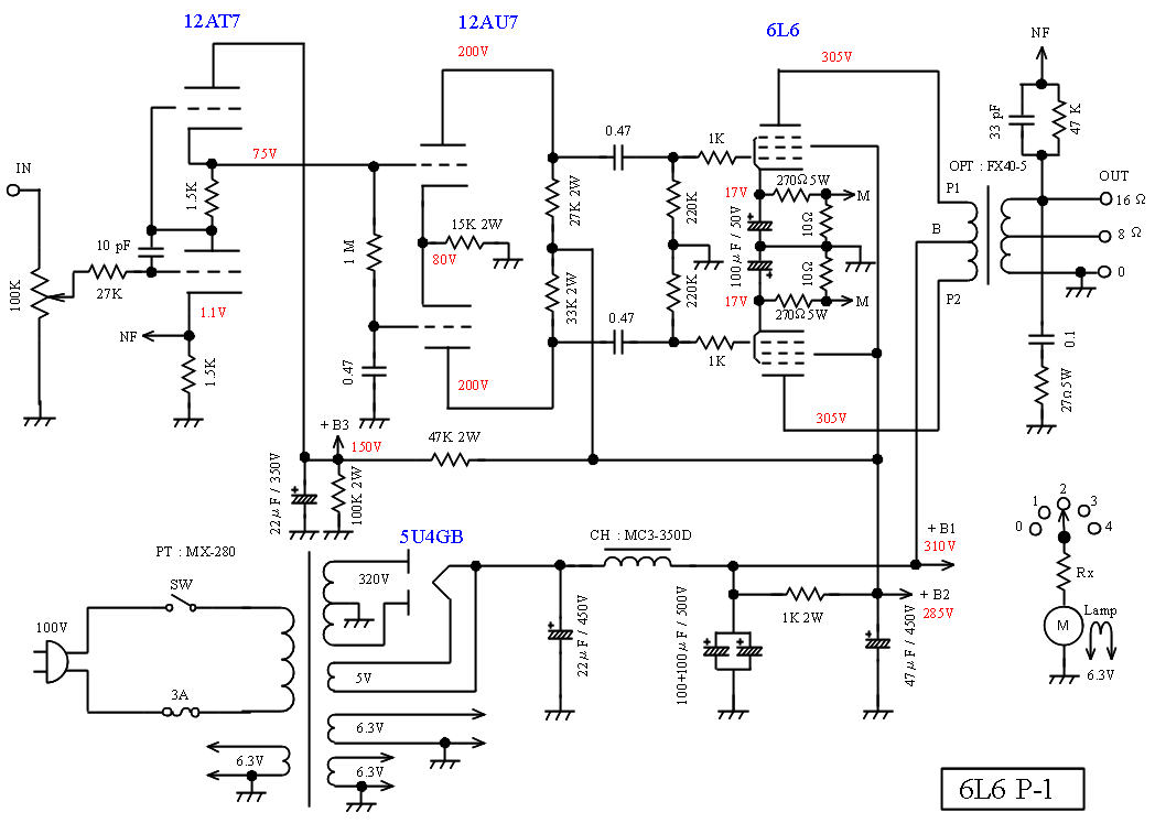

would any of you have a nice 6l6gc scheme to suggest?
the base (for power supply and opt 6.6k)

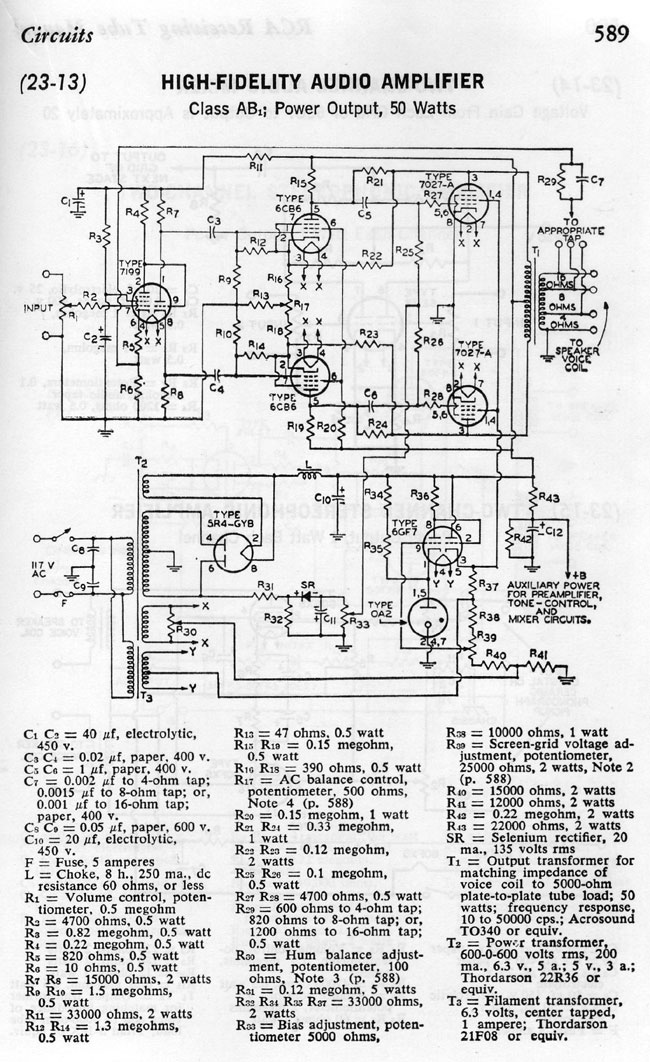

I'm told this is an excellent design, from the RCA tube manuals of the late 1950s.
I put a simplified version of this circuit into LTspice, using 6L6GC instead of 7027A, a model for a Dynaco A-470 OPT, and a simpler 6SN7 cathodyne front end instead of the 7199 used here. I also used 6AC7 pentodes for the LTP, instead of 6CB6. The result was very promising. I think this could be a very good amplifier design.
The only problem I found was that it has too-high input sensitivity without a global NFB loop applied (with only the local feedback loops). I got 44mA to 1 watt output.
I'm looking at some RCA schemes and there are some that are simple and effective
but I'm looking for something more modern.
what annoys me is that I do not know simulations, I am forced to look for tried schemas and known as being musical and stable.
I'm just looking for a thin, full-bodied and with a medium a little forward for the voices.
thank you for your help
Decrease R4. but why would you want it without the global loop?
