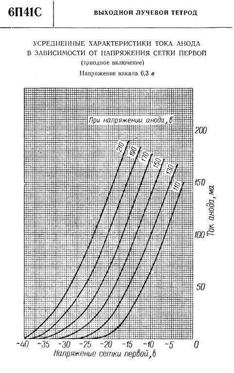

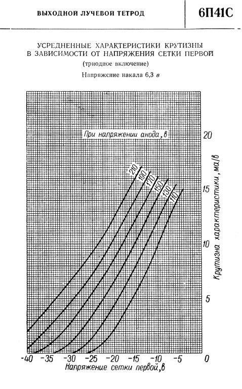

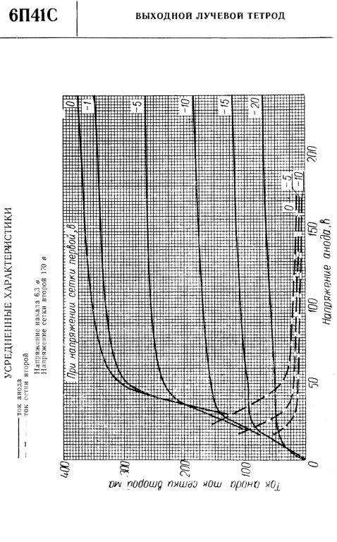

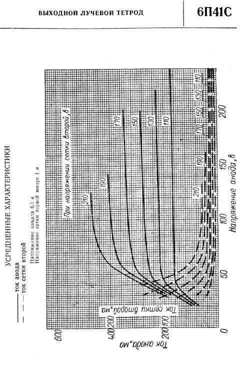

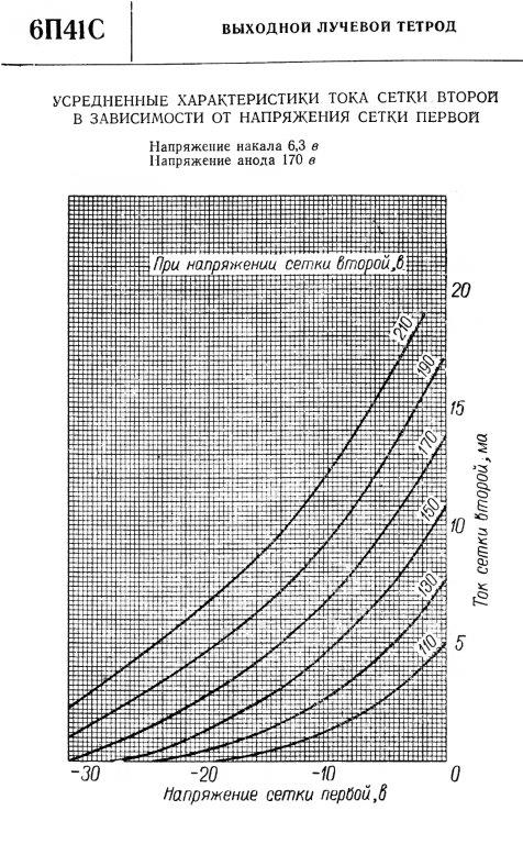

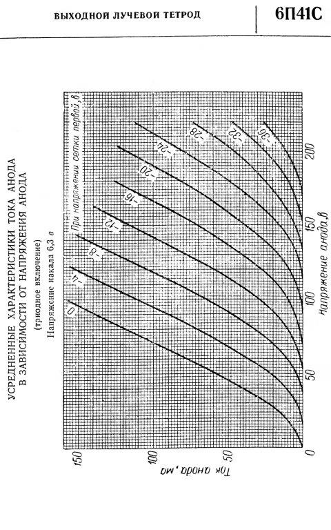

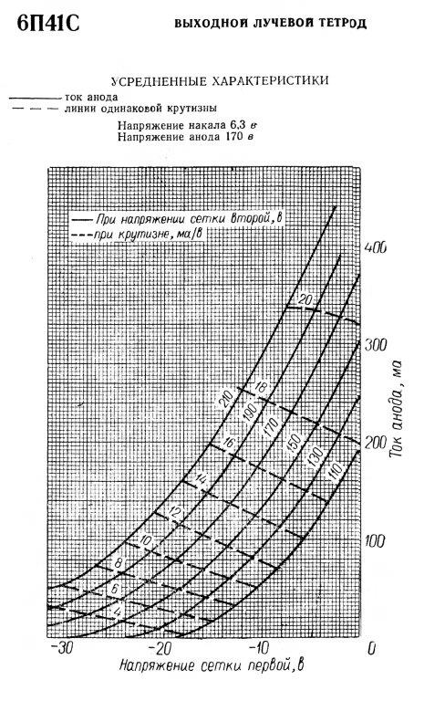

Original files:Are there available any datasheets for these 6P41S? Frank doesn't appear to have them handy...
Best regards!
Some curves:

Some curves:
Thanks, Davorin!
Now I'm about to find someone to teach me the Russian language 😛.
Best regards!
I intend to try the 6P41s some time to see what I can squeeze out of them.

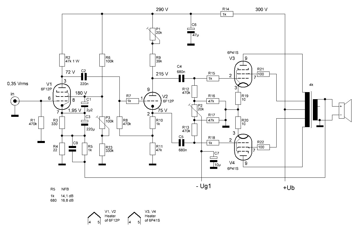

I done some tests with 6P41S as a PP-amplifier. Here are results with 40% UL, triode connected and pentode connected with different operating conditions.
Attached is also the schematic of the test circuit. All measurements were done without GNFB.

It would work fine as pentode connected, definitely not as UL.
As you can see from the test results I showed earlier, with 400 V +Ub, 180 V as +Ug2 and -30 V as Ug1, 6P41S works really fine.
Some 55 W is available.
