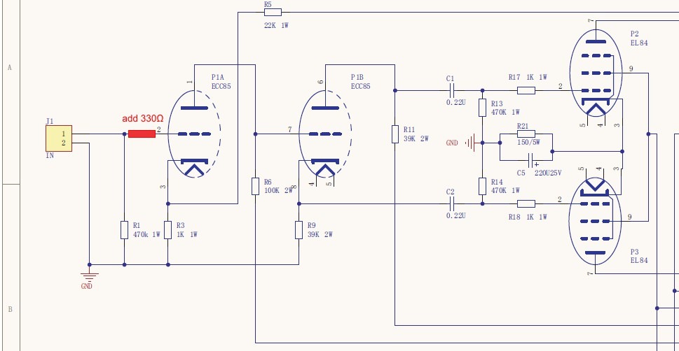

Why exactly are we supposed to add a 330Ω resistor to the left and right inputs as xraytonyb recommended? How big a problem is this in the real world? I can't remember ever setting a volume control to zero, when xraytonyb said there might be a problem, much less leaving it at zero for very long. I simply turn it off or stop the source playing instead. In fact, I tend to leave it at exactly the same comfortable volume so I don't have to get off the couch to adjust it all the time.
Is this only an issue if the volume pot stays at zero for a period of time? If it's not at zero, I believe xratonyb said the pot would provide sufficient resistance on its own? The kit has been sold this way for 5 years and not changed, so I am wondering why we are adding another component directly in the signal path?

Which resistors exactly were you referring to? I didn't find any in the schematics.
They are not there. Xraytonyb said to add them. See attached for clarification of where he said to put them.

Oh, the resistors as suggested do the same thing as those in the EL84 grids. They prevent possible oscillations. Anyway, as an ECC85 triode doesn't show a transconductance as high as the EL84's, they aren't really needed.
Excellent. Xraytonyb said as long as the pot wasn't at zero, there would be no problem. So, I think I'll take that route. I would never turn it all the way down anyway. I'd just hit stop or pause on the CD.

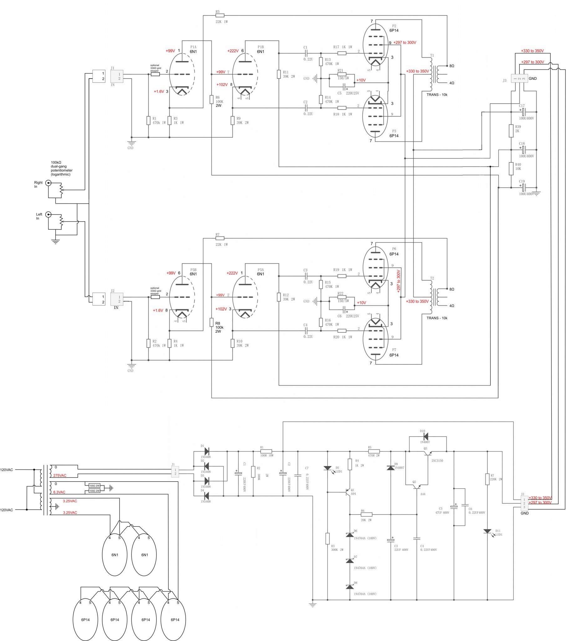

As a novice just getting back into this after many years, I wanted to see the entire schematic all in one place. Does this look correct? The voltages in red are the ones specified in the directions.
Also - is anyone but me concerned about running the 6P14 or EL84 output tubes at 300 volts, which appears to be the maximum voltage for both tubes? Isn't this going to just eat up the tubes very quickly? I don't want that. The kit comes with what is labeled a "spare" zener diode that is 91 volts per the label instead of 100 volts. That's in there to reduce this voltage, correct?

I hope that I have the combined schematic in the previous post correct.

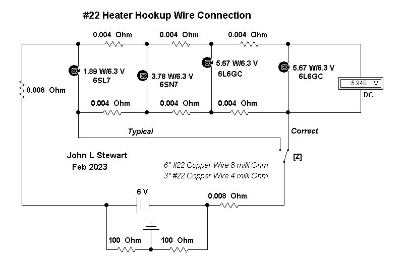

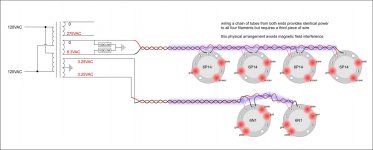

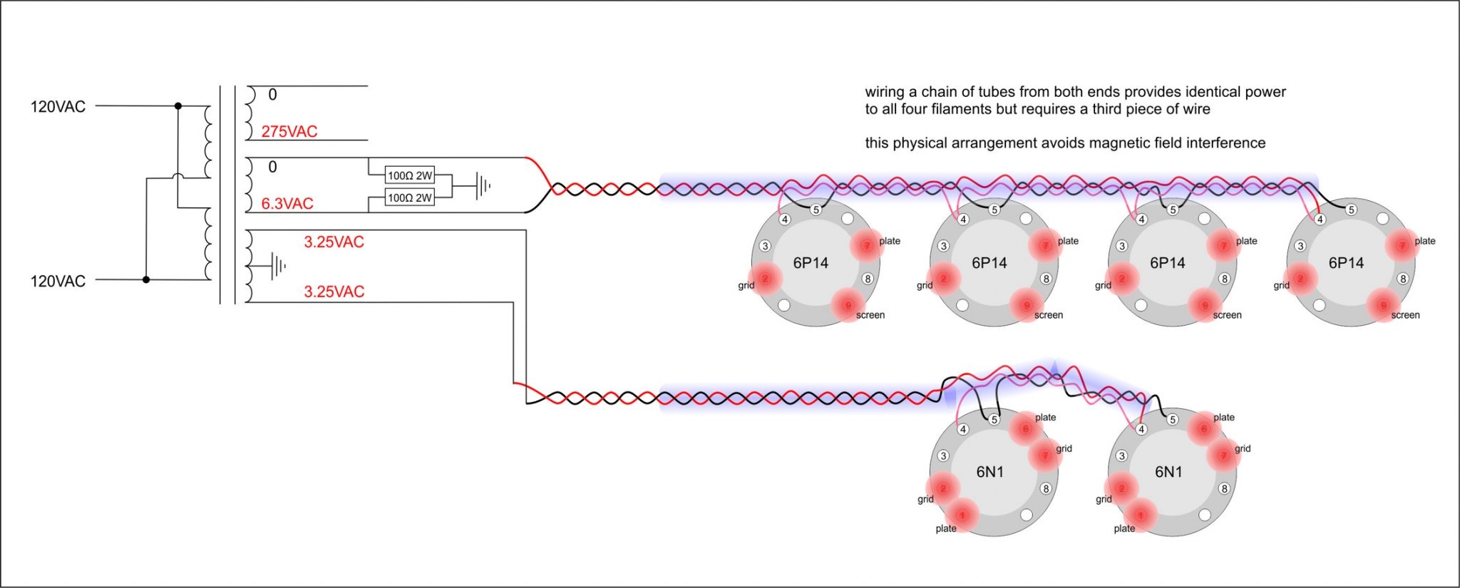

Does anyone disagree with this filament wiring arrangement? It's the best I can come up with based on comments I have found online and a YouTube video about routing the wires. It involves running one wire to the near end of a chain of tubes, and the other wire runs to the far end of the chain of tubes and then comes back.
There's no reason to use a third wire.
I'll see if I can find the sources of that info again. They might have been on this forum. I actually saw it more than one place. In theory, wiring them the "normal" way results in less power arriving at the last tube in the chain. Routing one wire to each end and then running one back would solve that problem, if it's real. Can't believe everything you read, but it makes sense. Diagram attached showing the resistance that the wires would add. He assumes 22 AWG wire, which is what came with the kit. I suppose the problem would be virtually eliminated with heavier wire. I do have 20 AWG, and I was planning to use it. I don't think I have any 18 AWG.
Yes, I know about the twisting, but according to this video it still can be a problem (timestamped):
Good video. It shows that the untwisted part of the wiring causes issues, and is without a third wire.

Perhaps I haven't been clear. I have two totally different questions:
- The routing and twisting - the video seems pretty clear about that unless it's wrong.
- Whether it is a valuable approach to wire a string of tubes from both ends per the schematic attached, which would require three wires to do assuming the filament wires for all four tubes run down one side of the amplifier. If using 22 AWG wire, it appears that the last tube in the string gets significantly less power to the filament unless the "correct" approach in the schematic is used.
