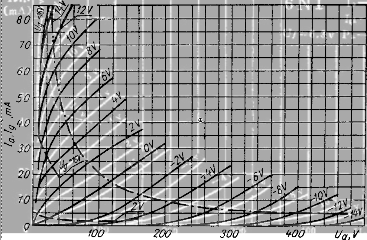

Some, mostly eBay sellers, would have you believe that the Russian 6N1P is similar to and a drop-in replacement for the 6DJ8 family of tubes. IT IS NOT!
Yes, I found that out with some research. 6DJ8 may or may not work in some applications, but it is not a good idea unless specifically recommended by a manufacturer.
Research on the Chinese 6N1:
- Supposedly 6N1 (China) = ECC85 = 6AQ8 (NOT 6DJ8). The amplifier schematic and circuit board both say ECC85 on them. The kit comes with 6N1, which I suspect is being used as a cheaper substitute for the ECC85 and may not be an exact equivalent. The manufacturer of the amplifier kit recommends changing them to ECC85 for "better sound."
- Supposedly 6N1P (Russia) is not an exact replacement for 6N1. I don't know why.
- I found the actual data sheet for the 6N1 (China), but it's in Chinese. Can anyone here translate Chinese to English? I am asking a Chinese manufacturer if they can provide it in English.
Someone please see if you can perfect the attached Word document for the Chinese translated 6N1 specs. It is the best translation I can do for the actual 6N1 (China) - line by line with Google translate. Perhaps someone with knowledge of standard tube specs can help me finish the translation to English? Some values should be obvious to those with experience. The spec charts are in it along with numerical values. Also in the document are the Philips (1969) ECC85 and Russian 6N1P specs.
Thanks!
You won't get an accurate read on filament voltage until all tubes are in and B+ is applied (the PT is loaded down).
Yes, xraytonyb confused me on that a number of times.
The Russian 6N1P is, from all reports, nothing like Chinese 6N1.
I can't confirm those reports. I downloaded and partially translated the spec sheet for the Chinese 6N1 and am asking for help finishing the translation. The Word doc I posted earlier contains the actual specs for the 6N1, 6N1P, and ECC85 if someone can help perfect that document for everyone to use as reference/proof.

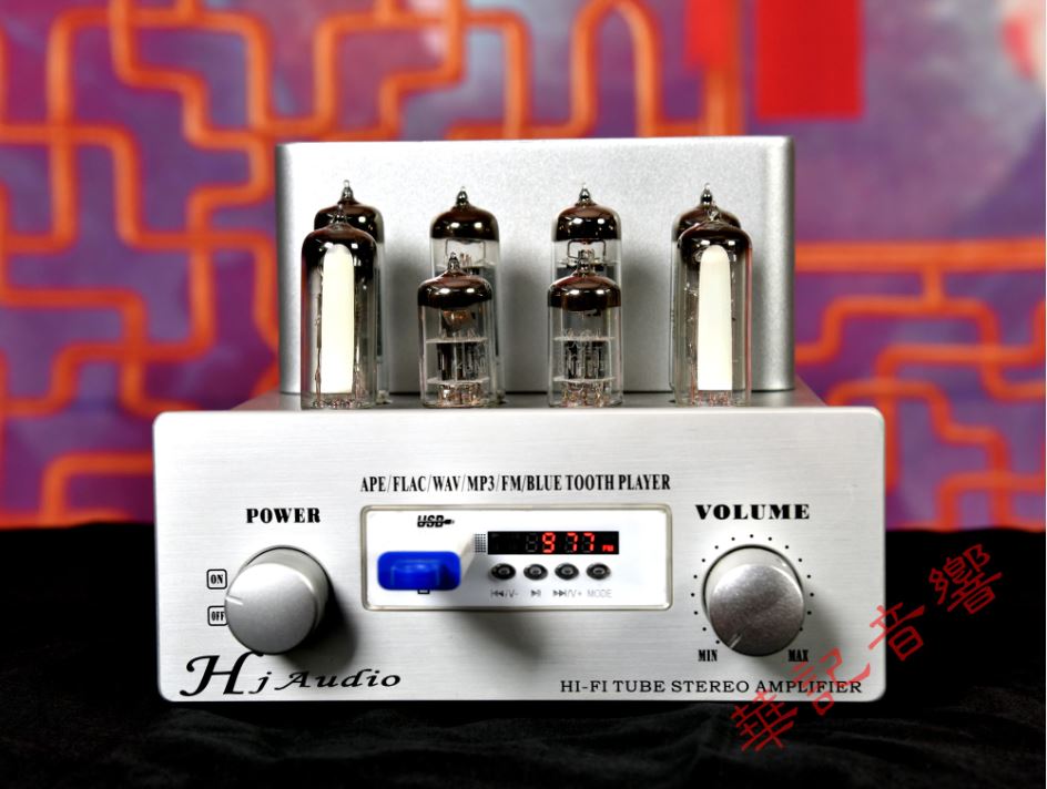

Not that I have any intention of buying this version, but they now offer the same kit with a USB port and bluetooth. I think it also has an FM tuner. I guess it would be convenient for someone who wants a tiny, tiny system, which I do, but not with bluetooth and USB inside my amplifier! That should be a separate box IMHO.

I've built this amplifier. Actually I've built two. I sold the first one, but regretted it and built a new that I have now. It may be a cottage industry product, but the quality of the parts are quite good. I don't think there should be any problem with tube rolling unless the tub unless one is very brutal while changing tubes.
The building instructions are very good and detailed and easy to follow with help from Google translate. The amplifier doesn't come with a loudness circuit anymore. I can send the instruction to anyone interested. Just PM me.
And, the amplifier sounds very good, so well worth the effort.
