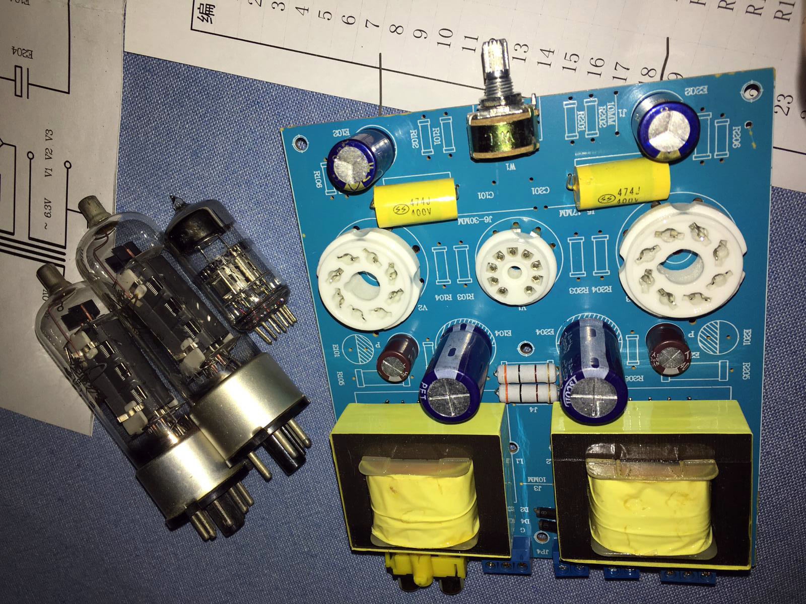

Thanks! No FB, OT - 4.7 kohm, Driver tube 12AD7-NEC. The sound is very close to 2A3. /It is PCB for EL34 from ebay and I modified for 6BQ6 and 12AD7/
Hi azazello,

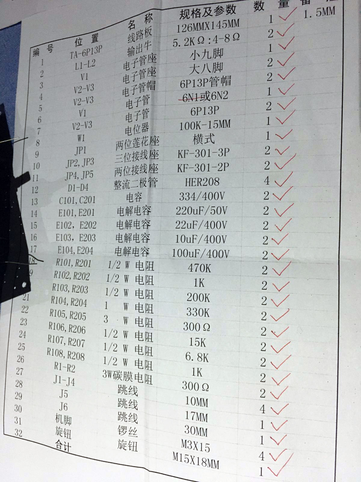

looking at the layout you have, the kit seems this one:
EL34 bordo amplificatore Single ended tubo kit scheda di amplificazione|Amplificatore| - AliExpress
May I ask you the working point of your system? or some more details you would like to share?

Thanks, that kit seems superior in terms of ripple reduction due to the mosfet on PS, and the cost is very low. PCB tracks seem quite weak, even considering that the photo used for the promo has one ring broken on preamp socket.
You can cut sec. grid output tube and connected it to B+ cross 33 kohm /for 6P31S, 6BQ6/. +U sec.grid must be around 160-180V.
They are indeed. This kit is intriguing because you get everything except the PT for less than 90 €. The other kit costs like 15 € and you are free to chose the OPTs you want, so let's say you don't waste money in OPTs you'll then probably upgrade.Some of those kits are incredibly cheap, so am following with interest how it pans out for you.
Thank you azazello!You can cut sec. grid output tube and connected it to B+ cross 33 kohm /for 6P31S, 6BQ6/. +U sec.grid must be around 160-180V.

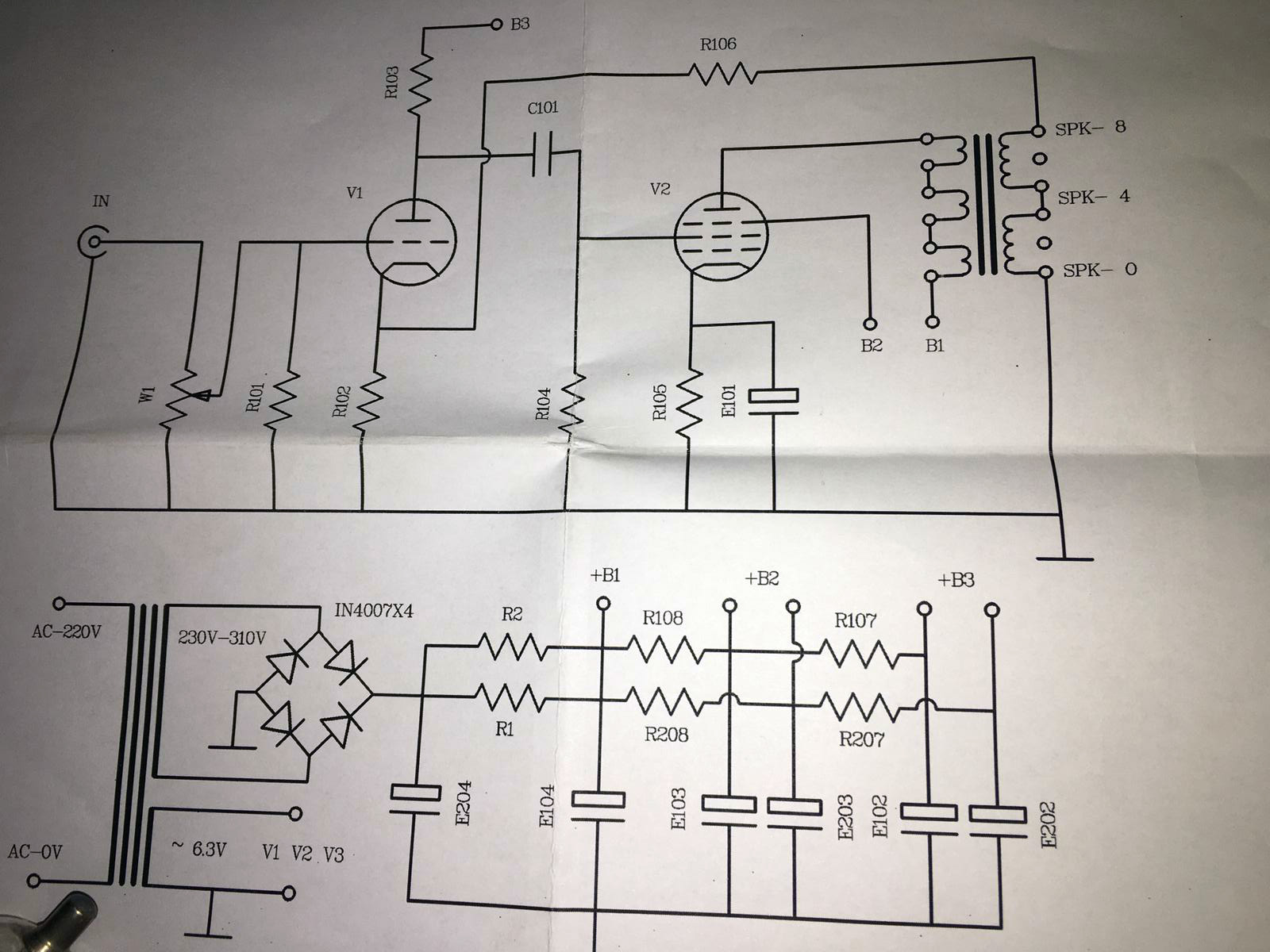

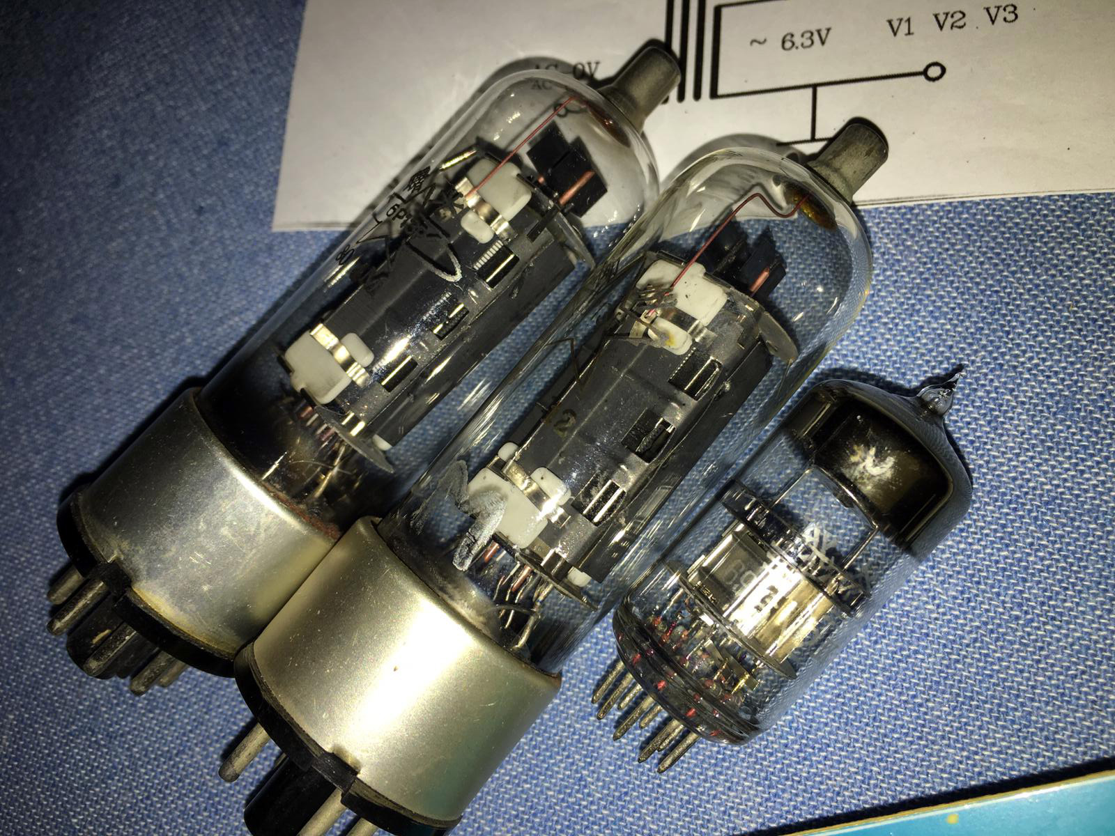

I had tested both 6P12P and 6P13P SE with Pentode mode and Triode mode. There are very high distortion appears when output power over 3W at Pentode mode. Triode mode is much better. and the maximum output power at load side is about 4.2W in my test.
Here the datasheet of the preamp tube: https://frank.pocnet.net/sheets/095/6/6N2.pdf

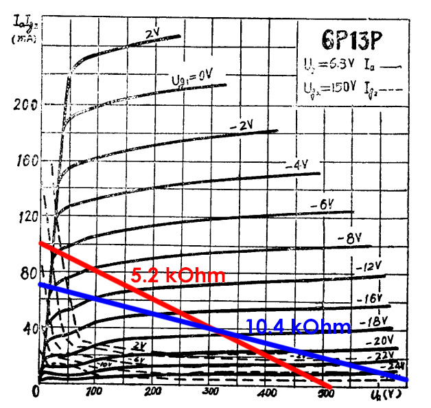

Looking at the curves of the output tube ( https://frank.pocnet.net/sheets/095/6/6P13P.pdf ) am I correct saying that I need around 60V on screens to hit g1=0 with a=50V with Ra=10k4 and working point at 300V 40mA?
I would like to connect a 8 Ohm speaker to the 4 Ohm tap, in order to get around 3 Wrms that should be handled by those small transformers.
A bit more can be obtained by working at 250V and 50mA with Ra=5k2 and hitting g1=0 at 50V and around 90 mA, but I think the output transformers would suffer.
In any case, the suggested voltage for the secondary voltage of the power supply seems a bit high to me (230 to 310 Vac means 310 to 420Vdc).
