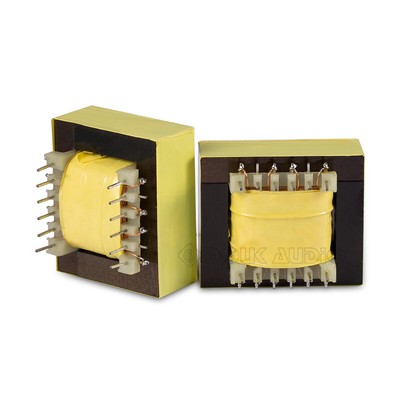

A small output transformer can be a mystery.
These are the only informations that I have by now.
Code:
1. Power: 3W
2. Frequency Response: 20z-30KHz (-2dB)
3. Core Specifications: EI48X24, core section X24MM
5. Primary Impedance: 5.5K Ω,
6. Secondary: 0-4-6-8 Ω and UV level meter use
7. Primary Inductance: 11H
8. Primary resistance: 278Ω
9. The primary current: 70MA
10. Grade resistance: 2.3 Ω
11. Weight: 0.6kg / pcs
By looking at this photo, I would say it is interleaved P-S-P-S-P.It certainly has limited laminations, can saturate early.
The primary and secondary may, or may not be interleaved.

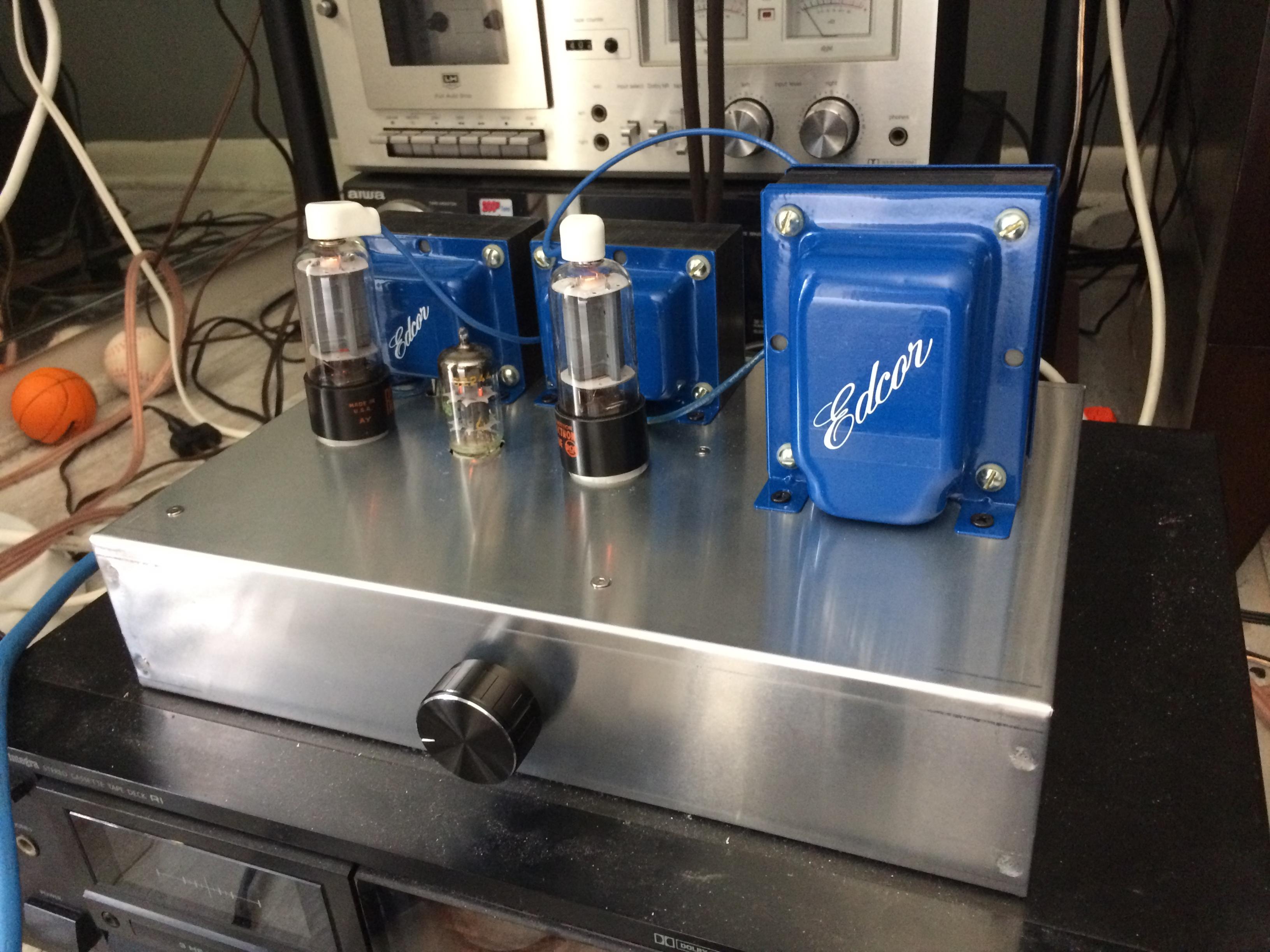

The current project is a Hi Fi SE stereo amp with 6P13S output tubes. I talked about guitar amps because I've built many of them, most of them under my design, but there the purpose is very different.You mentioned getting the sound you wanted for a Guitar amp. Is the current project for a Guitar amp? Or, is it for a Hi Fi amp.

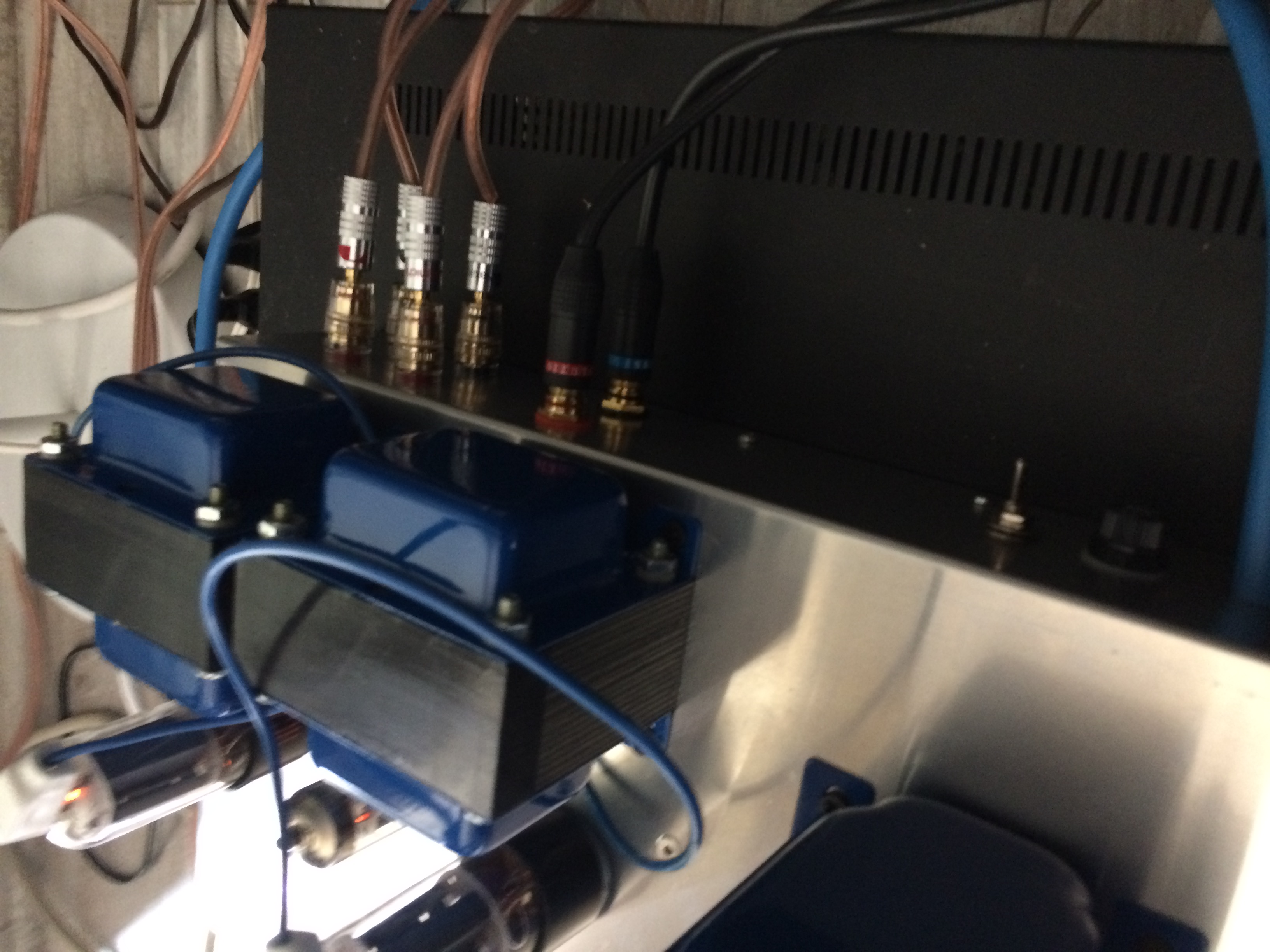

/this is my SE 6BQ6 /6П31С/. If second grid is with 200 V, sounding is more sharp. I use about 170 V/. The sound is very close to 2A3.
Thank you azazello, but I have 6П13С/6P13S tubes. I won't expect more than 5 Wrms with good OPTs, so way less with the included ones.this is my SE 6BQ6 /6П31С/.
You can use 6P13S with Pa about 17-18 W /not 12-13 acc. specification/, without problems. For good sounding tube current no 40-50 ma, but 60-65 ma with U about 260-300 V. /65 ma with 260 V, and 60 ma with 280-300 V/. 6P13S and 6P31S are almost the same with 2 different legs.

The OPTs I've receipt are declared as 5.2 kOhm and 0-4-8 Ohm.
I'm thinking to supply it through a dcdc converter first for B+ and use fixed bias.
I think the working point will be around 270-280Vdc with 45-50 mA at idle.
I will also use a dedicated variable voltage power sepply for screens, in order to find the best one, then fix it with one (or two in series) zeners from cathode to screens.
What do you think?
