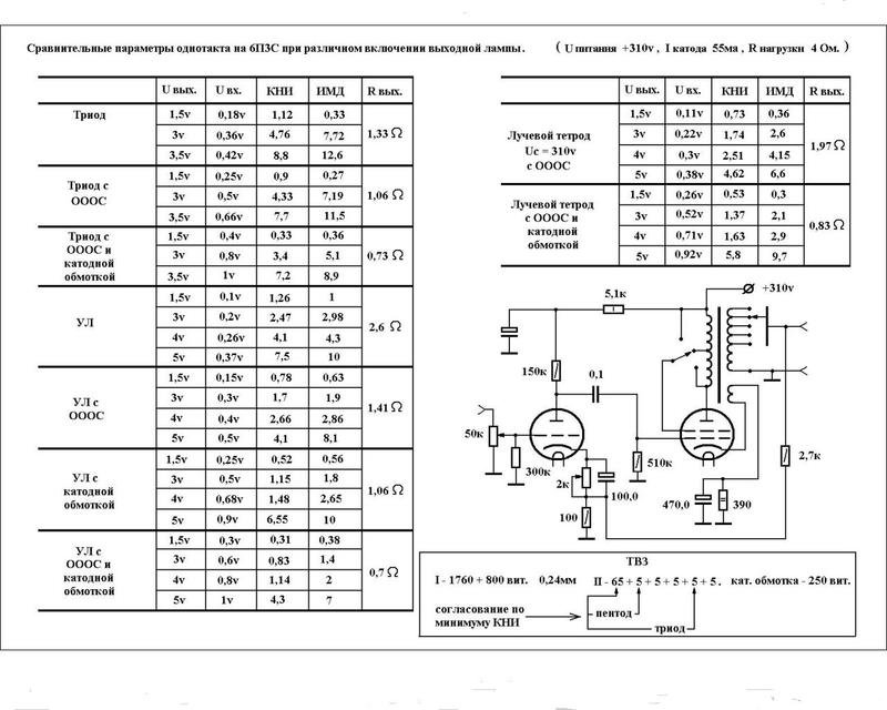

Very nice looking amplifier!
Simple, Clean, and nothing in the way of being able to 'show off' the tubes.
Did you use any negative feedback?
What kind(s)?
What is the Primary impedance of your output transformers?
What is the driver tube type?

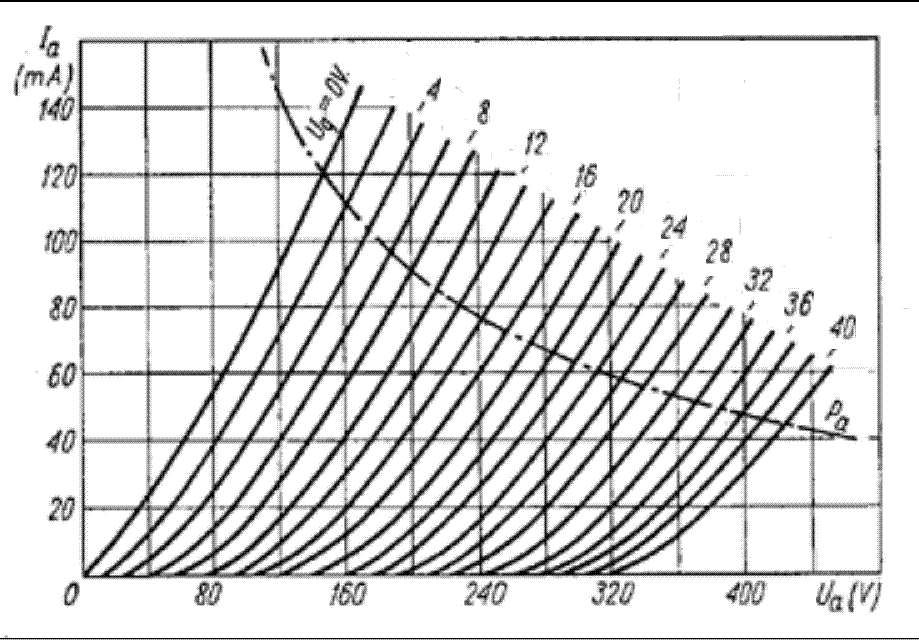

Here the datasheet of the preamp tube: https://frank.pocnet.net/sheets/095/6/6N2.pdf

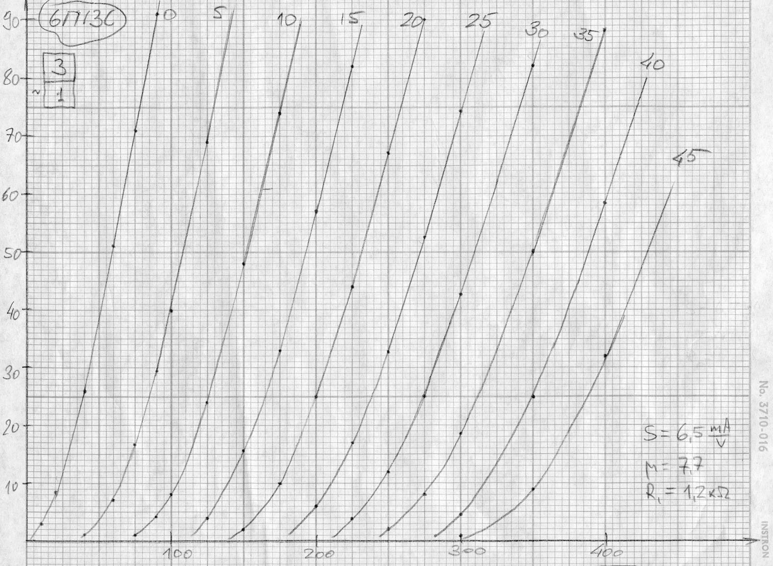

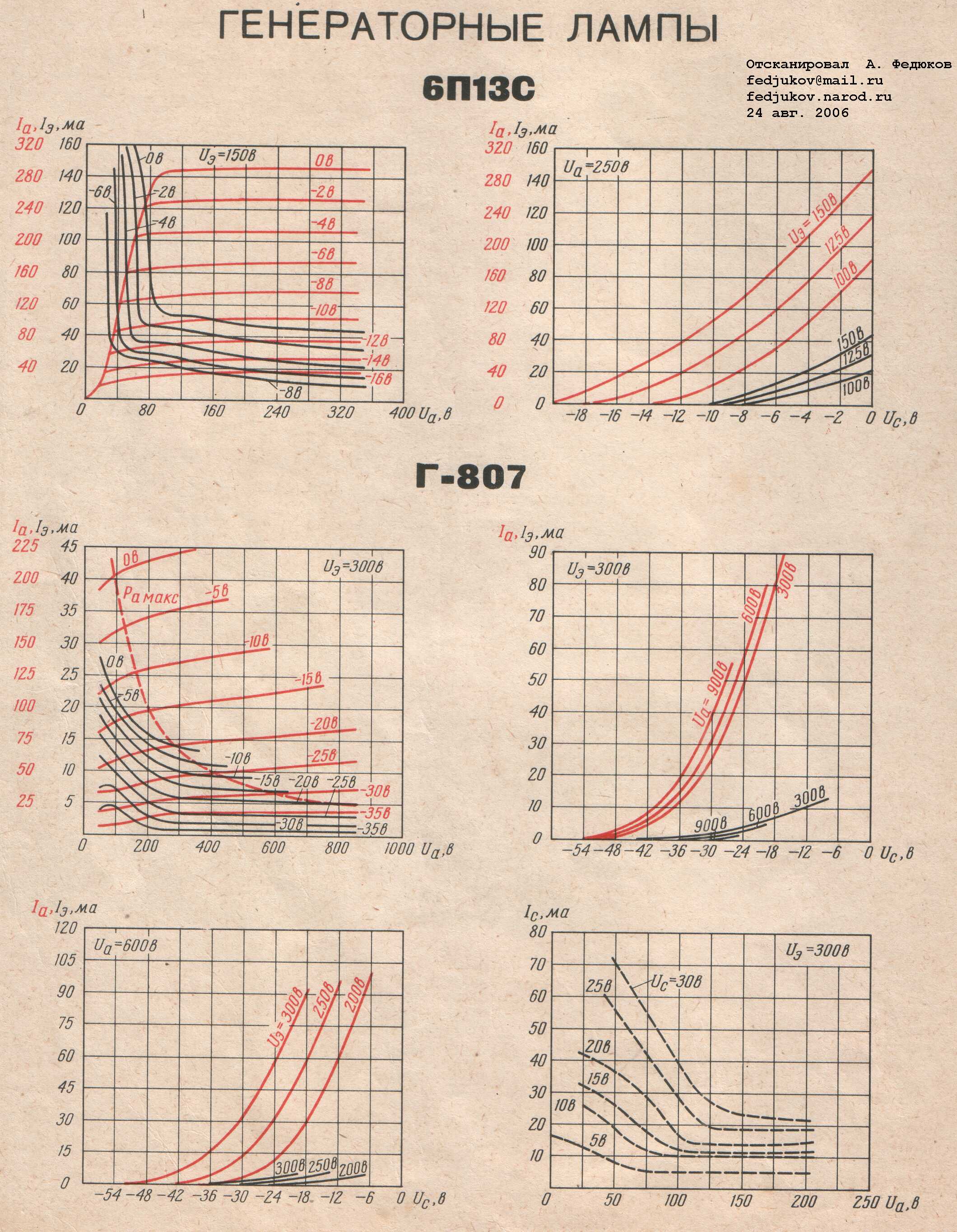

Looking at the curves of the output tube ( https://frank.pocnet.net/sheets/095/6/6P13P.pdf ) am I correct saying that I need around 60V on screens to hit g1=0 with a=50V with Ra=10k4 and working point at 300V 40mA?
I would like to connect a 8 Ohm speaker to the 4 Ohm tap, in order to get around 3 Wrms that should be handled by those small transformers.
A bit more can be obtained by working at 250V and 50mA with Ra=5k2 and hitting g1=0 at 50V and around 90 mA, but I think the output transformers would suffer.
In any case, the suggested voltage for the secondary voltage of the power supply seems a bit high to me (230 to 310 Vac means 310 to 420Vdc).
