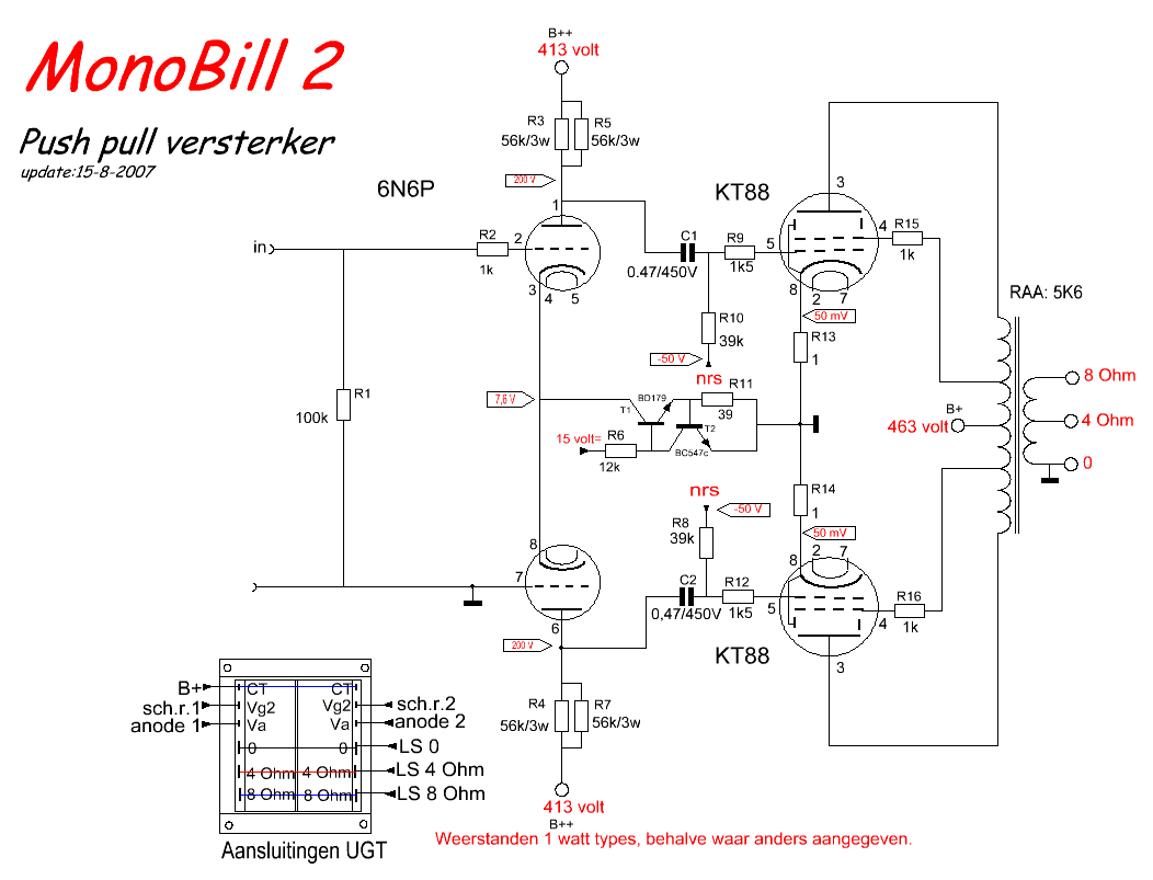

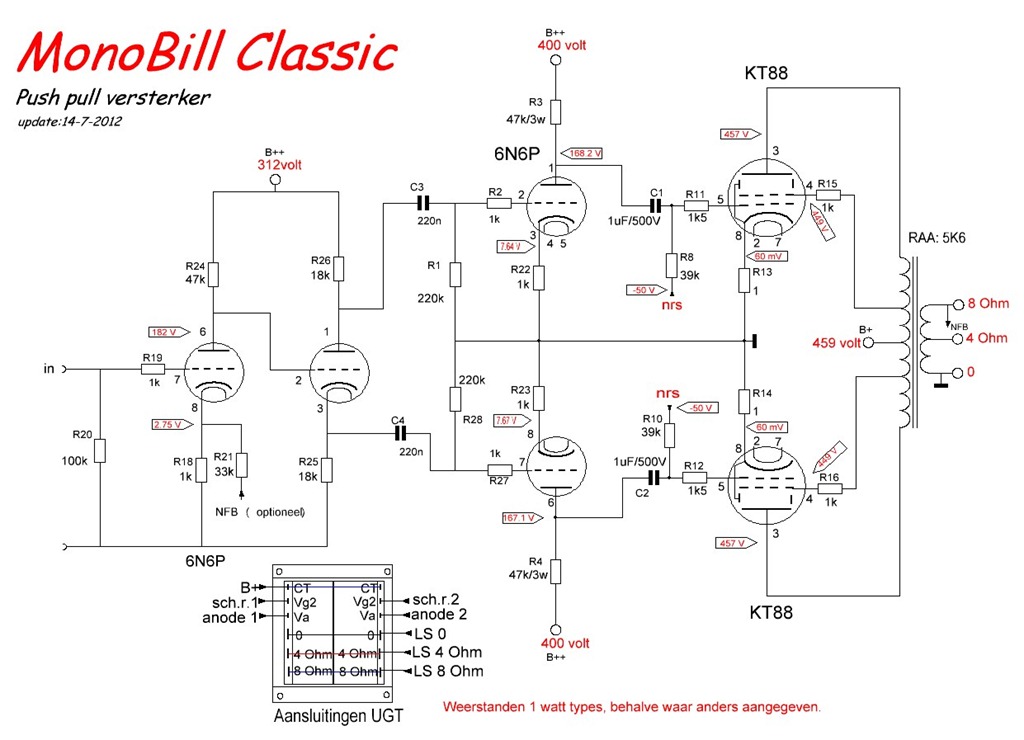

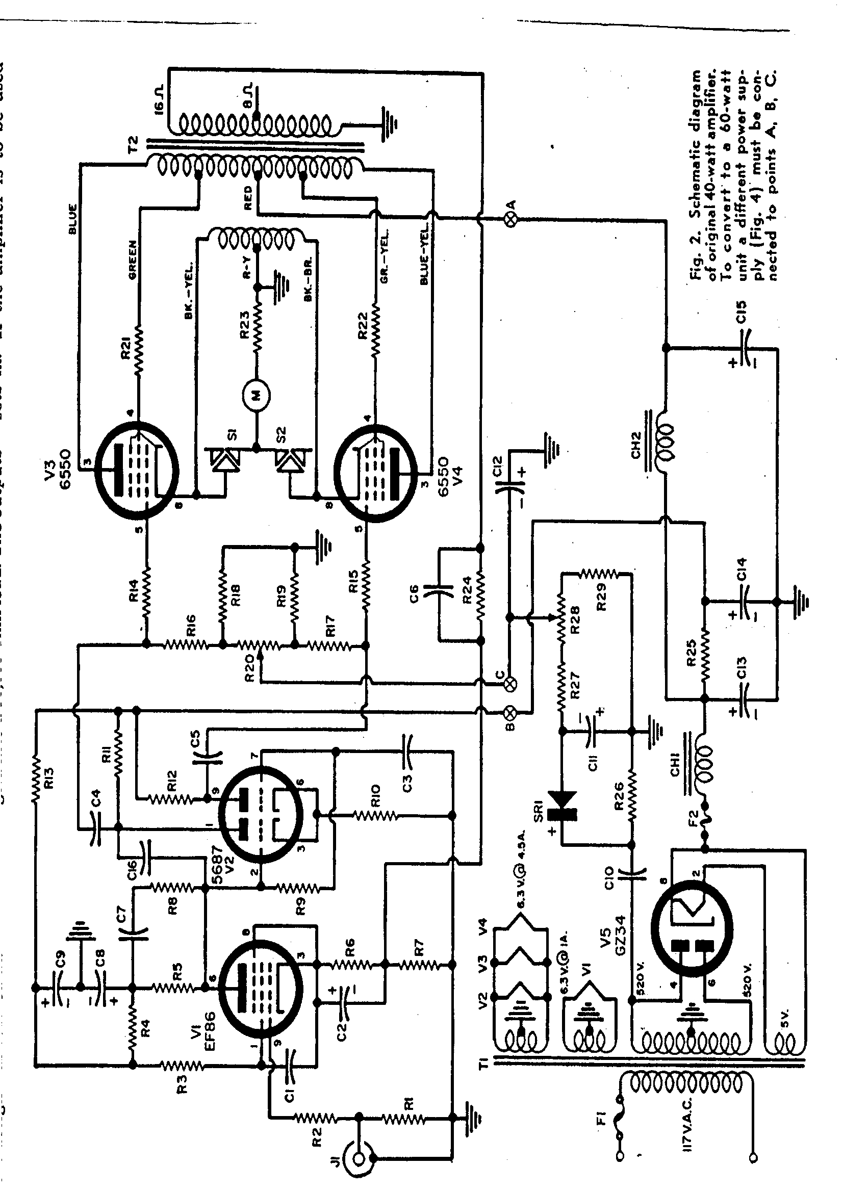

Hi
I found this amplifier by Triode dick using 6N6. and also an older design using a 5687.
I am thinking of building Triode dicks version with 6N6.
Phil
