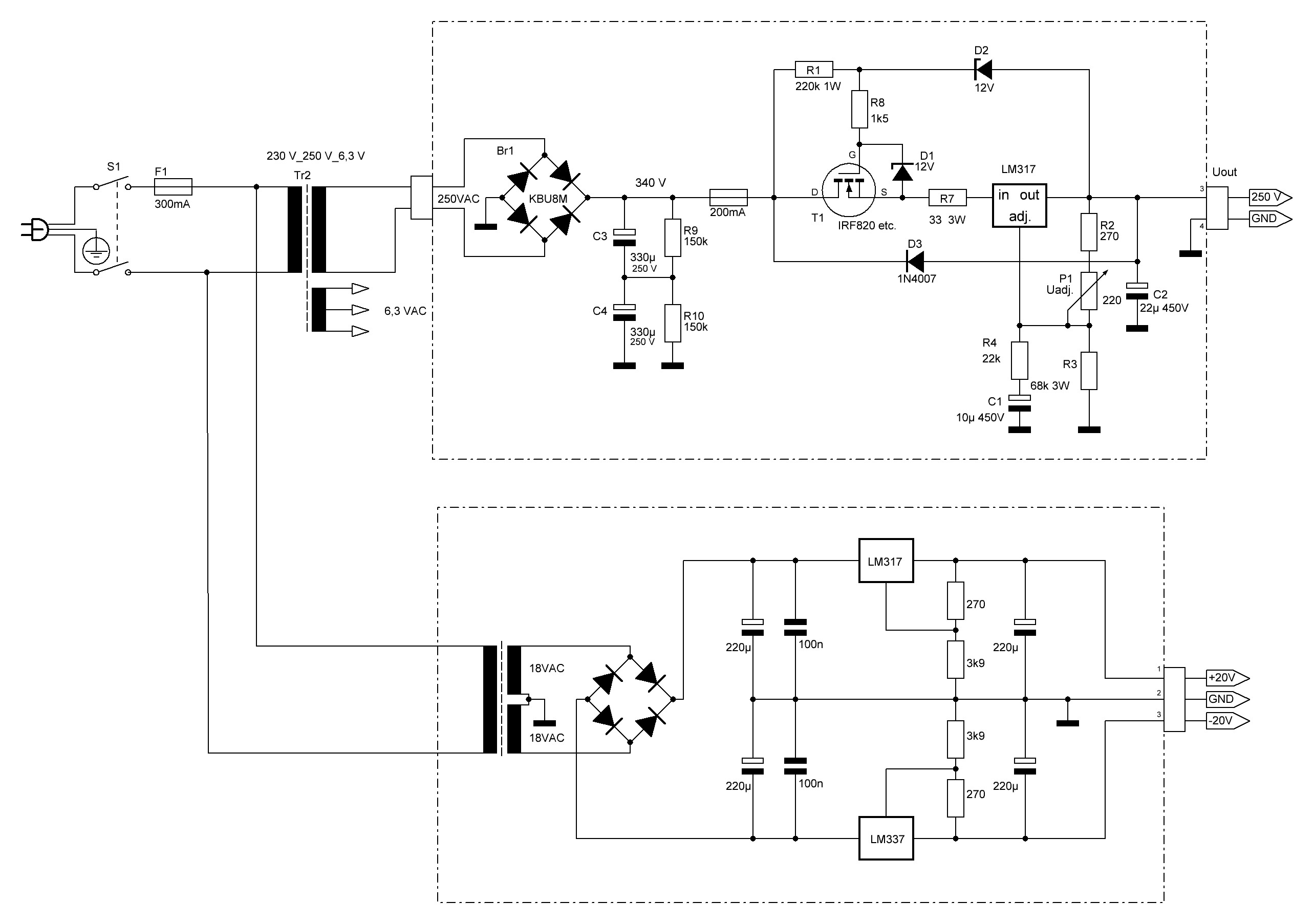

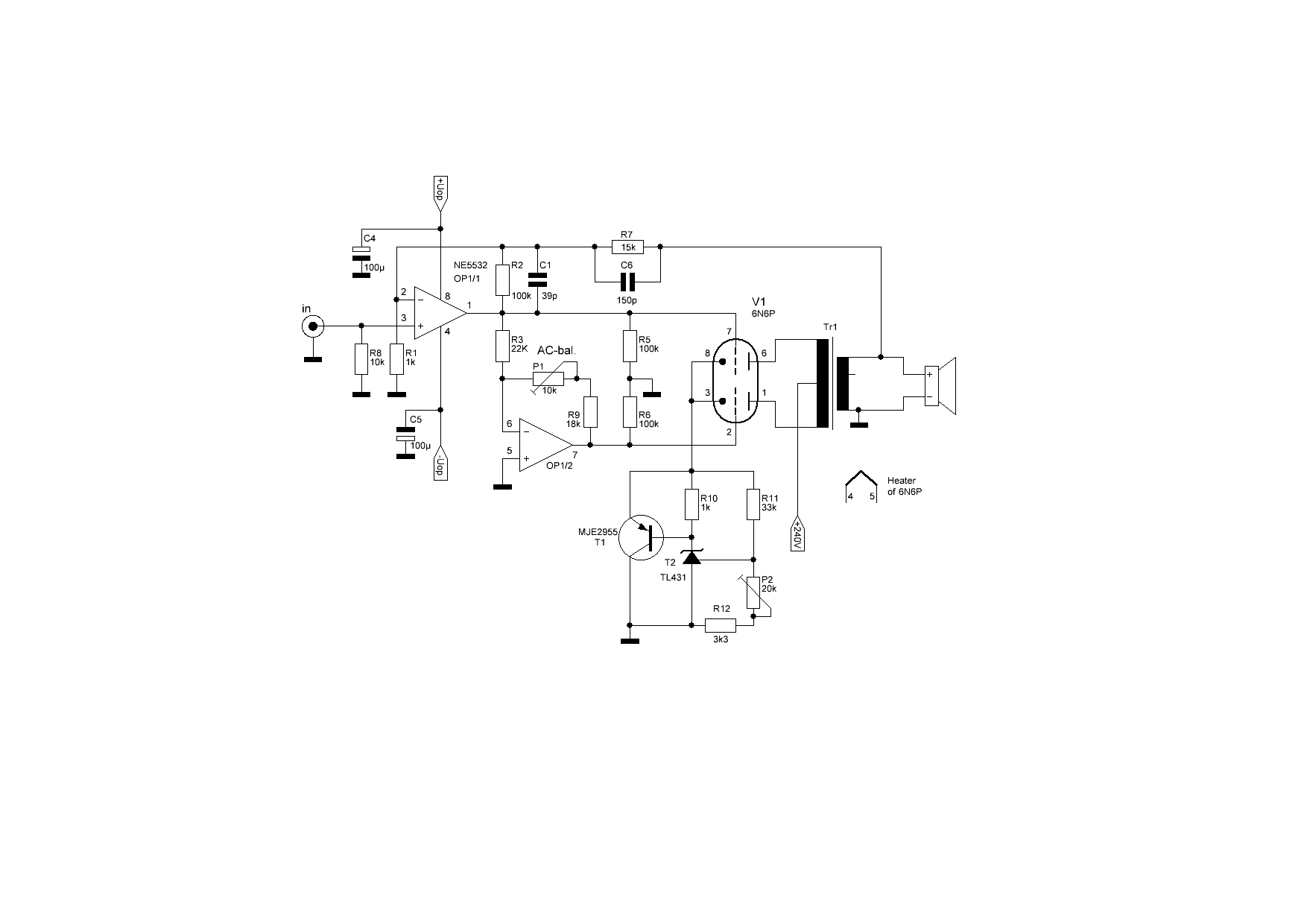

I have used both 6N6P and 6N6P-I in preamp and as output tube of 6W PP (AB2) amplifier (schematic attached). Both give similar THD numbers.
