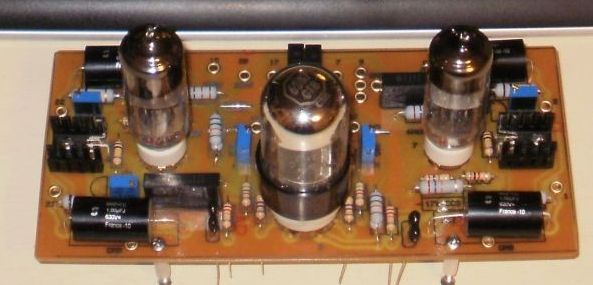

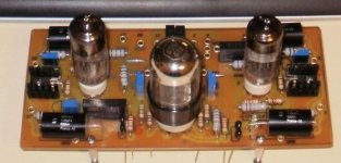

I found the 6N6P to be a solid driver when configured as a LTP with CCS. For tonal flavor I varied the first stage which was a 6SN7. Many different versions available to choose from....
Beautiful layout there. Thanks, I will investigate that as an alternative.
What voltage and current are you running the 6N6Ps?
Hi, I'm also interested in this. What are the best operating conditions for 6N6P tubes ?What voltage and current are you running the 6N6Ps?
I wonder this question also??Hi, I'm also interested in this. What are the best operating conditions for 6N6P tubes ?
My best success has been with high currents, 18 mA or more. Get the voltage up for optimal linearity, maybe around 120-150, being careful of dissipation ratings.
I have also used it as CCS LTP driver with great results, down as low as 6 mA per, but that was due to B+ limitations in the circuit. If I could go higher I would.
