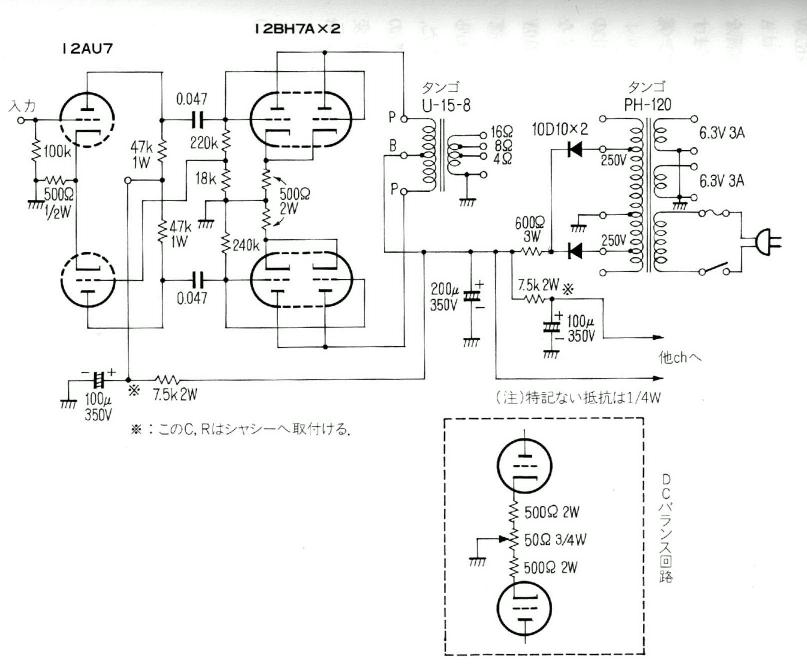

Looking at the ''loadlines'' for 2 tubes a 8K transformer of inductive resistance can work well. Any transformer from 8k to 3k could work for this tube in parallel.
Are you sure you want a no feedback amplifier like this one you posted?
You can of course build the schematic you provided and substitute the 12BH7, I see no problems, calculate heater amps save that number for main transform specs, calculate the bias and total current of the tubes and choose a power transforms that has all that and respects 300V max after rectification at that total current load.
The input stage/driver stage is an adjustable long tail pair. There is 3 ways of adjusting the trim pots, 1. Equalize the current flow through of each tube, 2. Play a signal and equalize for same VRMS after the 0.047 coupling capacitors. (3. Use a THD test and minimize the THD).
Personally I am not found of push pull without feedback. I don't like also the LTP driving directly after the input either in balanced input or single ended, asking for oscillation but, if you have such an amp already and like it, I encourage you to build it.
P.s. do you know if it is chinese or Japanese writing? Looks like japan schematic!

Yes, it is Japanese writing. It is one of Nobu Shishido's amplifier.
Yes, I don't want use NFB. With PP triode amp it is not needed.

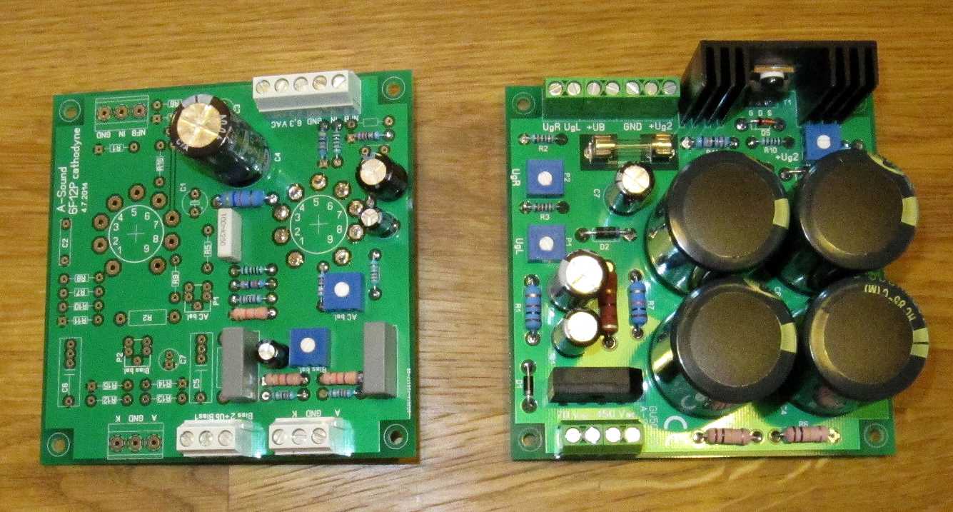

Is it practical to have components at both sides of the pcb ?
Can you show the schematic diagram ?
I placed some res. on top to reduce capacitance and help air circulation, I should put some holes into the pcb to help air flow.
More info: each pcb is mono, for experienced users the bias pots are placed for the side of amplifier and drill holes and access with screw driver, if someone wants to drill holes on top of the chassis or install elsewhere some bias pot you can solder small wires and route it.
I am not finished finding transformers for the power supply and a few things are not on the pcb, such as grid stoppers, bias taps, bias power supply.
I am trying to figure how the power supply could work with 250 B+ and 400V for the driver board.
The bias pot could be placed so that the adjustment is possible without opening a bottom cover, but the current of the output tubes must be measured during adjustment.
Therefore I usually place all adjustments just at the top of the pcb.
Attached is as an example a photo of my double cathodyne driver pcb (6F12P) and power supply pcb.
What sort of driver board do you plan to do, that needs 400 V ?
Look at the 3 black bias pots with orange color screw of my second picture. I wanted to have 2 mirror-like boards.
To follow your idea I could provide alternative bias pot placement for top of chassis access.
Yes, the driver board needs 400V which is annoying.
Your boards are nicely executed. I could use two modules, one to supply 400V/5ma, one 240V/45 mA.

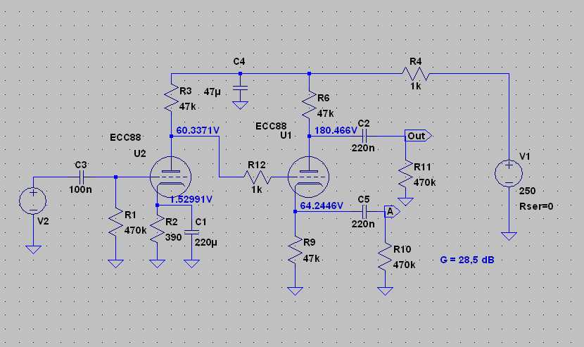

A pair of 6N6P needs only some 11 to 12 Vrms drive to full power.
This signal can be produced with 250 V supply voltage, either with LTP or cathodyne phase inverter.
You are right, this is not a powerful amp! I spent a good part of today playing with 'resistors values' and the best I could do is 0.2% TDH 260V B+ simulated with the super slow computer.
100 mVrms input 100K load = 11 Vrms. This leaves plenty of room for feedback.
