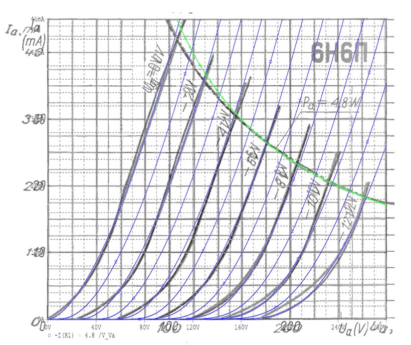

I was working on spice model for my bunch of tube models, have spoted
some notes about the tube that could be of interest for the future experiments with 6N6P tube.
Txt file contains datas fro manode chrs. graph. (GraphClick.app used for extracting values from the graph)
  • 6N6P_datas.txt
there is global PSpice model for all region showed in the datas. I compare two sources of datas and they are pretty same with minor differences.
.m file is Matlab file for module with Tuparam. m file from Norman Koren site.
You can download the file from his site and find additional useful informations
about modeling in spice for tubes. GraphClick file for 6N6P tube graph is a bigger file and I can send via mail, just ask (mac osx app.)

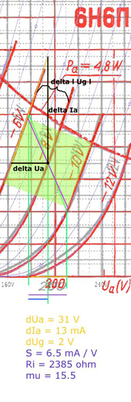

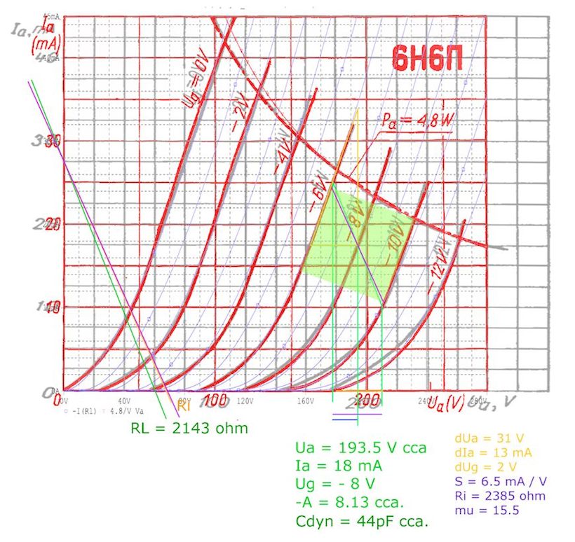

The suggestion for the setting the working point for smaler signals input
like for instance line preamplifier stage or 1st stage in power amplifier...
:trapper:
I found some interesting region at the chrs graph. In that region tube is
particularly linear. Also 6N6P can accept the signal of about 4Vp-p at the input.
With aminimum distortion.
What is from the character and bit of unusual,
is that the load line can be set with a value equal of Ri (internal resistance of the tube in working point)
or even a little bit less from Ri value.
And with the same portions of current amplifying values as well as voltage values.
And the load line angle is 45deg from 90deg line to the Anode Ia/Ua -8V Ug line.
Which is could not be accomplished with every point in the region
You can find from the picture static point datas and tube chrs in point of use
with load lines. Ri is about 2.4K and load could be even 2.2K less than Ri.
With Ri of 2.4K the load line is with 45deg against the Ia curve.
Cdynamic is the value calculated with gain in point, and about 0.7pF added for the socket

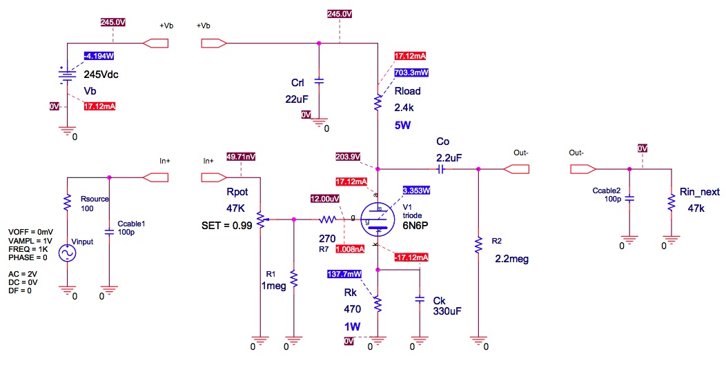

there are some graphs of
Bandwith
output resistance
Voltage FFT
And Current FFT
Tube showing very low level of THD even with full pot
and lower output resistance (1160 ohms) for small tube stage
:trapper:
cheers

PDFs from Transformer Loaded 6N6P in line preamplifier circuit mode...
The datas showing even less distortion compare to low distortion with classic R load...:D
But the results are obtained with simple equivalent circuit, without core issues
or transfer ratio. Just total approximated values.
