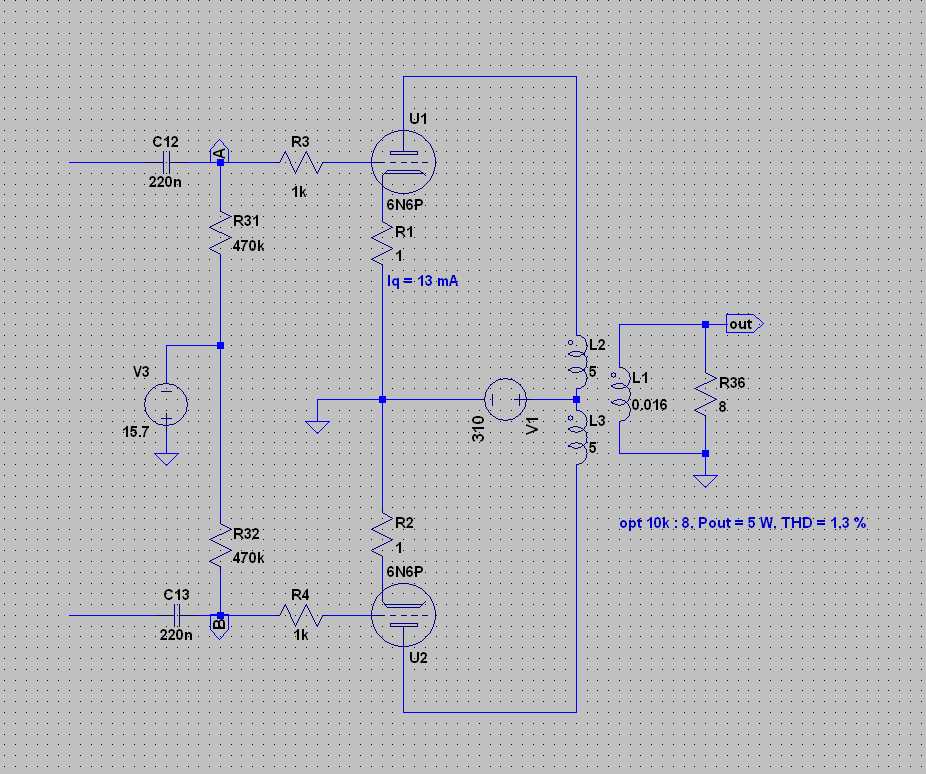

...I am interested about your 6N6P parallel PP amp output stage's details...
There are really not many alternatives how to do this sort of output stage.
Below is a fixed bias version with single 6N6P tube.
With two parallel tubes the OPT should be 5k.
Some 11 Vrms of drive voltage is required for full power, which is about 10 W.
If you prefer autobias circuit use some 600 ohms (bypassed) cathode resistor/two triodes and some 320 V as +Ub.
The OPT is same as with fixed bias.
Autobias is easier to accomplish and does not require bias adjustments after tube change.
But fixed bias is maybe more linear and provide a bit more power with better efficiency.
