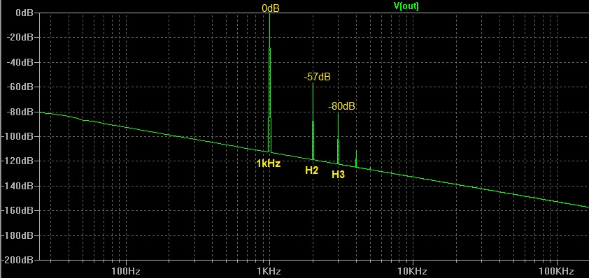

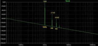

OK, the baudouin0 5751-6N6P WCF circuit using the Ayumi 5751 and 6N6P models, with 1V rms output into a 32 ohm load.
Gain = 3X
1V out into 32 ohms = 0.44% THD (H2 and H3 about equal, but lots of higher order harmonics too, showing that the amp is close to clipping)
Three FFTs are attached.
- The first one is the circuit with 5751, driving a 32 ohm load with 1V rms out. (31mW)
- The second one is the circuit with 6N2P, driving a 32 ohm load with 1V rms out. (31mW)
- The third one is the circuit with 5751, driving a 300 ohm load with 2V rms out. (13.3mW)

A headphone amp is a low power amp, especially for low impedance headphones (16 to 50 ohms). Figure a max power output of 100mW is going to be enough for almost all headphones. But what does that mean?
If a headphone presents a 32 ohm impedance and sensitivity of 94dB/1mW, then to get to 115dB SPL the headphone amp will need to deliver 128mW into that 32 ohm load.
If we accept 100mW as the maximum power output we actually need, the driving amplifier has to be able to swing 1.8V RMS into the 32 ohm load and sink 56mA into that load as well.
The 6N6P WCF can easily deliver the necessary 1.8V RMS output, but it can only, possibly, maybe just barely sink the necessary 56mA.

16mW into a 32 ohm load equals about 0.72V RMS, which means about 22.5mA current sunk.
The 6N6P WCF can easily supply the 0.72V RMS (no sweat) but that 22.5mA of current is going to make it work pretty hard. But it should be OK. The price for stressing the 6N6P WCF's current capabilities will be higher THD. That's all.
