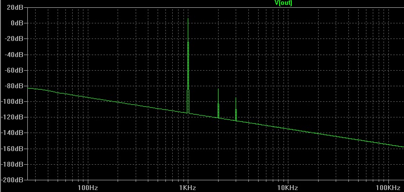

Just checked the last circuit Badouin0 posted with a 300 ohm load. At 1V rms out into 300 ohms, it gets 0.011% THD, H2 dominating.
Nice!!
I feel like a luddite now...
The graphs of FFT mean FA to me because nobody has taught me how to interpret them.
Don't worry. For some reason I haven't been able to master a PCB layout app properly. I'm still relying on the kindness of strangers for PCBs. Silly.
The FFT shows the fundamental tone, and then whatever harmonics are generated at frequencies above that.
In this example, the fundamental is 1kHz, which is the big spike at 1kHz.
The second biggest spike is at 2kHz, which means that's the second harmonic (at double the fundamental frequency).
The third biggest spike is at 3kHz, so you guessed it, it's the third harmonic (H3). As you an see, it's well down from the second harmonic (H2), which means it will sound nice. :)

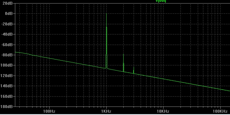

I just finished importing the .asc file baudouin0 posted earlier.
The output stage is completely bada$$!!!
The problem I'm having is that I can't replicate the same super-low H3 levels using Adrian Immler's 6N2P model that baudouin0 gets using the Ayumi 5751 model. And, since the 5751 is now a super-collectible, valuable tube, I'd rather see it working with a 6N2P, or even a plain-jane 12AX7. Or a 12AT7. Anything cheap.
When I substitute the 6N2P, I can only get it to bias up with about 130V on its plate, 0.62mA plate current, using 1.5k Rk for a grid bias of -0.93V. That works, close enough, I guess. Be that as it may, the simulation numbers are still really freakin' good.
With a 300 ohm load:
Gain = 3.5X (about 10dB)
At 2V rms out, THD is 0.0016% (!!!). There's definitely some cancellation going on in there.
The FFT shows 2nd harmonic completely cancelled out, and 3rd harmonic at -95dB, and that is all
That shows that the WCF has been tuned to true push-pull operation into a 300 ohm load, cancelling all H2.
How about into 32 ohms?:
Gain = 3.14X (10dB)
At 1V rms out (which would be enough to drive practically any set of 32 ohm cans into deaf-ray territory), THD is 0.26% (a lot higher).
The FFT doesn't look as good. It shows some cancellation of H2, but lots of higher order harmonics as the amp approaches clipping. I've attached the screenshot of the FFT at 1V rms out into 32 ohms. This is with the 6N2P in place of the 5751.
If a pair of 32-ohm headphones has sensitivity of 100dB SPL at 1mW input, then 1V rms drive would be 15.6mW, which should drive the headphone to put out 112dB SPL. Fer cryin' out loud, ya need more than that???
I guess if you have a low sensitivity pair of headphones like the Fostex T50RP (94dB for 1mW input) then you would need the extra voltage swing into a low impedance load. The T50RP has a 60 ohm impedance. 1V rms out would be 8.3mW. That means 1V will only drive the headphones to 103dB. The max power handling of the T50RP is specified as 1W. Well, I don't think a WCF is going to drive those. But a pair of Audio Technica ATH-M50X? Heck yeah.
Anyway...

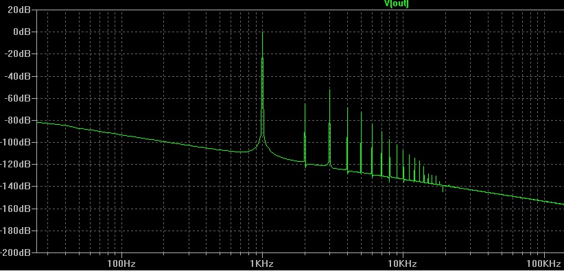

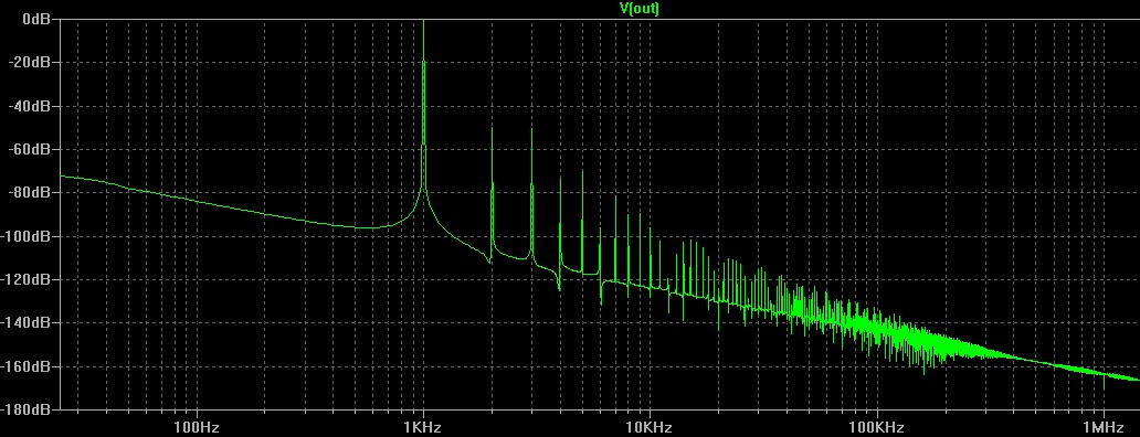

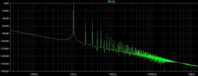

OK, the baudouin0 5751-6N6P WCF circuit using the Ayumi 5751 and 6N6P models, with 1V rms output into a 32 ohm load.
Gain = 3X
1V out into 32 ohms = 0.44% THD (H2 and H3 about equal, but lots of higher order harmonics too, showing that the amp is close to clipping)
Three FFTs are attached.
- The first one is the circuit with 5751, driving a 32 ohm load with 1V rms out. (31mW)
- The second one is the circuit with 6N2P, driving a 32 ohm load with 1V rms out. (31mW)
- The third one is the circuit with 5751, driving a 300 ohm load with 2V rms out. (13.3mW)
The original circuit has much higher THD. With a 6N3P and the 6N6P non-WCF, no-NFB circuit there's 0.39% THD with 1V rms into 300 ohms (3.3mW).
So even if you don't trust LTspice simulations of THD, comparing like to like you can see that one will produce more distortion than the other, even if you don't know exactly how much distortion.
