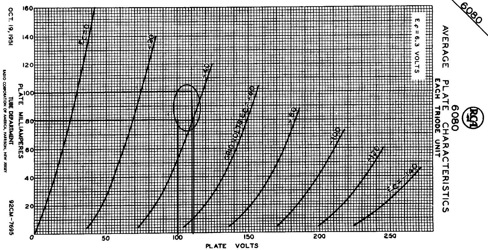

If using a fixed bias to drive the grids on a 6080 am I looking at a 30-40 negative voltage requirement on each rail if the plate voltage is around 100-120 volts?
I heard when testing I should start at the most negative and slowly adjust until the required current is achieved.

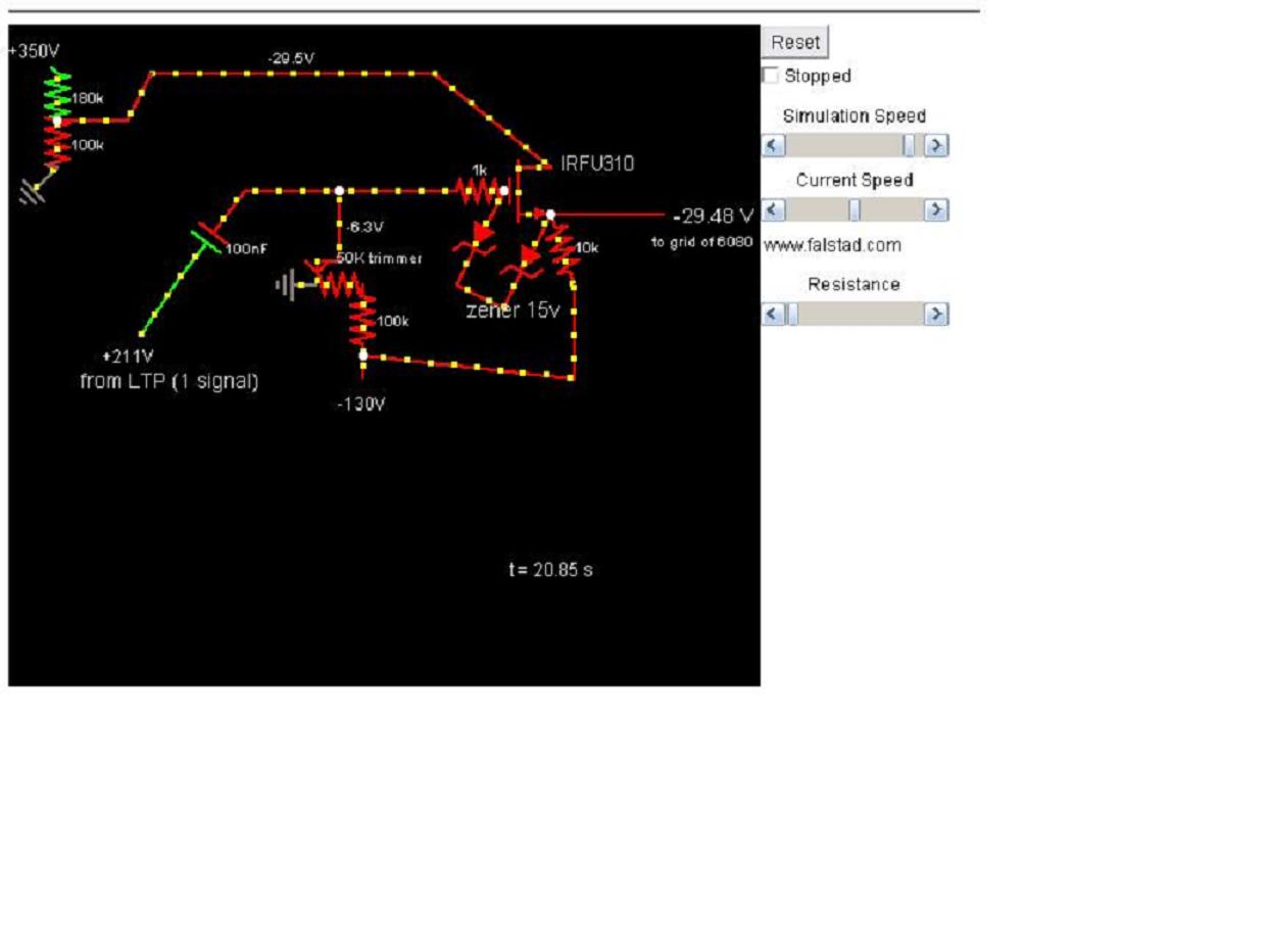

Breadboarded an OTL last night, with mosfets as the CF drivers.
Used a 50K trimmer from a -130 V source for each rails bias.
One rail bias worked great, adjustable 0 to -90 volts on the Source output BUT the other stuck at -1.2 volts. thought it was the mosfet, change that, still the same.
Head scratching and testing resistors for hours. Have to check the trimmer, maybe that is gone but doubt it.
But very strange the one that is working, I measured the positive voltage on the drain and it measures 32 volts, but the voltage is 130 volts.
The voltage on the drain that does not adjust properly is 64 volts from the 130 volt .
Bizarre to say the least.
Lost sleep over it last night.
Have to to check it all over again tonight.

I'd guess "wiring error." Can you sketch a schematic of what you THINK you wired?
You used gate stoppers, with the bodies of the resistors right up on the gate lead, right?
I'll check this when I get home tonight.
Gate stoppers need to be corrected. No they are not close up at the moment.
I wired it up as the same attached in this thread but yes have to double check. Maybe I didn't mirror both rails correctly.

Ok I've got a circuit diagram here showing the mosfet as CF.
If I use a voltage divider to create the postive voltage for the drain on the mosfet, around 120 volts from the B+, this drops to zero after powering up.
As you can see from the rough simulation I end up with a negative voltage on the drain.😕
I have the negative voltage derived from a floating power source to power the source and bias.
(actually a 220/6v tansformer in reverse connected to a 12.3v heater supply to give me around -130 volts.)
I didn't expect the postive voltage on the drain would become negative.
Some advice would be greatly appreciated. Thanks.

I suspect the issue is with the resistive divider from 350 to ground.
The thevenins equivelant circuit is 125V with a 64.3K series resistor to the drain of your FET.
You have 10mA of current flowing thorugh the circuit, so you have saturated your FET.
You need a lower impedance in the drain of the FET.

Looks like I'll need to derive the Postive voltage for the drain from a separate psu.
That or a FET with a greater Vds rating.
The IRFU310 is only s pecified for 400V, so with 350Vd and -130Vs you need a part rated for greater than 480Vds.
What about a zener divider? maybe 3 x 33v zeners in series with a resistor of low value.
99v on the drain and -130 volts on the source across the 10k resistor.

-18v grid bias to test on my otl. at 75 watts anode
6080 output 740mV on positive rail
and -720mV on neg.
Does that equate to 20mV dc offset ?
