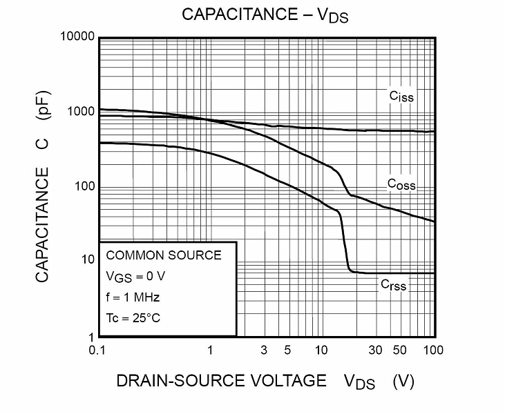

I believe the important parameter is a low reverse transfer capacitance
Look for a spec called Crss. You want it to be low, preferably under 10 pF, and constant under the range of voltages that will be seen in actual use. There is uaually a graph of this and other capacitance related specs VS voltage. Most fets are quite non linear below a certain voltage, then go fairly constant. The transition voltage is usually 10 to 50 volts although some fets never flatten out.
This means that you are putting a capacitor that changes value with the applied signal voltage directly in the audio path. TIM and PIM distortions can result, so we want to keep the capacitance constant and low.

So the 310 are more ideal as they only have a Crss of 6.3 pf.

I used that one for a while. It needs external diodes, and yes I have blown a few because they were not present.
I have used Toshiba parts for the last 5 years. Look at the Toshiba 2SK3563. It has protection diodes built in, and the Crss is ruler flat above 20 volts. The case is isolated so that the heat sink will not shock you.

Crss 6.3pF VDS=25V, f=1.0MHz
IRFR310 looks good above 30V for Crss flatening out.
MTD2N40/MTD1N50 are the only FETs so far that I have found data at high VDS values and it shows a change in Crss from 7pF to 3pF with a VDS change from 35V to 300V for the MTD2N40, and 7pF to 2.5pF for a VDS change from 25V to 500V for the MTD1N50.
It looks good, but hard to tell on the scale used. Look at this one.
