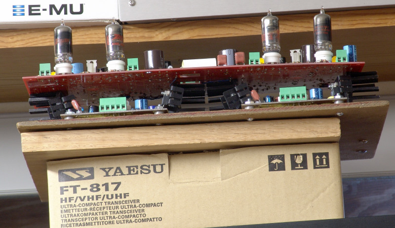

My amp is still in the breadboard stage. It is literally 4 PC boards screwed to a piece of Masonite. It has no transformers. The lack of weight prevented serious damage. It's been buried in the closet for at least a year, wedged in between the box for a ham radio and one of Petes red boards.
The amp is still wired for trioded KT88's.

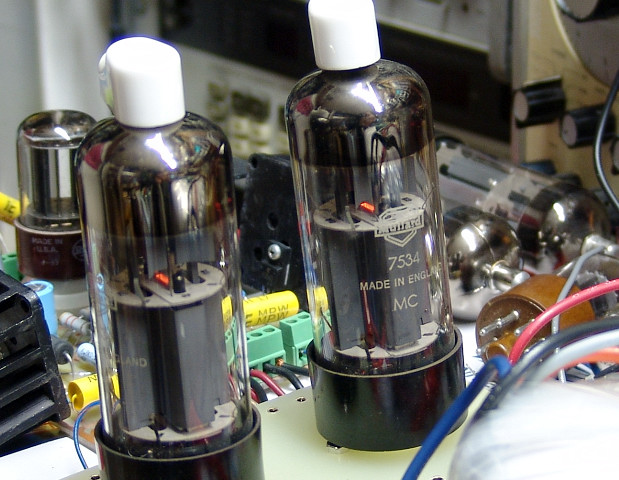

I made that statement while I was at work this afternoon. Now that I am home and looked at the amp, I see plate caps. UH.....last time I played with tubes KT88's didn't have plate caps. I looked back at my notes and pictures. The last pictures were from mid 2010 and clearly show a pair of Mullard E130L's, so that's what the amp is set up for.

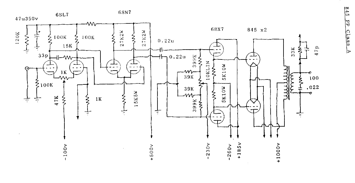

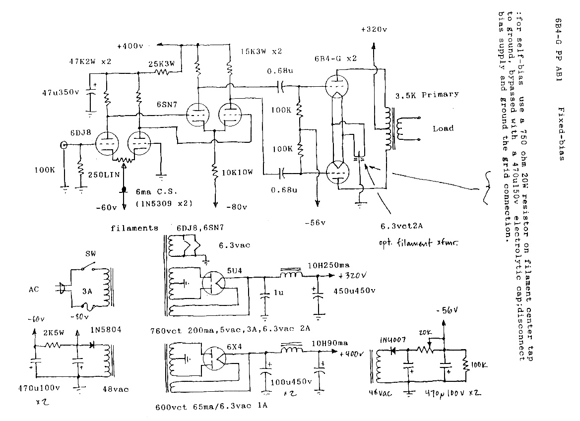

Thought you might be interested....
This amp wound up quite a bit like the "Tubeosaurus Rex" from an Arthur Loesch design in Sound Practices and a similar amp from JC Morrison's Fi Tube Primer.
Add cathode followers after the driver stage, and you get this:
PS - I forgot to mention that I've heard a few of these, including a push-pull 300B version I built (but had oscillation problems due to my inept layout). A buddy just built a 6DJ8 > 6N6P > EL34 version. All have sounded really, really clean.
Hmm, don't know what happened there. OK, let me try again.
These are two schematics from the ca. 1992 Tube Audio Primer available from Don Garber's Fi store in NYC. J.C. Morrison drew up the schematics. It was wild and crazy stuff back then.
First schematic is a push-pull 6B4G amp that should look familiar.
Second schematic is basically the same driver circuit with cathode followers DC-coupled to 845's.
I hope you find them interesting.

Is the two stage differential 6SN7 front end still appropriate if I'm building this as a power amp, triode KT88's no feedback and my preamp has switchable gain (12db or 29 db) for line out? It seems like I'll have way more gain than I need as well...........
I remember that with push-pull 300B's, it took something less than a volt input to drive the amp to clipping -- and that was with a -70V bias on the 300B's. That was with a 6DJ8 in the first stage. I used that type of amp with just a pot and switchbox, no active line preamp.
I figure the first 6SN7 LTP with 47k resistors in the plates would have a gain of what, about 15? So if the bias on the second 6SN7 is let's say -6V, then it will only take about half a volt at the input to drive the driver stage to full swing, right?
You could try 6N6P or 5687 instead of 6SN7, which should have a little less gain. A little higher distortion, though.
Reducing the plate load resistors on the first stage would also reduce the gain, right? I don't know what kind of a distortion penalty there'd be.
George, it sounds like you were thinking that a 6SL7 (or 12AT7 maybe?) would be necessary to give enough gain to play with plate feedback on the 6L6's. What if you only wanted an input sensitivity of about 2V rms to full power? Wouldn't the cascaded 6SN7's have enough gain for a little plate feedback around the triode KT-88's?
This amp is cool.
The amp as it existed in the past spent quite some time wired up exactly that way. Cascaded 6SN7's driving trioded KT88's. With no feedback at all my CD player could drive it to clipping with even the quietist recordings. However there were a few DVD's that could not drive it into clipping using an old Toshiba DVD player. I like the sound of thst old beast so I keep it around even though I have to smack it sometimes to get it to play.
The standard aproximation for maximum gain in an LTP is half Mu, so the gain with an optimum load is 7 or 8.
Wiring the output tubes as pentodes raises the gain, but to compensate for the high output impedance of a pentode I experimented with some feedback. The setup that worked the best was to take a pair of resistors and wire them from the plates of the output tube to the plate of the opposite input tube. This wraps the feedback around the output and driver tubes. You need a 6SL7 for the first tube to make this work.
