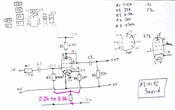

6J1 tube buffer circuit diagram

I don't know why you started a new thread when the schematic is in this thread.
..volume ...would it compromise the signal ...
You bought one of the cheapest line-amps available. To hold down cost it runs obscenely low supply voltage, near 1/10th of any "good" line-amp. The plate resistor drop is a mere 24V. This is worse than a $9.95 AM table radio. "Compromise" is going to happen.
A volume pot, despite all the yay-sayers on this forum, is about the least compromise part of any active circuit. (And does not care about supply voltage.)
If you must tinker the amplifier gain, do this.

If the schematic in Post 42 is correct the gain at the plate is about X1.5. By eyeball the cct reduces to an unbalanced phase inverter.
The common line could be pushed to the bottom of the dwg, the complicated PS reduced to a single supply of total the +ve & -ve supplies.
Am I missing something? This preamp looks to be mostly PS, not much else.😀
