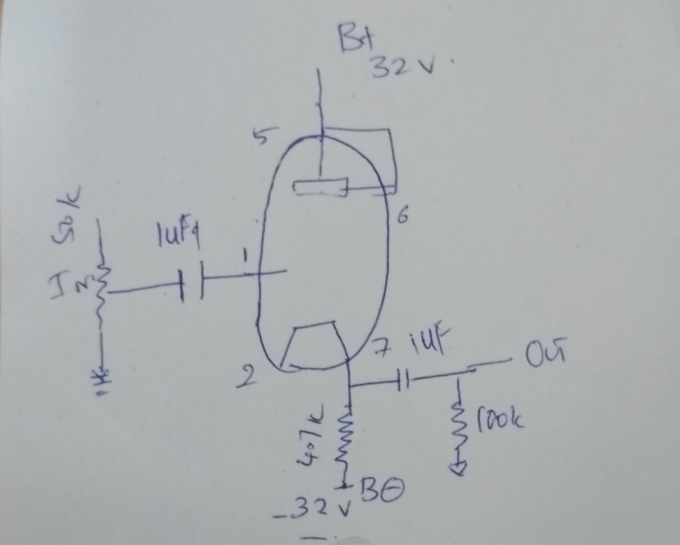

Thanks for the simulation.. I tried a modified cathode follower and to my ears it sounds very clean and musical, much better than the anode version,but with unity gain..Can you kindly do a FFT analysis of this? I am new to LT spice,and i don't have tube models.
Yes indeed,theres no grid to ground resistor. I tried a 470k resistor and it produced a noise.. I skipped it and then everything was fine..,infact so musical that i wonder how... That's why I wanted experts to opine.
What is the 1uF capacitor that goes to the grid?
Is it an electrolytic?
Is it a leaky non-electrolytic?

So where does the grid get its bias from?
The 1uF grid cap should be a film cap. Or, you could use an electrolytic and then you will not need a grid resistor!

No,it's not electrolytic.Both input and output capacitor are polypropylene type.

It is unlikely that a valve with random grid bias will add "awesome musicality" but there is no accounting for taste. Clearly something is providing some bias, so maybe the valveholder has just enough dirt or flux on it to provide a conductive path? Or the caps are leaky?
An open-grid tube will self-bias both by glass/socket-leakage and small grid currents. This has even been used commercially for special applications. Interestingly, for some range of cases, open-grid tends to bias in the higher gain zone of the tube. But I agree that here any "awesomeness" is accidental. (The most likely "awesome" case here is that the grid tends to zero-bias and clips the top of loud waves, adding "flavor".)

As a newbie, please enlighten me how to play/ tweak this buffer to add distortion... Can I change the cathode resistor value / or add a resistor in series to anode and positive supply? Suggestions appreciated.
I'd imagine the most effective way to add distortion is to run it on too low an ht and without biasing it. if you'd like good sound there are plenty of good cathode follower designs, or for best sq, leave it out.

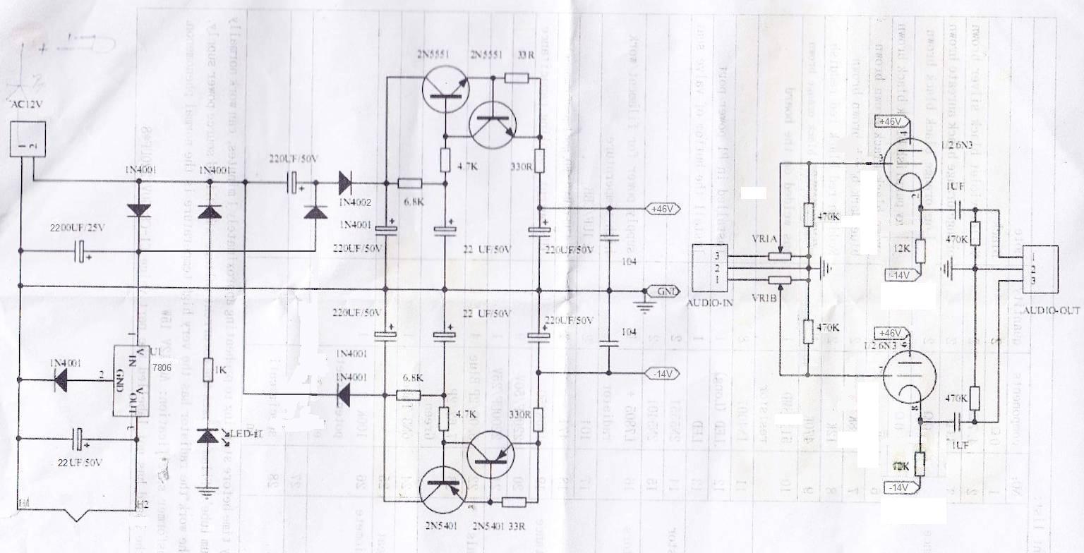

I've got two different 6J1 tube buffers off ebay that I am looking to fit inside CD players and would like to have circuit diagram. Googling seems they are based on Musical Fidelity X10-D
The first board amplifies the signal so that it distorts - the workaround is a resistor divider to reduce the input (which is what the volume control on board 2 does) but I would like to redesign it so it has unity gain.
Secondly I may want to redo for a new layout so that the circuit fits inside the CD player (currently I would have to make two holes for the valves in the top cover).
Both boards have a 3x voltage multiplies proving +/- 35 V ; I may want to put that on a separate board.
Anyway here are the two boards: (not sure if they are identical)

yes, I did modify the second board, shown in original post, to be unity gain (to be precise it is slightly below 1.0 as makes no odds). The potentiometer is removed and replaced by resistors and some re-routing of components requiring the cutting of tracks.
I also added a full bridge rectifier for 12.7 V power supply (7812 with diode between pin2 and 0v) to the heaters which reduced the current draw of the circuit due to the heaters in the original being in parallel with a drop resistor. (I need to confirm this).

BTW I am not a valve guru - I had the circuit diagram for the board I am using and one for a buffer (unity gain) and had a little bit of assistance/advice from somebody on a audio forum (was it here?) that allowed me to modify the circuit - the one I am using is also a pre-amplifier which has the potentiometer at the input - much like what you are asking for, but IMO is not the best solution.
