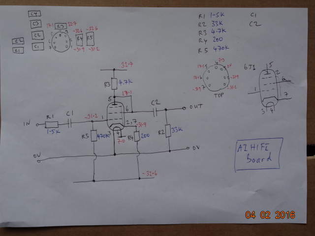

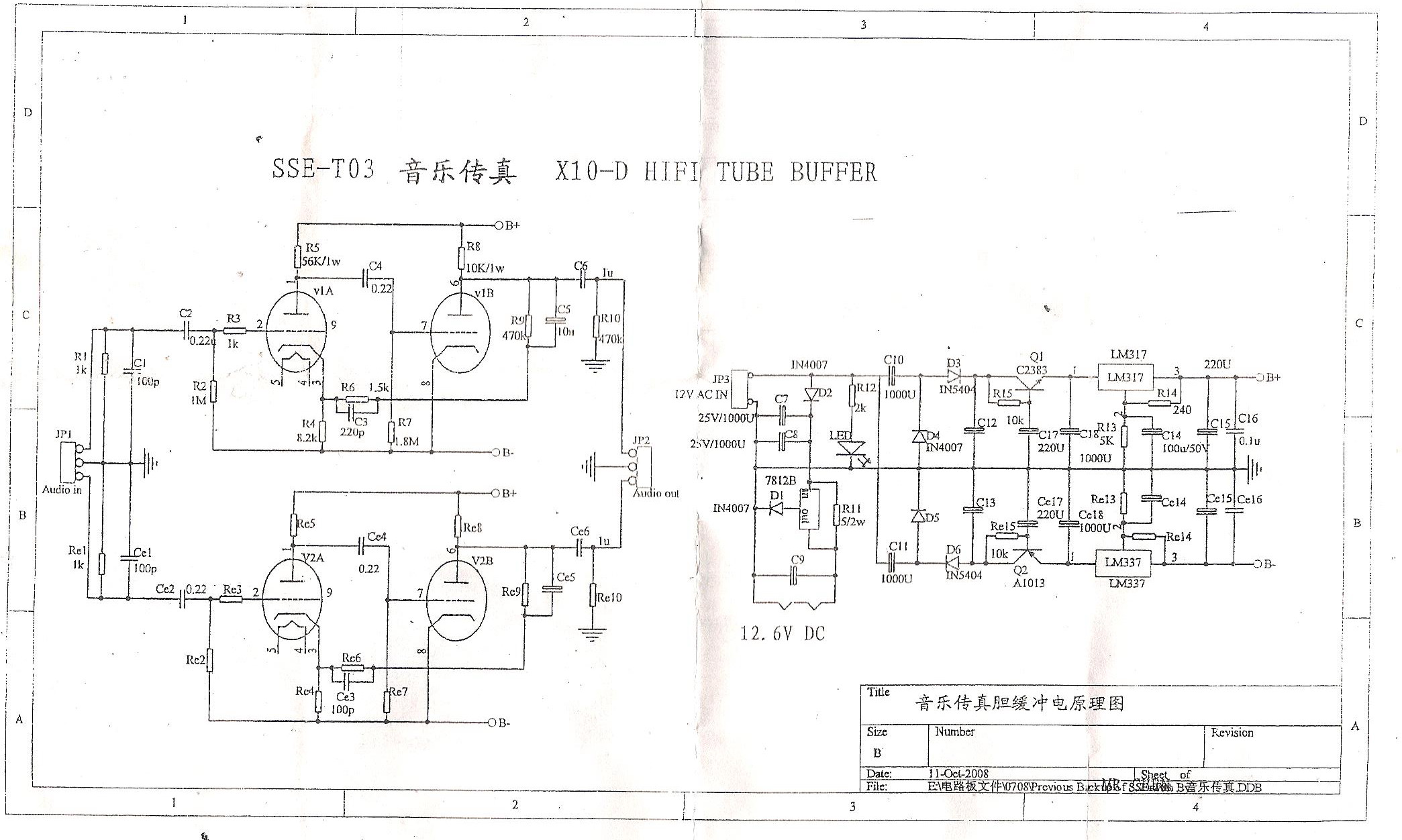

Thanks for reply. I have seen the MF X10-D schematics. It has the voltage multiplier to give +/- 32 V DC supply from 12 VAC, like these two boards but the valve circuit differs. The MF has two valves whereas the ones I posted use one pentode.
I have traced the circuit diagram (for the first board, the rectangular one with 4 yellow capacitors) and it is as below.
Valves are a bit before my time so forgive my silly questions, hopefully someone can help.
1. voltage on grid (pin1) is very close to negative supply (1.4 V difference), is that ok? From memory the CD player output is 2 V pp so that gives little head room before the negative rail is hit.
2. info from web, gain of circuit is
-gm (Ra || Rp)
where Rp = plate resistance, Ra is R3 = 4.7 k;
is that correct?
3. I have seen similar circuit which has a bypass capacitor across R4 - what effect does this have on the gain?
4. how do I modify circuit to reduce gain?

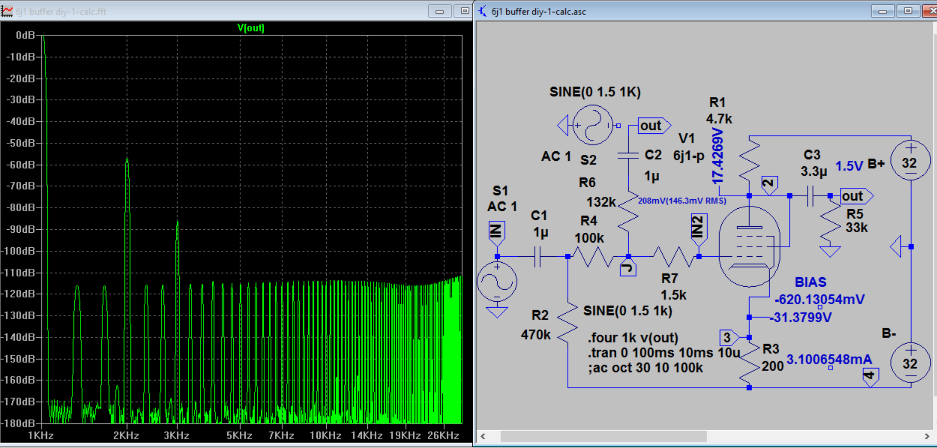

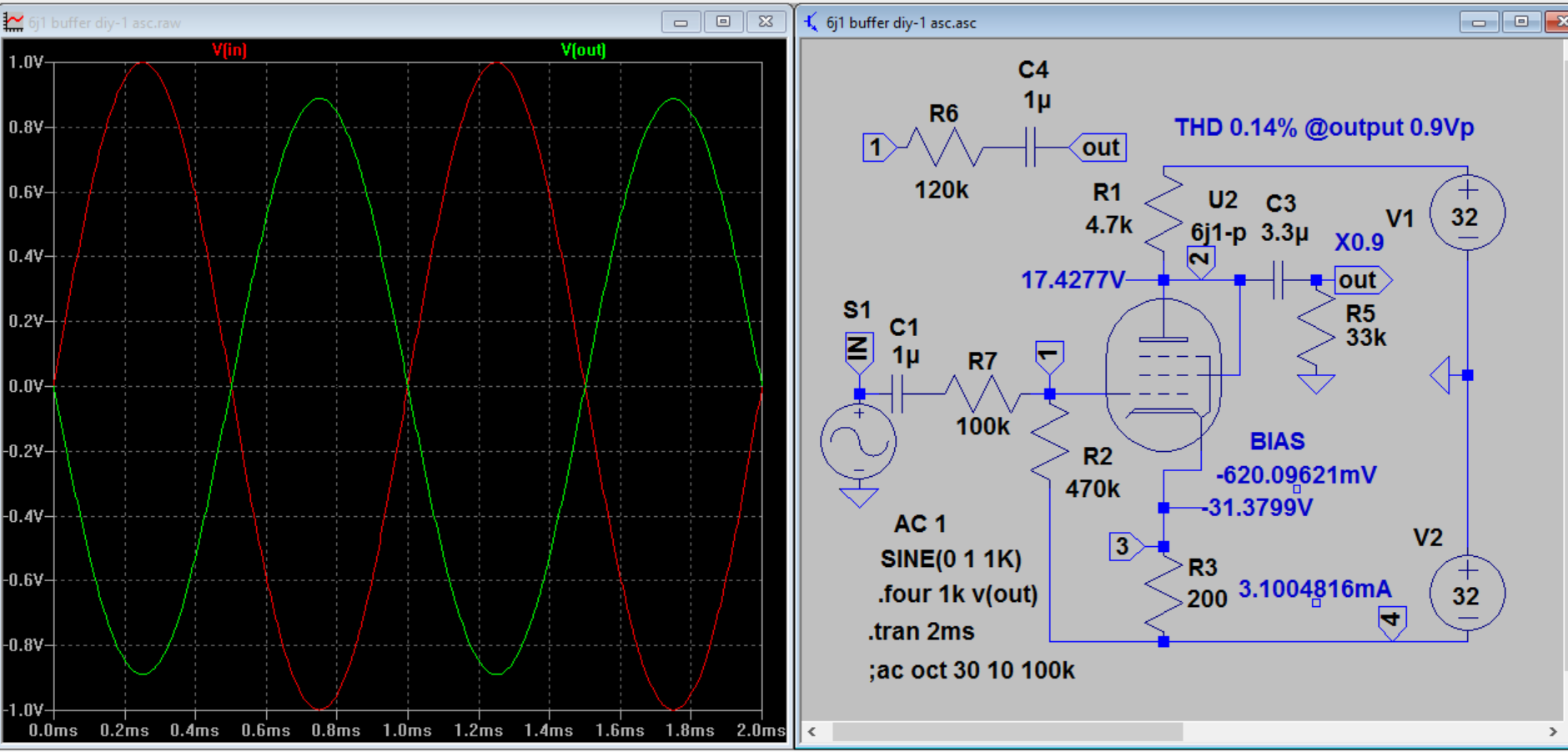

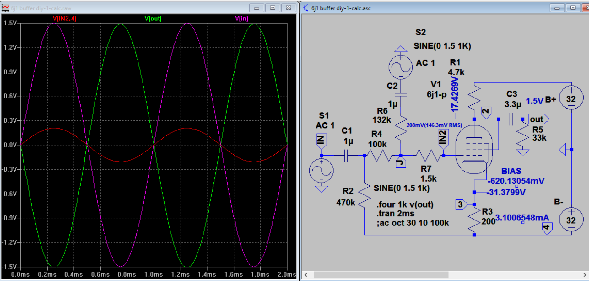

Hi, I think NFB will be the answer to all your questions, this is about unity gain buffer. However the gain can be changed if you want, by changing R6 value higher means more gain, have a look first.
Edit: it can take up to 10Vp input before clipping.

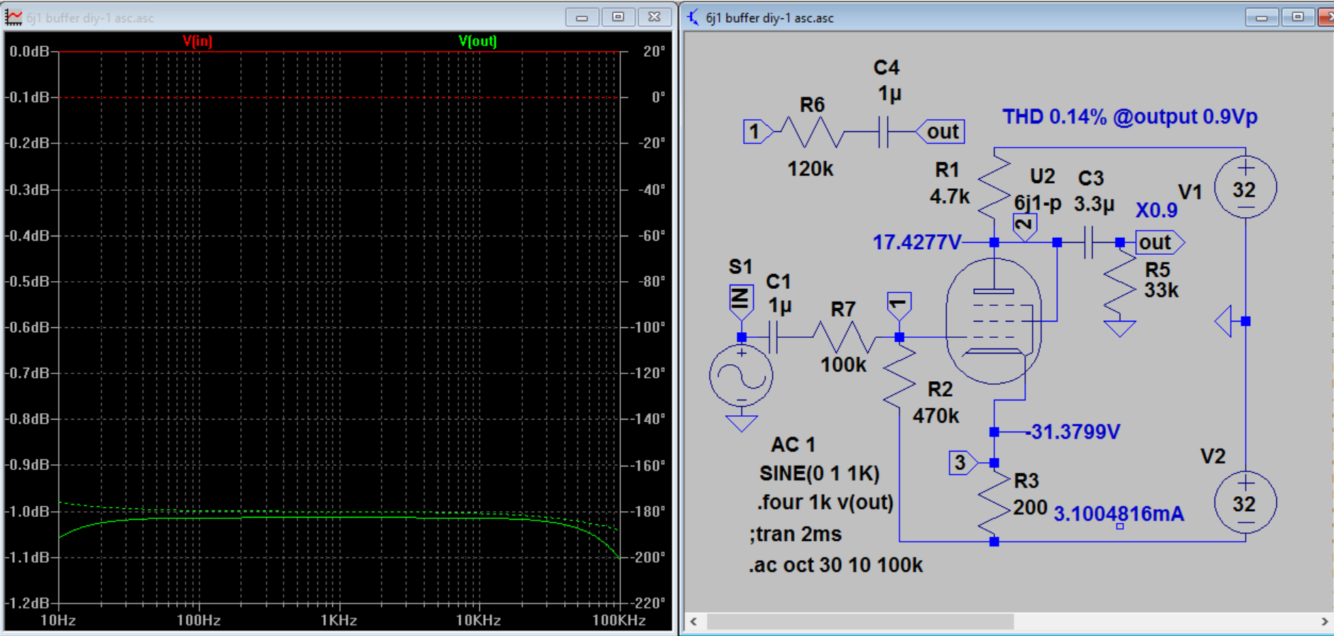

Thanks for that. I see you changed value of R7 from 1.5 k to 100k. That alone would reduce gain as the input voltage is reduced by R7 and R2 divider.
And to confirm, you added negative feed back using C4 and R6.
What was the reason for changing value of R7? If I leave it at 1.5K and add the two feed back components, what will happen?
How do I calculate gain for the circuit you posted (I'm after gain of 1.0 or as close as is possible with minimal component changes).
R6 is 139K for unity gain, for calculation you can have a look in other post #24 But for this one is a little different I'll calculate later. R7 is part of NFB ratio. You can't not leave it as 1.5k is too low, but you can keep it as grid stopper resistor.

Here are the unity gain calculation other gain also included in case you need it as line amp.
Resistance 470k, reactance of C1 and C2 are ignored
They've little effect on feedback @ the values shown.
Supposed that Aol is 7.21, to give 1.5V output, input level required is:
1.5/7.21=0.208 or 208mV at J (grid)
The input level is reduced while the output is held constant at 1.5V
Gain db V Input(1.5/X) X R6(K)
0 1.5 1 132.2
6 0.75 2 315.1
9.5 0.5 3 584.9
12 0.375 4
14 0.3 5
15.6 0.25 6 4M
For 0db(1X), voltage between Vin,Vj = 1.5-0.208=1.292,
Vout,Vj=1.5+0.208=1.708V
I=1.292/100=0.01292, R17=1.708/0.01292=132.2K
For 6db(2X), Vin-Vj=0.75-0.208=0.542, Vout-Vj=1.5+0.208=1.708V
I=0.542/100=0.00542, R6=1.708/0.00542=315.1K
For 9.5db(3X), Vin-Vj=0.5-0.208=0.292, Vout-Vj=1.5+0.208=1.708V
I=0.292/100=0.00292, R6=1.708/0.00292=584.9K
For 15.6db(6X), Vin-Vj=0.25-0.208=0.042, Vout-Vj=1.5+0.208=1.708V
I=0.042/100=0.00042, R6=1.708/0.00042=4.067M

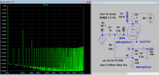

OK, so you do want distortion but not too much. The best way to do this is to make a cathode follower using an inappropriate valve (such as a small VHF/UHF pentode) and run it from too low a supply rail voltage (30-50V should be OK). Hey presto! You have a "tube buffer".
Ya pentode is pretty good as cathode out buffer, at least better than a triode as the gain desired can approach unity. Sonic wise some dislikes due too high 3rd or odd harmonics.

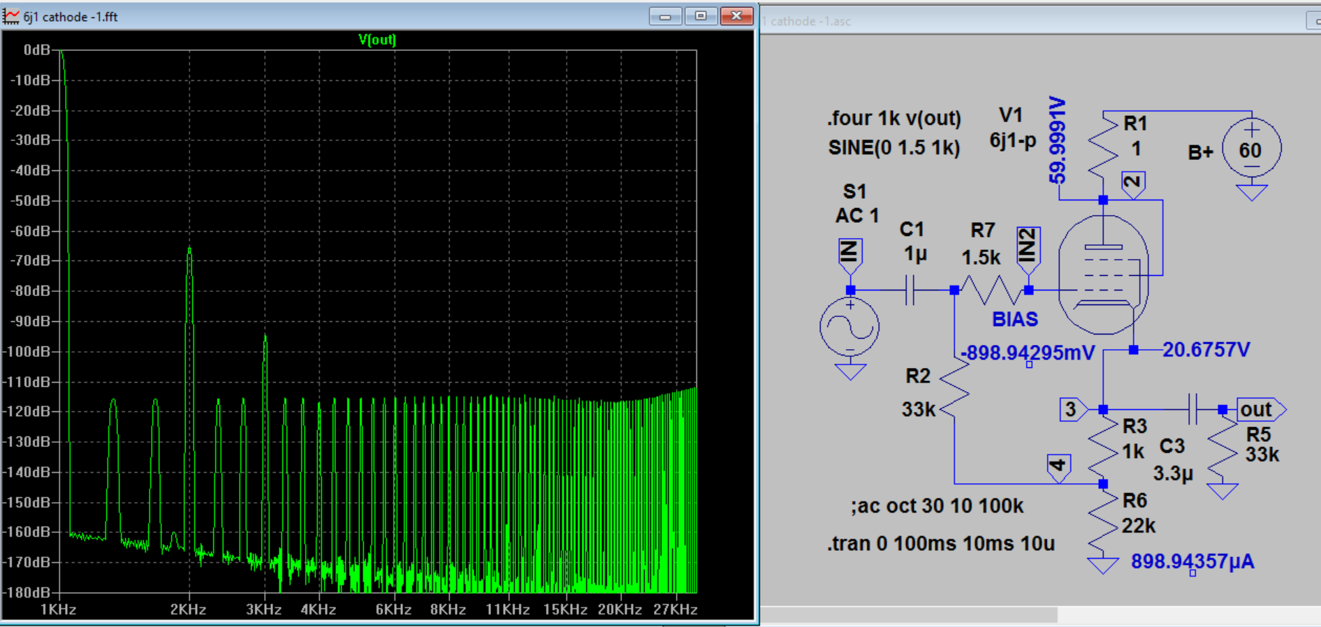

Here is a sch for cathode follower.

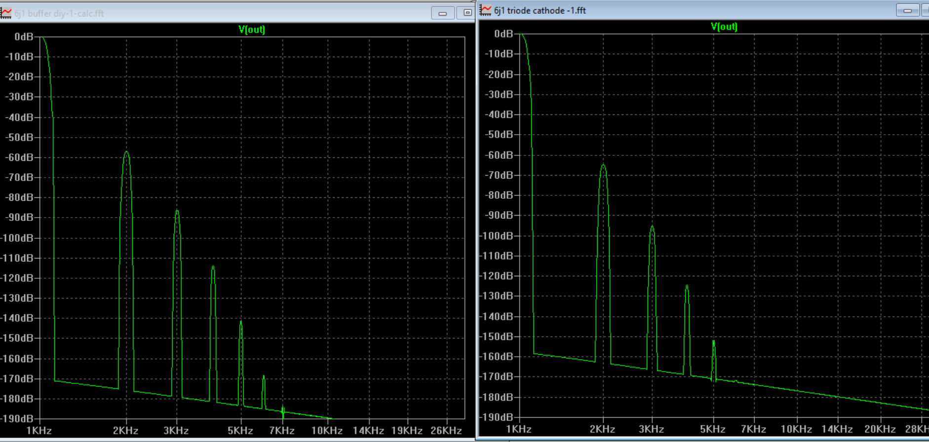

If you're looking for tube sound it should be harmonics rich with even and odd evenly tapered off (see TubeCad harmonic restoration articles), the distortions are purposely introduced as "overload" will create rich harmonics. I'm not sure if 6j1 fits into that, see for yourself. Maybe I'll plot other FFT designs for comparison.
Here are FFT plots with noise floor clean up. Left is anode, right is cathode.
.tran 0 {simtime} {dlytime} {timestep}
.options plotwinsize=0
.options method=gear
.options numdgt=7
.param numcyc=40
.param dlycyc=1
.param FFT=16
.param simtime=numcyc/Freq+dlytime
.param dlytime=dlycyc/Freq
.param timestep=(simtime-dlytime)/2**FFT
.param Sine=1
.param Vsine=.1
.param Freq=1k
.param Burst=1
.param Burstrate=2

Thank you, i have that one. From my understanding it uses two triodes per channel, something like 2N3 and is copy of musical fidelity x10-d..... yeah, i notice youve said that.
The ones im investigating have the same voltage muliplier, not sure how heater supply is done but both heaters are in series across presumably rectified 12 vac supply, but one triode (pentode actually) per channel.
