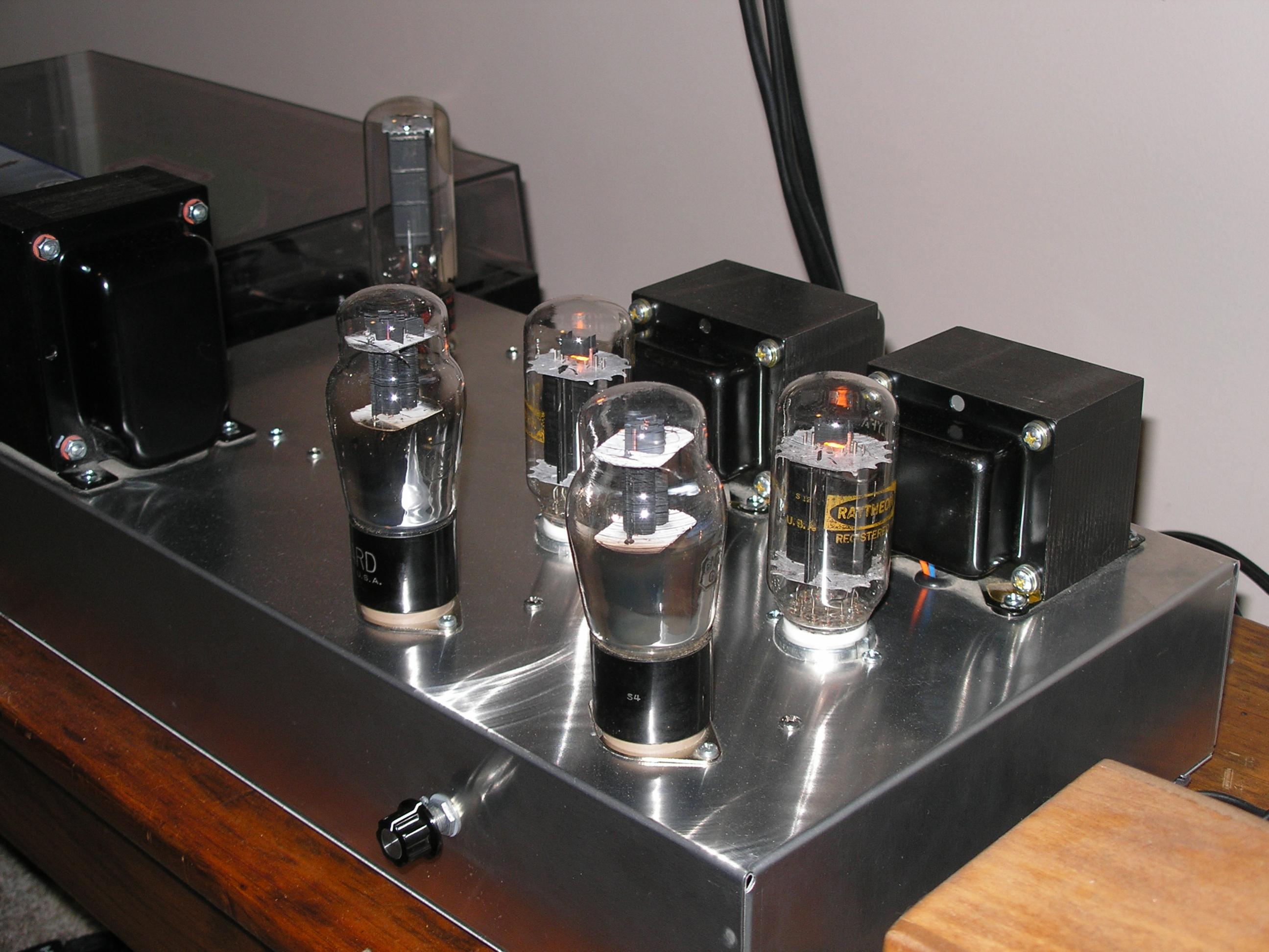

Besides pinout the 5670 should work just fine, you don't even need to change operating point and you only need one triode since the rp is about half that of both 6N7 triodes in parallel. That means one driver tube for both channels. In fact simulation shows that the THD is a C___ hair lower than with 6N7's. I chose the 6N7's because I like the looks of the 6N7 metal cans and the 6N7G. I need to post some pics with the 6N7G.

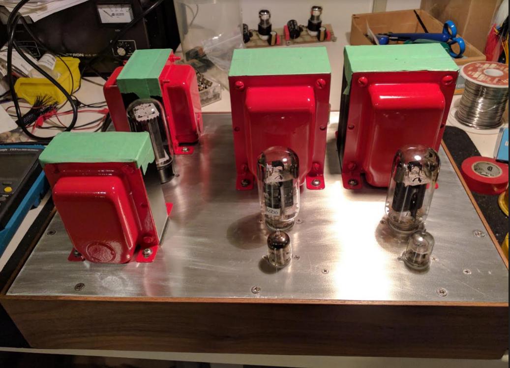

My late come 6hj5-5670
Bird,
Here comes my little amp and I still need some more time to finish it for enjoyment. As of the picture, you can find there are 2 5670s, one for each channel. I want to run the 5670 in parallel and see if it sounds better this way. This looks better to me too.
As of data sheet, I have to keep 150v @8.2mA per triode in class A. What if I run both triodes in parallel, Do I have to up the current to 16mA?

Hi Albertli, the amp is looking great!!
If you run both triodes in parallel the current will double so halve the anode and cathode resistor values. What are the current plate and cathode resistor values? I am guessing you are around -2v bias and possibly a 250 ohm cathode resistor?

As of spec., It's 240 ohm cathode resistor with 150v B+ for class A operation. I'd would try keep the 150v B+ and half the cathode resistor 120 ohm to begin with. Will tell you more after firing up.

If you have 240 ohm on each cathode you should be able to just tie them together effectively giving you 120. Do the same with the anodes and just tie them together, the anode load resistance will effectively halve as well. That's the easiest thing to do if things are already wired up. But if you want less clutter I would remove all values for cathodes and anodes and just tie the pins together and use the correct values which would be in half. Are you using a CCS on the anode? If so you will have to change the current set resistor in order to double your current, changing the cathode resistance will only adjust anode voltage. For the 10M45S you will want ~200R.

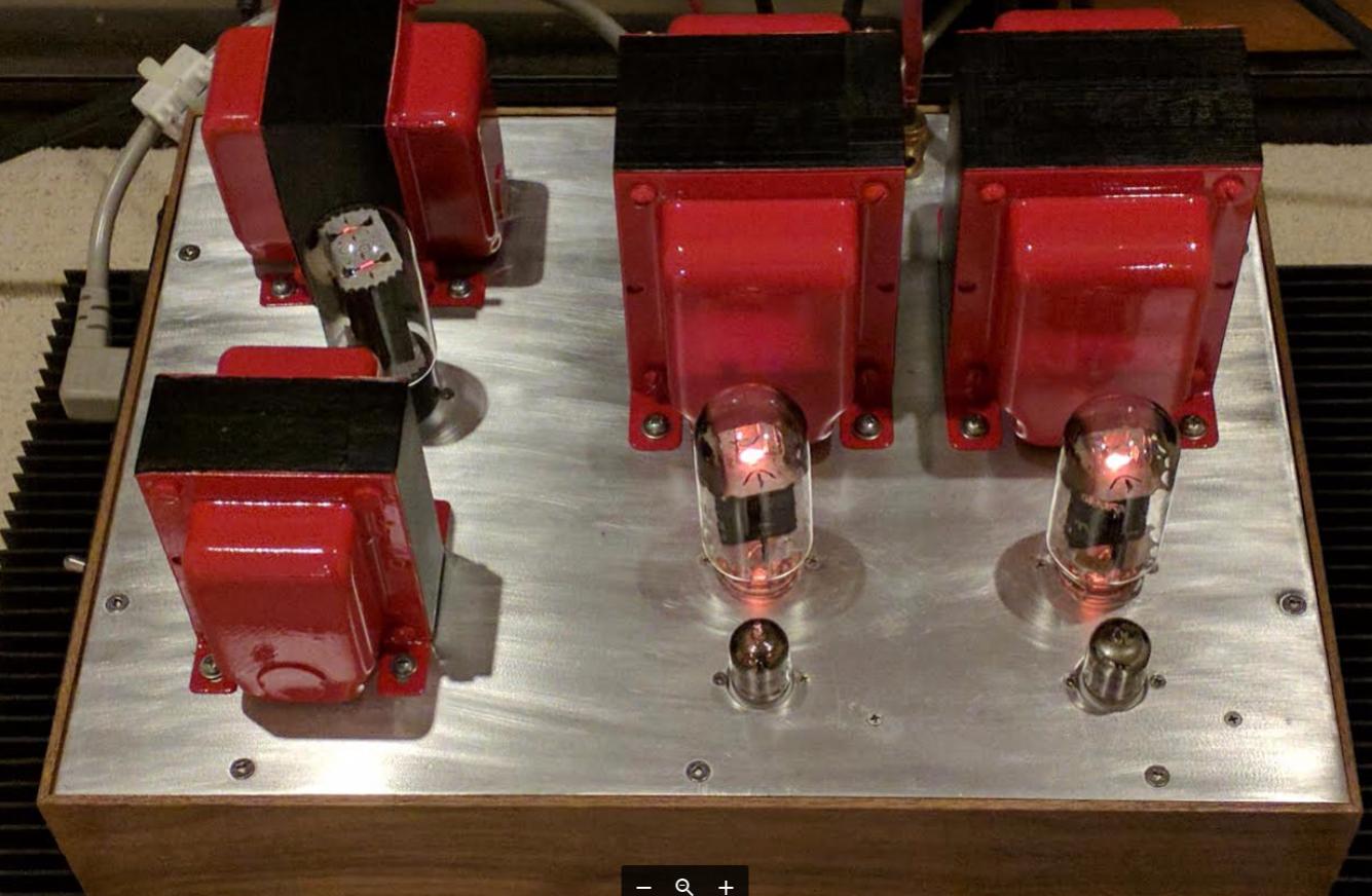

I have my amp fired up and everything is in the range. It runs at 300v with the cathode 48.8v and right on the target. The parallel 5670 with a 8.2k anode load and with an adjustable trimmer at cathode to run at around 17mA.
Sound is deep and very quiet background. Lots of low end but the high is a bit on the weak side. It might be the result of the OPT. I'll let it sing a bit longer to give my full impression.
Those are some really large OPT's!! Maybe they are limiting your high end. I would rather sacrifice top end for better low end myself.
